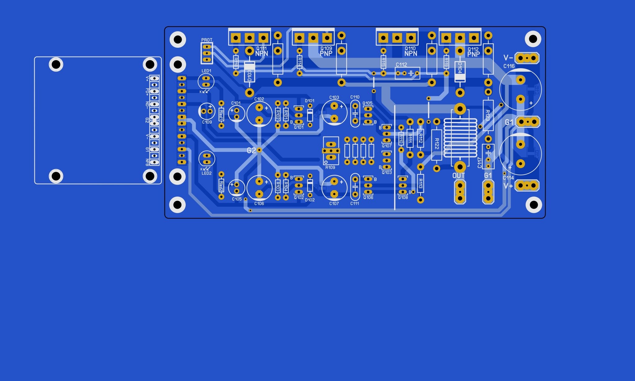

The front-end should fit into this space. I did a similar SMD design and it took up about 5x5 cm with most components on one side. If you put more components on the bottom, then it should be even easier. I tried to keep most components on the top for serviceability reasons.You may find fitting spooky on a 50mm x 50mm pcb challenging.
In part , this is why I decided to make the OPS (almost) all SMD. Some through-hole components are still superior to their SM equivalents..

It will be a tight fit, the problem with having too many components on the bottom side is you breakup the ground plane then having to resort to a four layer pcb, this is okay for a design that is a daughter board, on a single board you now have ground planes running into the high current area of the output stage and having to segregate the high current return paths from the input stage current return paths.The front-end should fit into this space. I did a similar SMD design and it took up about 5x5 cm with most components on one side. If you put more components on the bottom, then it should be even easier. I tried to keep most components on the top for serviceability reasons.
These are not criticisms of a particular pcb, but are decisions that form part of the engineering processes and design criteria.

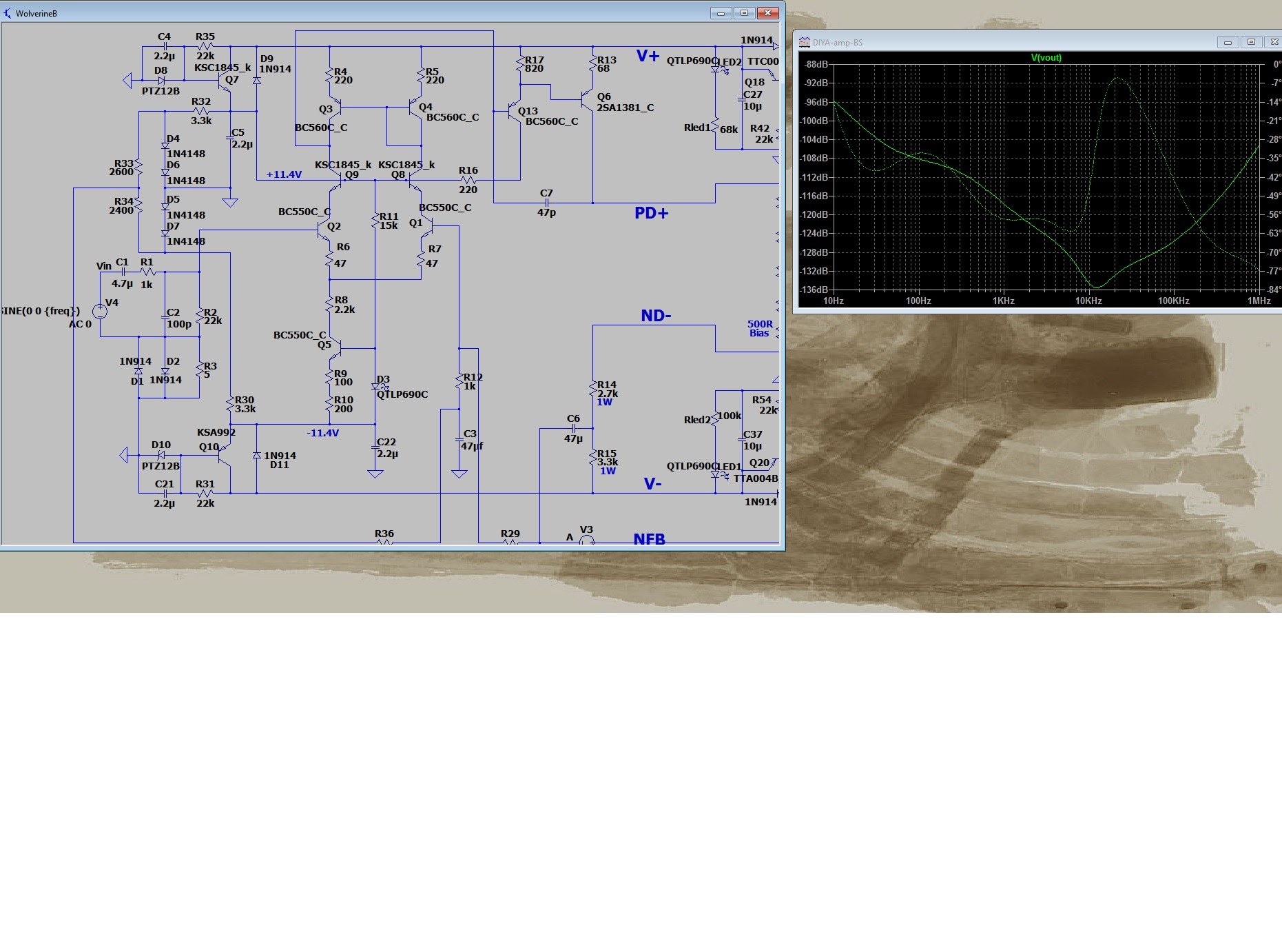

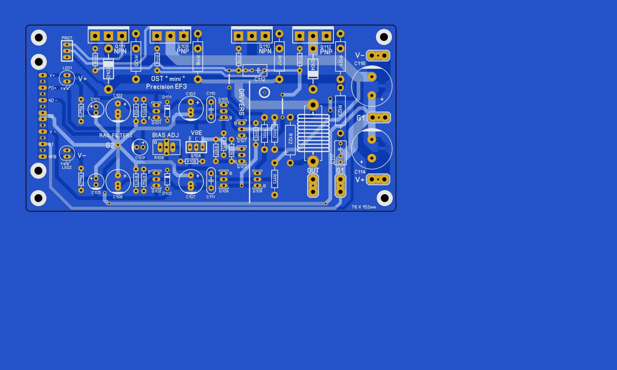

Finished the OPS. 1 pair 60W... both pairs 100W @ 53V rails (My trafo).
OPS is the "OST-mini" precision EF3.
Now for the 3 IPS's !!! (Spooky , Hellraiser CFA , and "blameless") .
2'nd pix is the blameless , a P3A on steroids. Crazy PSRR , no servo - simple 2PPM IPS.

Either on top or at a right angle (up and down). Should be able to fit in any EBAY E- waste amp case. I have 2 "for parts or not working" cases.How are you going to mount the input stage daughter PCB? Underneath?

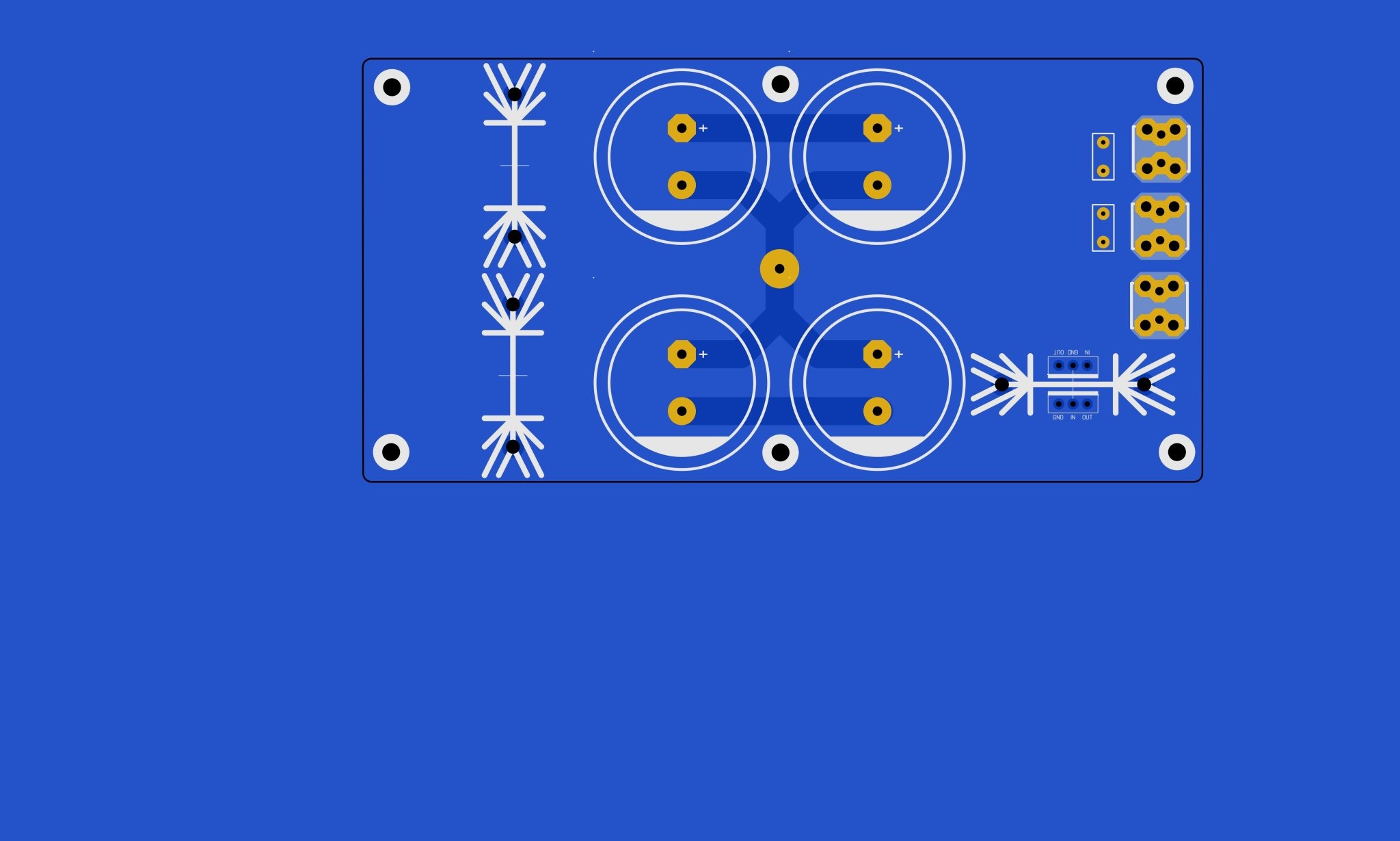

I'm also going to make a rectifier/filter cap board (also 75 X 150mm). Rails and +/- 24V series regulated for any accessories. Final regulation will be on the
accessory boards (lm78L12 , 79L12 , 78L05) ... just 25c each. Power board will also have the fuses.
OS
Regarding your OST_mini PCB layout. What about putting C114/116, V+/GND/V- terminals between the two sets of transistors? i.e. slide this section into the middle of the PCB, shove the other stuff left a bit to make room. This would shorten the high current tracks to the output stage and put the storage where it's needed the most.

Have you decided to go for output transistors in configuration N P N P and in one line after you've seen my PCB layout posted here, just curios?
Q104 goes out on leads , they are doing it on the wolverine even as I did design it under- board.Nice! How are you going to make the thermal connection between Q104 and the output transistors?
Being out on leads they still get sub ppm. Mount Q104 either on Q110 or on the HS between Q109/110.

I not sure who did what first ?I designed the Wolverine in 9/21 with P/N/P/N/P/N. I was not aware of your layout at that time. The SlewmasterHave you decided to go for output transistors in configuration N P N P and in one line after you've seen my PCB layout posted here, just curios?
was not like this and I measured hotter HS temps at the top ,,independently decided to do both alternating genders and rail cancellation in the
next design (Wolverine). I should search out all your threads to harvest the "secret sauce" from them - good work !!
I actually first saw P/N/P/N on a PASS amp Google photo first....

I just used the Wolverine type layout ... have you seen the THD/IMD/Noise figures ?? Why screw with perfection ?Regarding your OST_mini PCB layout. What about putting C114/116, V+/GND/V- terminals between the two sets of transistors? i.e. slide this section into the middle of the PCB, shove the other stuff left a bit to make room. This would shorten the high current tracks to the output stage and put the storage where it's needed the most.
.00002% 1k / .00008% 20khz -115db+ noise...
also , if you mount the boards horizontal , you still have to reach the screws on the outputs and Vbe - caps have to be out of the way.
Ripple filter caps can be 12mm tall 47uf @ 63V Nichicons. Using TTC/TTA004"s (170Hfe - tested on the wolverine thread) , you would have
6800uF+ equivalence per rail for the IPS supplies.

Finalized my SMD component choices -
Trannies =
-2SC3649/2SA1419 - SOT89 - for HV VAS duty on all IPS's - https://www.mouser.com/datasheet/2/308/1/EN2007_D-2311156.pdf -$0.80
-BC817/807 - SOT-23 - for all LTP's and diamond pairs. - https://www.mouser.com/datasheet/2/916/BC807_SER-1594290.pdf - $0.18
-2SC2713/2SA1163 - SOT-23 - medium voltage for regulators and cascodes. Replaces the 2sc1845/2sa992's - better gain/Cob ... Toshiba !! $0.34 https://www.mouser.com/datasheet/2/408/2SC2713_datasheet_en_20220308-771444.pdf
Output stage - standard TTC/A 004's for 1A , MJE15030/31 for 8A , and NJW0281/0302 @ 15A
MJE's don't seem to outdated and are pretty cheap ... $1.71
Led's have 1000's of choices - I need 1.7V to match that LT QTLP690 red model I use. My led's actually do something besides
shine ....
CCS's and the cascode need to match that 1.7Vf and have the opposite Tc of the BC817/807's.
At least SMD has so many (red) choices .... but nowhere as many as white led's - WOW !!
https://www.mouser.com/datasheet/2/109/smt_selector_guide-1163647.pdf
Have not decided on servo op-amp's yet. It's not in the audio path (some have debated that).
I only need one with low current demands , cheap standard ... does not even need to be Jfet.
TI OP07x - SOIC-8 - is cheap $1.15 - https://www.ti.com/lit/ds/symlink/o...454487&ref_url=https%3A%2F%2Feu.mouser.com%2F It draws <2mA per rail @ 12V. Good !
Just need to find a standardized package for single op-amps - there are 161 choices at Mouser !!
