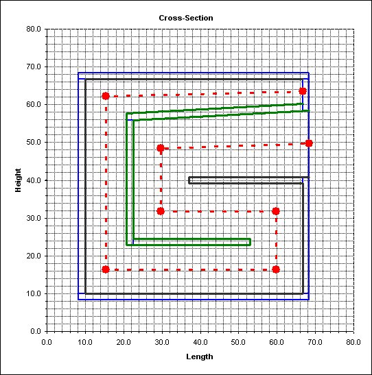

It looks like the best correlation between predicted and measured results occurs when the path length through the folds is somewhere between the centerline method (Lc) and the centerline/arc method (Lca).
I also found a small bug in the spreadsheet's calculation of L. I will deal with that shortly.
In the interim, I modified the graph to show the centerline of the path (dotted red line), the longest lenth (in black) and the shortest length (in green).
For the TH I built:
Centerline method gives 242.2 cm (dotted red line in the graph)
Centerline method with arcs gives 225.6 cm (not illustrated)
Sqrt method gives 241.4 cm (long length in black, short length in green)
Measurement of the build TH suggests that L is somewhere around 233 cm.
(The 0.7 method is going to give a value for L that's longer than the centerline method, which actual measurement suggests is too long, so I did not consider it in this exercise)
It looks like the geometric mean between the centerline method and the centerline/arc method gives the closest approximation to the measured results, so I'm going to redesign the spreadsheet either around this or the centerline/arc method (for a bass horn, I think perhaps it might be best to err on the side of the horn being slightly too long rather than the horn being slightly too short).

Brian Steele,
I have a preliminary AkAbak model set up. The first thing I noticed is that the HR model posted here is a bit different than the base numbers from the Excel sheet from there. I'll look into it more later.
This is just a starter model with the extra mass and resistance of the bends not included, the path length has just been approximated. The next step would be to remove the corner sections and replace them with Acoumass/resistance components to take the edges off the peaks and displacement.
Here is a pic of the AkAbak model on the left, and the original HR sim on the right.

Brian Steele,
Good stuff. The Akabak impedance plot is a closer match to what I've actually measured. The resonance frequency is almost an exact match.

Is the centerline version available for download?
Version 1.2.0 attached.
1. Plot options added for driver (top-mount and bottom-mount), centerline, advanced centerline, minimum length, maximum length.
2. Goal-seeking for effective length is now included (default is advanced center line, but the other options are also provided). This unfortunately complicates the operation of the spreadsheet a bit - I'm going to check to see if it can be simplified.
3. I've cleaned up the format of the spreadsheet a bit.
Forgive my manners - I forgot to thank "Soho54" for the "advanced-centerline" idea to determine the effective length of the horn. After reviewing each of the different methods yet again, that method seems to produce the closest match to the results that I obtained with POC #2.
I forgot to mention that I also fixed two minor bugs with the calculations for the panel dimensions. One bug made the driver's baffle slightly too long, and the other made the internal panel on the other side of the mouth slightly too long as well. These are corrected in v1.2.0

Eek - how did you end up with 198.72 cm^2 for S1? My target for S1 was 270 cm^2
Hey thank you, for taking the time to putting this spreadsheet together.
I'm glad you caught the two odd panel lengths. They were the reason I asked for you to verify my model was what you built. 😉
I didn't think the panel length errors would cause to much issues. Panel F was about 1~2mm too long and Panel I was about 5mm too long. There are some approximations involved with Panel F's position, so it's best to lay out the rest of the horn, then use Panel F to join Panel G to Panel A.
I've attached v1.3.0 of the spreadsheet - this version allows the user to highlight specific panels in the graph. I've indicated in the plot which panels were incorrectly sized.
