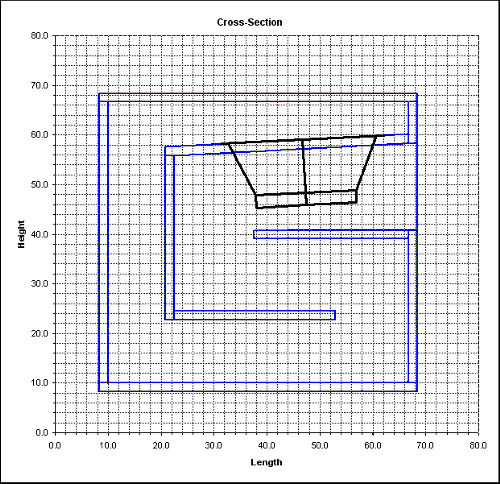

- Maybe put some short descriptions of the dimensions to their right (the current names are a bit... interpretable. I mean, to me, it sounds like "mounting width" would be the driver mounting hole diameter, and the "frame width" would be the outside diameter of the frame. On the sketch, i can only get a speaker-looking thing if the "mounting width" is about twice the numerical size of the "frame width")
- Maybe include an "operating manual" on a second sheet within the .xls, for greater ease-of-access :magnify:
That's correct.
Yup, a bug. Looks like I was using frame radius instead of frame diameter in my plot calculations for the driver. I've fixed this in the attached spreadsheet.

Hmmm... I think some numbers are still slightly fudged in the driver sizes section...
Using the dimensions from this driver, i'm getting some "unnatural" driver shapes in the sketch 😱
Yeah, it looks like I fixed the wrong dimension. Ok, fixed the right one this time. See attached (v 1.3.2)

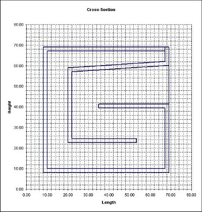

The problem was two fold. The over sized panels which I didn't notice until I tried to get the last one (the baffle board) to line up correctly. When it didn't I just went off of the graph you posted on your web page.
In it there is only ~4.8cm at the throat.
Yeah, something's not quite right with that graph. I've corrected it, thanks. The dimension at the throat should be 6.5 cm, not 4.8 cm. It looks like that version of the spreadsheet shifted the internal panels 1.7 cm (or one panel thickness) too high in the graph. The TH as built measures 6.5 cm at that point. The attached image is a closer match to what was actually built.
I made a few other errors with that build though that I'm not happy about, so I'm going to redo it next week. POC #2 part deux 🙂

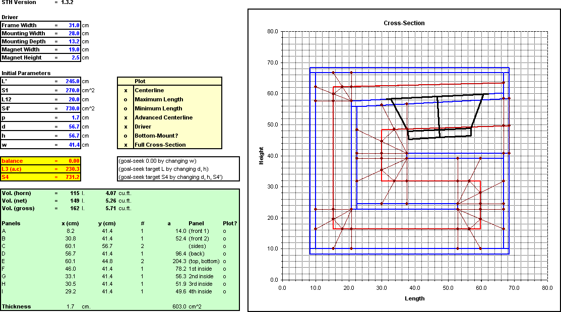

I've attached an example of what the spreadsheet looks like with the parameters for my POC #2 (with the correct dimensions for panels E and I). "L3" shows the predicted length of the horn, which is a very good match for my measurements. Some fudging aroudn with d and h suggests that I'll have to increase them to just over 60 cm to get the effective path length to the target of 245 cm. I might try that for my next POC 🙂

Version 1.4.0:
1. No longer restricted to square cross-sections (fixed that bug!).
2. Various bugs fixed with panel length calculations (internal panels).
3. Optimization now centered around initial horn expansion, target Length (L) and target mouth area (S4). Plot of cross-section will now go red if negative expansion is detected in the folding.
4. New graph showing horn expansion in the suggested folding.

This is how I found works for me after a bit of fiddling.
Set w to the desired depth of the horn (seen from the blueprint)
Goalseek Dcheck to 0 by changing Delta
Goalseek L(a,c) to desired length by d
Goalseek S4 to desired s4 by h
Repeat until it matches fairly well.

w actually represents the width of the horn, but the goal-seeking should work (within limits) with any of the three dimensions: d, w and h.

Version 1.5.0:
1. More bugs fixed with internal panel length calculations (sigh).
2. Added the ability to plot (highlight) the different sections of the horn
3. Added the ability to vary the flare rate throughout the horn (based on ratios to the initial rate).
