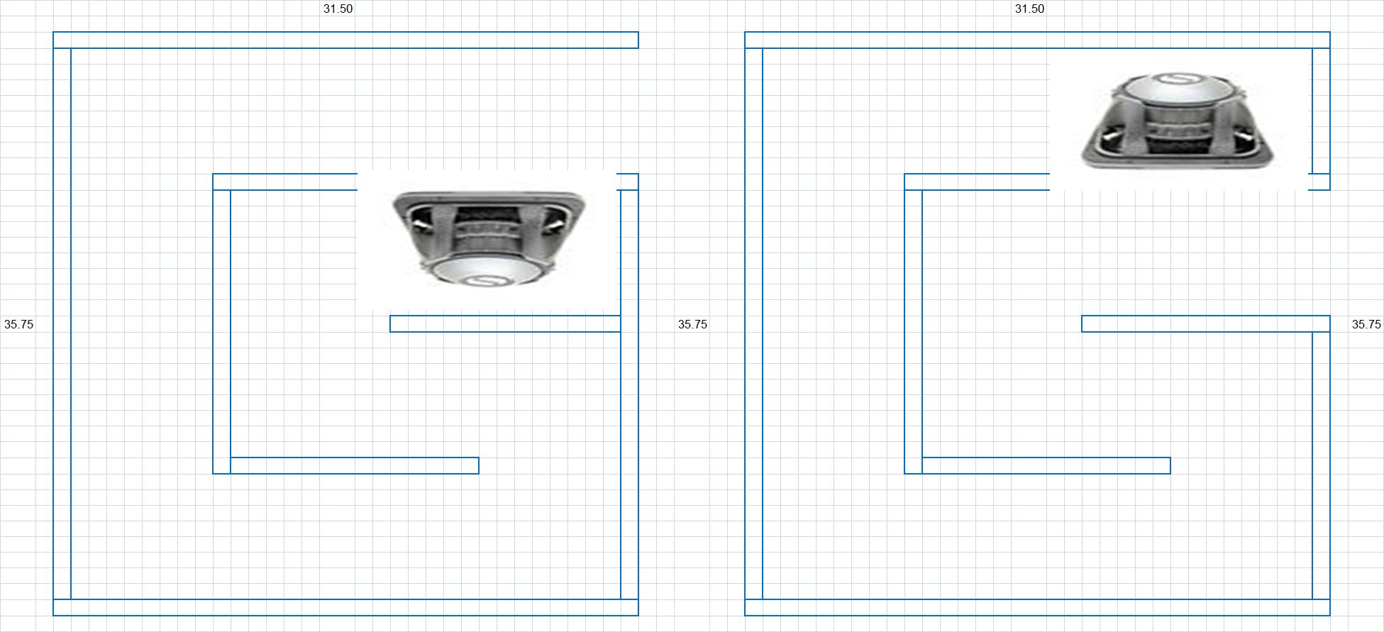

Well, presenting a new spreadsheet - BOXPLAN-THAM. This spreadsheet allows you to optimize the layout a "THAM" style TH before cutting any wood. The spreadsheet gives you all the panel dimensions required. Basically you enter the parameters for the desired TH, then adjust the panel sizes until predicted result (in blue) is a close match for the "guide" curve.
Spreadsheet for "SS15" type folds
I've attached a spreadsheet that I've put together to assist with designing the layout of THs using a folding technique that's similar to the "SS15" TH design. I used this spreadsheet to design and build a new TH that fits a bit better in my car's trunk and addressed any bugs I came across along the way, so it's pretty much bug-free at this point.
To use:
1. Enter the dimensions of the subwoofer driver in the "Driver Dimensions" table
2. Enter your preferred box dimensions in the "Box Dimensions" table. If you are countersinking the driver (which I strongly suggest for this type of build), use the "driver offset" box to enter how deep the driver is going to be embedded into the baffle. If you're going to mount it on top of the baffle, enter "0" for the driver offset.
3. The spreadsheet models a dual-expansion TH like the SS15. If you want the change in expansion to occur a bit earlier in the horn, enter "x" for the "S3 at 3rd fold" option.
4. Under the "HornResp" params section, enter starting values for S1, S5 and L12.
Now, under the "Horn Design" section, enter the thickness of each panel under the "P" column, then start fiddling around with the horn expansion options and the panel lengths (basically all of the options in blue text). Keep your eye on the "Horn Expansion" graph. Basically your goal is to end up with a horn expansion that is as smooth as possible. The spreadsheet will automatically calculate the parameters that you'll need to enter into HornResp to simulate your TH design. If you don't like the results, adjust the TH layout accordingly, following the process above.
As the process is an iterative one, it may take awhile to come up with something acceptable.

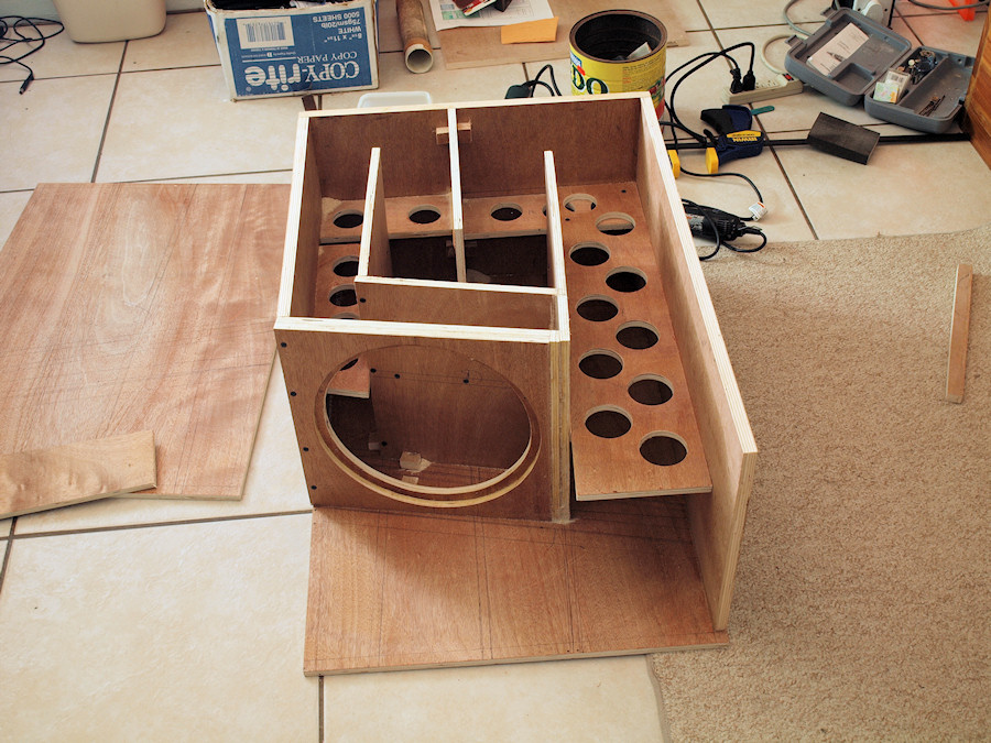

Ok, I'll admit that I cheated a bit, so I still remain a bit skeptical, LOL. Only the side and internal panels for this build were done with 0.5" ply. I used 0.75" ply for the top, back and bottom panels (where I believed I'd have the most problems with panel flex), and the baffle is actually made up of two sheets of 0.5" ply bonded together. And this box is just 133 liters net, so it's not large as far as pro audio subwoofer boxes go.
I still can't imagine using just 0.5" ply alone to construct subwoofer boxes any bigger than this, especially for larger and/or more capable drivers than the Dayton PA310. And I'm still waiting for anyone who's done so to post an impedance curve for their build - that will quickly tell me whether or not panel flex is an issue
However, even though butt-joining definitely takes a lot longer with 0.5" ply because of the additional steps that need to be taken to avoid splitting the ply and basically just keeping the panels straight during assembly, the end result is a lighter and smaller box.

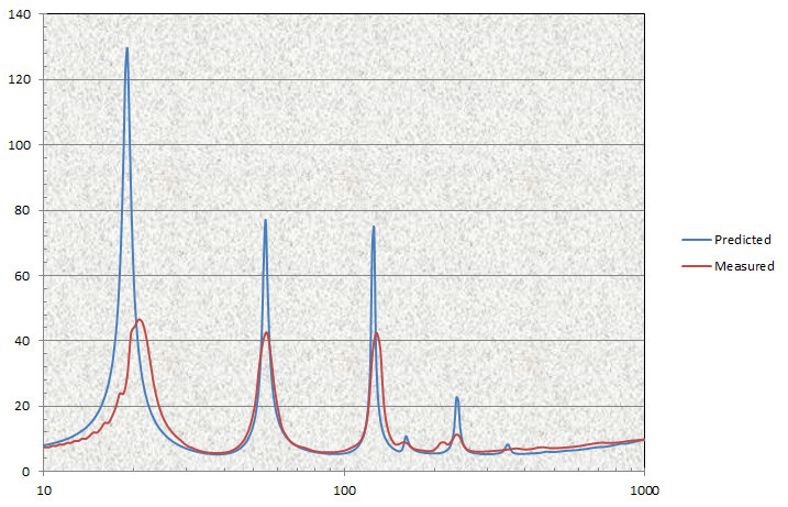

The removable panel on my POC #1 TH is 17mm ply. It's 45cm by 60cm and fastened to the box by about 20 screws around its perimeter. Unbraced, it flexed so badly that the expected upper peak in the impedance curve was almost eliminated. It took a wood center brace, two 3mm thick metal braces and another layer of 17mm ply bonded to its top to reduce the flexing to an acceptable amount, and even now it will vibrate off any item placed on top of it when I'm playing the TH at very loud volumes.

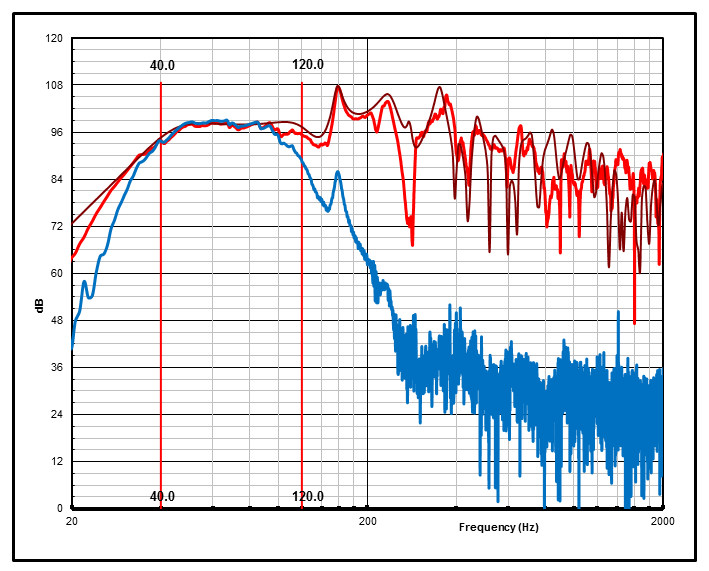

Some more pictures of the TH that I built using the spreadsheet.
The first picture shows a quick and dirty FR I took this afternoon. Red=measured response, brown=predicted response, blue=response with 30Hz 48db/oct and 120 Hz 48dB/oct filters applied.

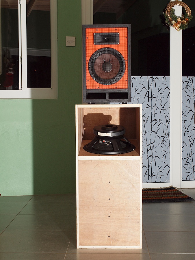

The second shows its size when compared to one of my "Blastorama" tops.

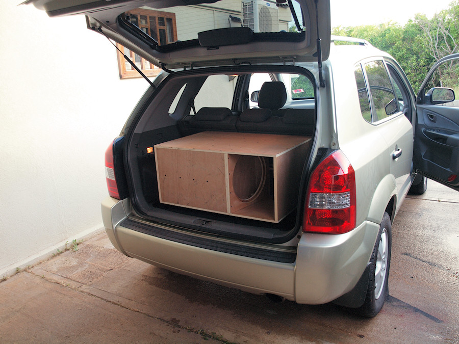

How does it sound in the ride????
Hah, it wasn't designed to be used while *in* the ride, LOL. Once the car's rear door is closed, the mouth is effectively blocked, and if it's turned around, the port will be partially blocked by the rear seats.
I suppose I could fold one seat down and try it out - given the measured frequency response, and my experience with running the previous TH in the same car, I expect that it will sound like a very efficient 38 Hz vented box.
