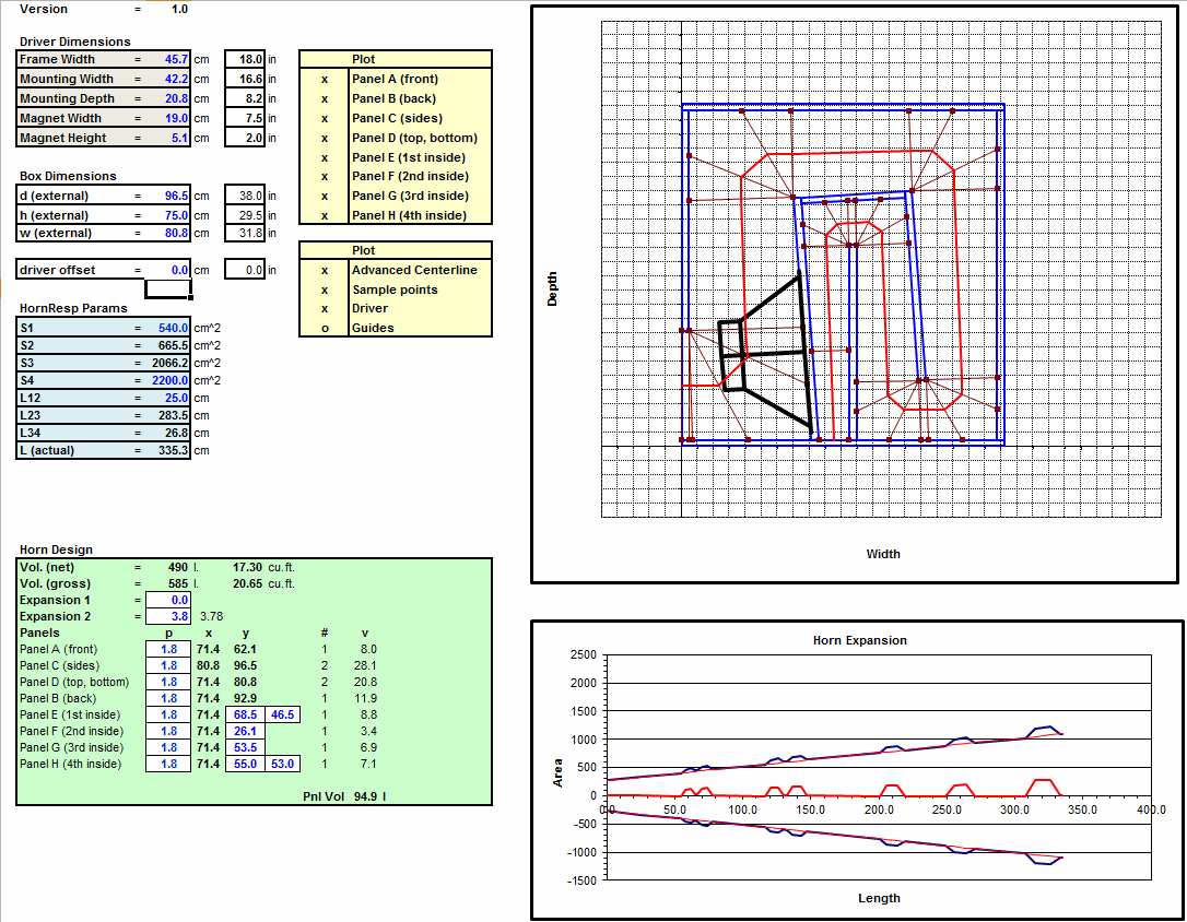

...and here we go, v1.0.
Expect a few bugs of course

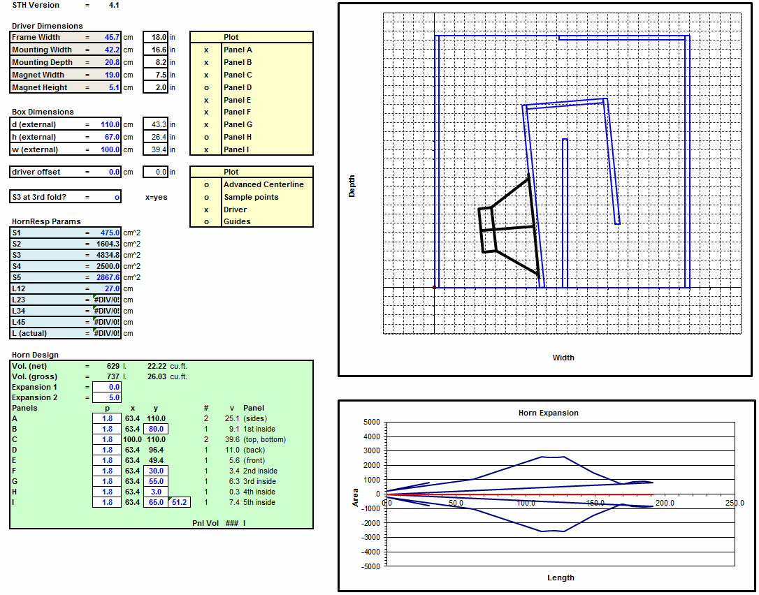

This one assumes constant expansion throughout. I'm going to redo it to reflect a dual expansion with the second occurring on the last bend before the mouth, which should allow simming of different mouth sizes.
I've run into a problem trying to programmatically determine L34 (or soon to be L45). For the moment I've set it to L12 + panel thickness (like if the horn's mouth is at the bottom rather than the front. This means that it might be off a few inches compared to the sim.

Does this mean the mouth shown on the left side is not what is calculated?...and here we go, v1.0............ For the moment I've set it to L12 + panel thickness (like if the horn's mouth is at the bottom rather than the front. ...............
Is the mouth actually in the bottom face?
Nope, the mouth is to the side. The estimated HornResp parameters would be a lot more accurate if the mouth was at the bottom though. Maybe I should do a version that reflects that
With the mouth on the side, not only is there an issue with accurately estimating L34 (or L34 and L45 in the new version attached), I think that there is a large amount of error introduced in trying to estimate the effective mouth size too. This is all a by-product of trying to put together a sim that has a large bend right at the mouth. The big bump in the "horn expansion graph" right at the end is a visual indicator of what's going on.
In summary I'd trust the estimated HornResp parameters up to S3 in the new version attached. The rest may need to be worked out by trial and error, unless someone has a better way of estimating the path length and cross-sectional area through the section in question.
Note: this new version treats the horn as dual expansion, to allow for different mouth sizes for the same fold. It does mean however that the driver's center cannot be moved up higher than the top edge of the mouth, which is considered to be the location of S3. This does introduce some limitations to the driver's location in the horn, but nothing to serious I think.
My suggestion would be that if anyone's planning to build something based on a model from this spreadsheet, make the front panel removable, and use FR and impedance measurements to determine the best mouth size, shape and location. And it seems that at least one person is thinking of doing that already
