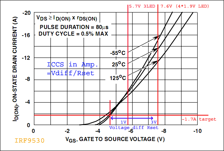

You need to be careful with your dissipation on the CCS MOSFET IRF9530 when handling 1.7A. The power dissipated on it is going to be its voltage across, which is VDCin-VDCout, times 1.7A. Use 3 LEDs and some available value around the 0.6R 5W mark for Rset. Use 1C/W sink or better. Verify your real current by measuring voltage across Rset and dividing by its value. There are tolerances beyond the indicative chart.
~7V VDCin-VDCout is a conservative value between enough RegDrop voltage and non needed dissipation. Use just 1 red LED & 2K trimmer, in "see text" area.
