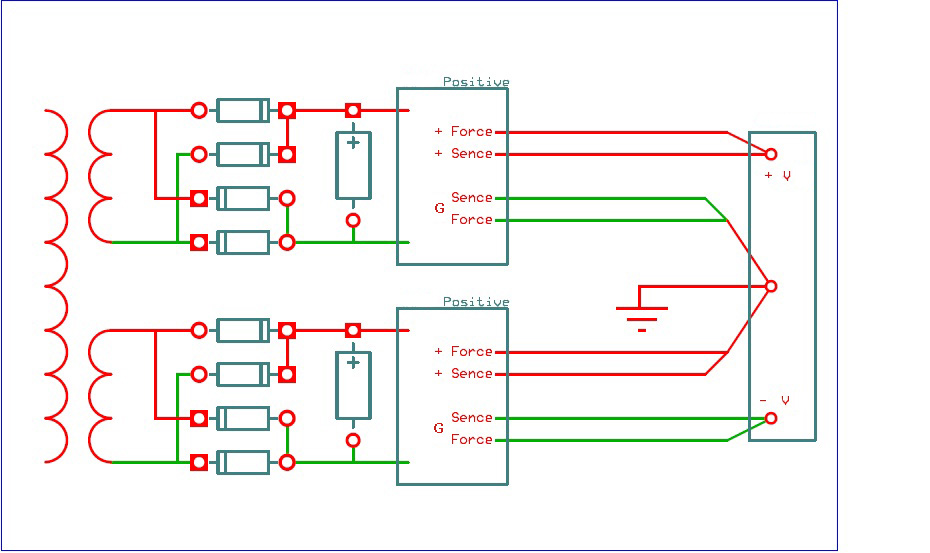

I tried varying the gate stoppers but still have oscillations and varying voltage. Is there any problem using 2 positive regulators provided I used separate transformers, diodes, and caps with the only connection being at the load?
I have changed most of the components on the negative regulator but still have the same problem and just cannot seem to get it to work at high shunt current draws.

No there is no problem using 2 positives, see the pic, but there should be no such persistent problem in a negative too. Has been used a lot in +/- configurations by now. Don't know how much they pushed spare current though. So it makes me wonder. What make are the IRF610s?

I have 3 other salas shunt supplies built and all are working fine in a +/- configuration.
They are all dumping around 100mA through the shunt.
All my mosfets are International Rectifier brand.
The diagram shown is how I plan to configure the supply except I have separate transformers for each regulator.
Thanks.
Bill
