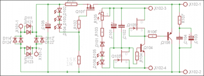

No, the Q102 Jfet for the 3-4 leds won't take it. It would need to botch a resistor in its place. 15k 1W from R102 & leds node to ground.
Salas
Vref setting string on above schematic Is consisted from 3 various types components
I have read that best Is to use only leds If possible because of low impedance
second best low noise reference element
third place - include resistance
could you please confirm
