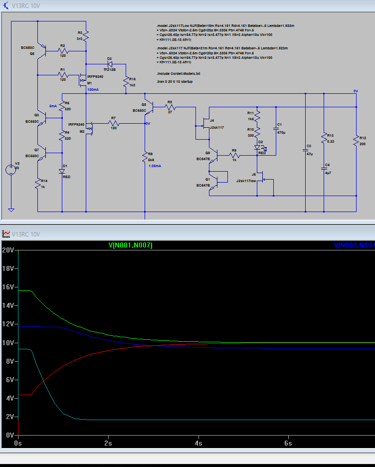

Thank you Andrew.

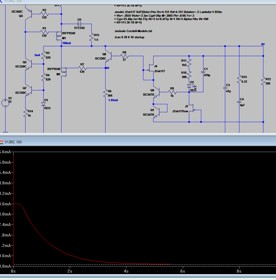

I can not disassemble the shunt but will do some sims and report back...
Joined 2006
one good combination......
zener 12v
R16 = 1k2
This enables a healthy 2.5mA startup current on the zener that goes to zero after 1.5sec for Vin =20 Vout=10
