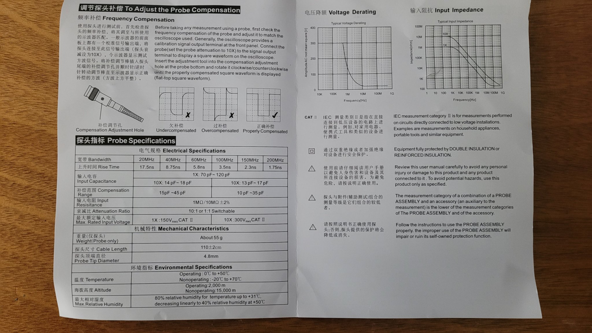

What is the capacitance of the scope probes? Are they causing phase shift as some high impedance part of the circuit.

Here's the specs for the probes.
My deduction would be that since one channel is working and one is not that it wouldn't be an issue with the probes since it should cause the same issue on both channels?

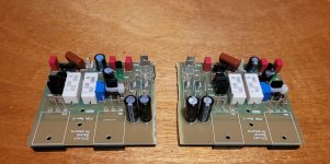

Are the layouts, wiring, etc., exactly identical for both channels? Grounding the same? Can you hi-res post pics so we can get an idea?

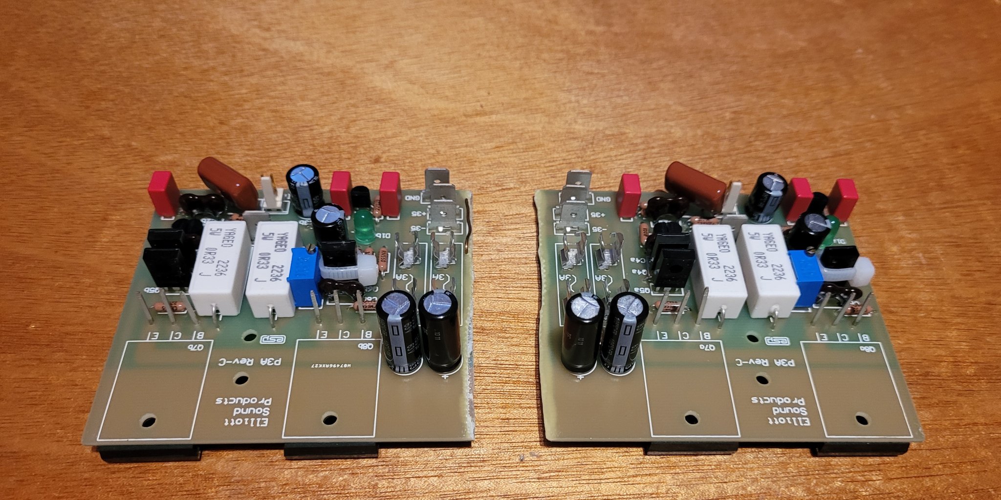

The layout of the 2 boards is slightly different in the routing of the power rails. Otherwise Identical.
The wiring from the psu to the faulty left channel is slightly longer in this test bed than the right side.
I could show a photo of the pcb traces but this would go against the request of Rod not to disclose his IP so I will avoid it if I can.
The difference is that one channel has the power rail traces running left to right, the other channel power rail traces right to left.
I have chosen to cut the two boards in half (which is provided for in the design) so that I can mount them on separate heatsinks when I get it out of my test rig and into the chassis proper.

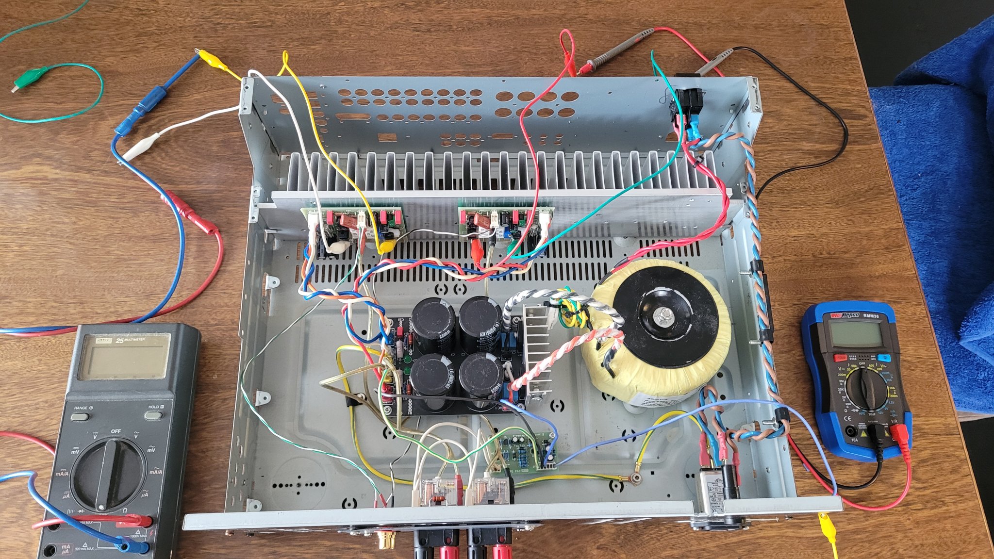

Is there a schematic for the power supply, and the other little board? Is there an overall interconnection wiring diagram that includes where all grounds are physically connected? Also, in the picture, can you confirm which is electrically the left and right channel?
In addition, it looks like there is some randomly routed I/O wiring. Just poking some of that stuff around might show some symptoms. Hard to say exactly from looking at the pic.
