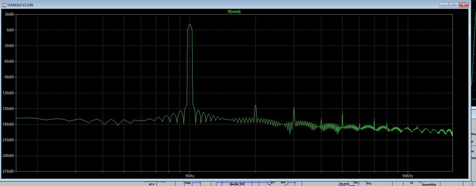

That would depend on the preceding signal stages however as simulated the output is linear for more
- see https://www.onsemi.com/pdf/datasheet/mjl21193-d.pdf graphs for various including THD for pairs.
There should be less IMD which is important for good sound clarity. I could simulate these if I can find the time. I'm happy to make room for others to take on that task??

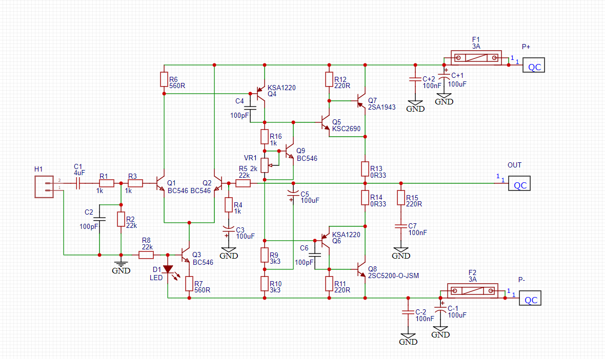

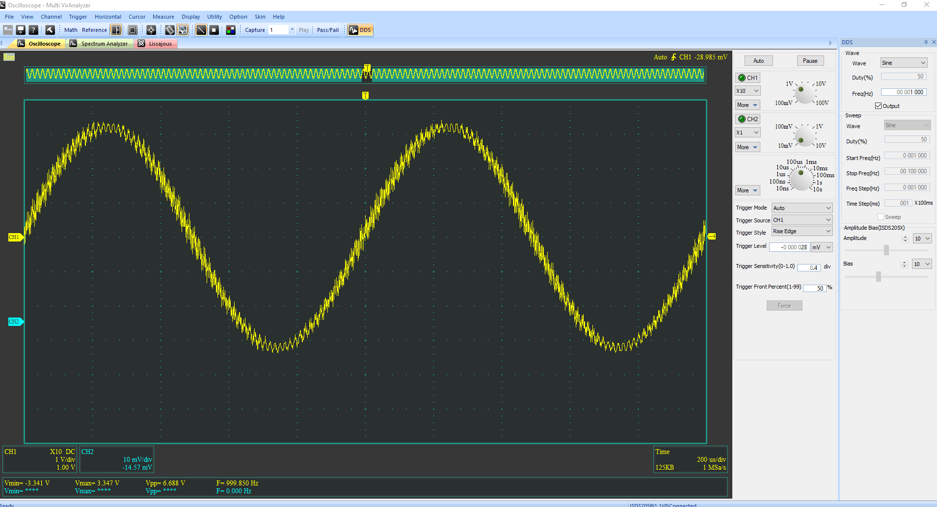

I've built a P3A using Rod's boards, standard parts etc.
https://sound-au.com/project3a.htm
+/- 34Vdc rails
2SA1973/2SC5200 output transistors
KSA1220/KSC2690 drivers and Q4
BC546 Q1,2,3 and Q9.
The right channel is behaving normally.
The left channel isn't.
My dummy load is 4x 16R 100w resistors in parallel for 4.3R as per my DMM.
My scope is a Instrustar ISDS205B cheap and nasty USB jobbie.

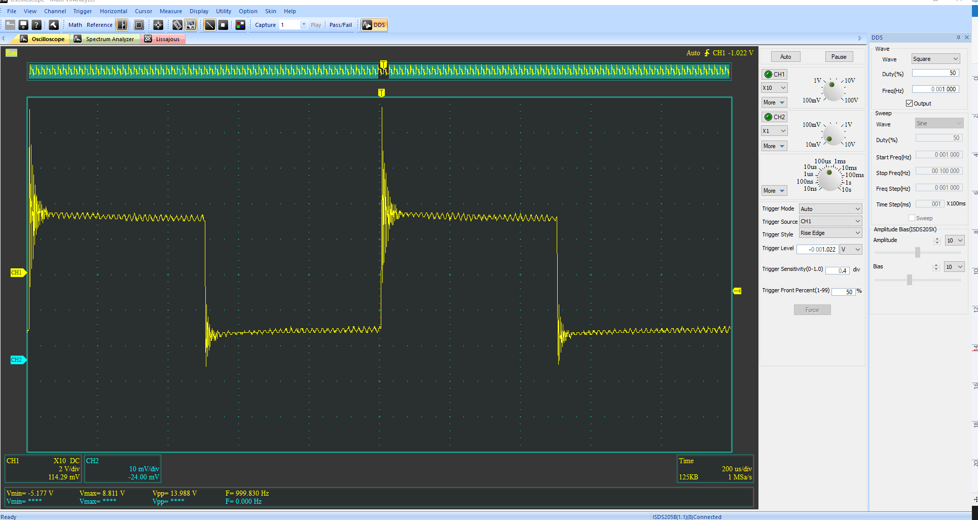

My first test on the problematic left channel had 3Vrms on the output of the amp. After something like 30-60s the 3A fuses on the supply rails blew.
And the heatsink was pretty darn warm.
The 2nd test was going ok, same signal, same 3Vrms on the ouput, the supply rail fuses didnt blow. After probably 60s I saw a little puff of smoke come from somewhere around Q6/Q9. I didn't see any damage, I think it was the cable tie coupling q6 and q9 together beginning to melt.
After this I learned that I can only do short bursts of testing if I dont want to start replacing transistors.
I performed a few more short tests and took some screen shots to digest whats going on.
Right side 1kHz sine wave
Left side 1kHz sine wave.

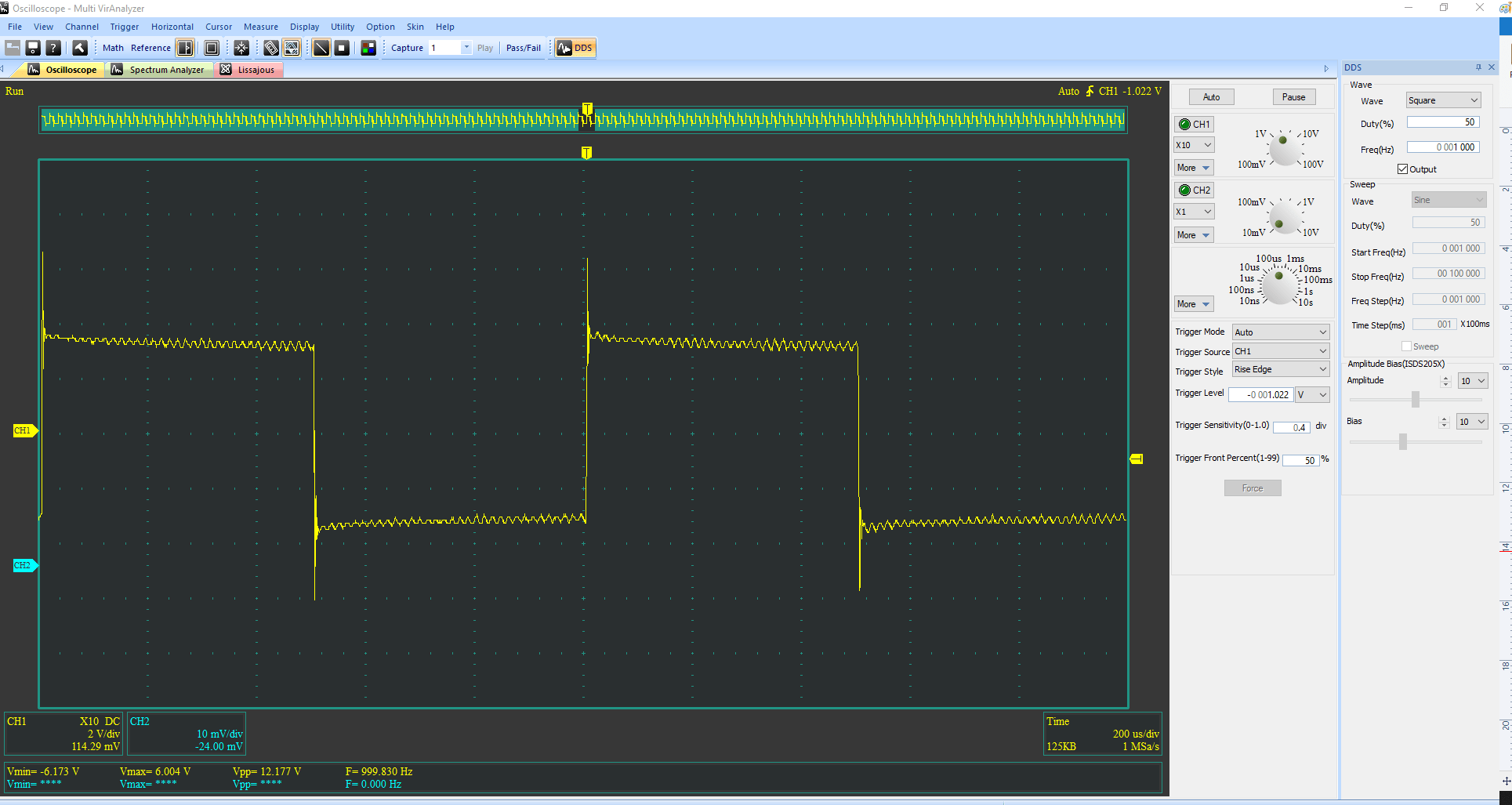

Right side 1kHz square wave.
Left side 1kHz square wave.
There was also another square wave test on the left side that I did not get a screen shot of, that looked like this.

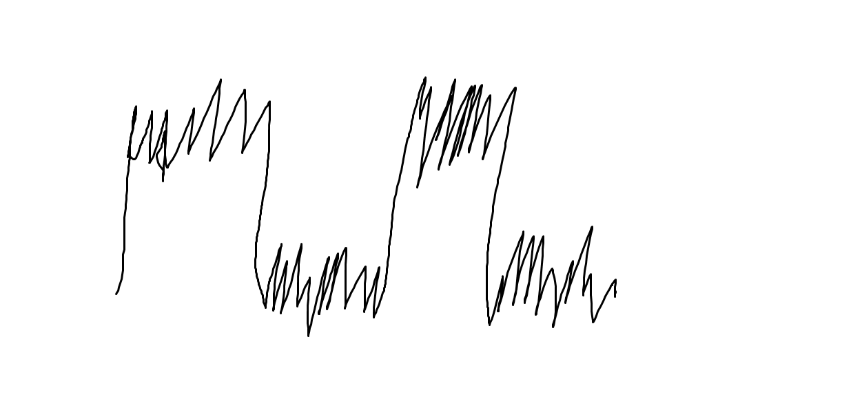

Forgive my crude MS Paint work. With my limited understanding this would be full scale oscillation.
This was a purely resistive 4R load, no capacitance in parallel.
So if I am not imagining things, I have a rather unstable amplifier that needs some love to get happy.
My first step is going to be to remove the board from the heatsink and give it a damn thorough eyeball to check for any mistakes, bad joints etc.
Assuming I don't find any construction errors, it seems to me that the next step would be to perform the same square wave test and do some probing around to see if I can find where the oscillation starts.

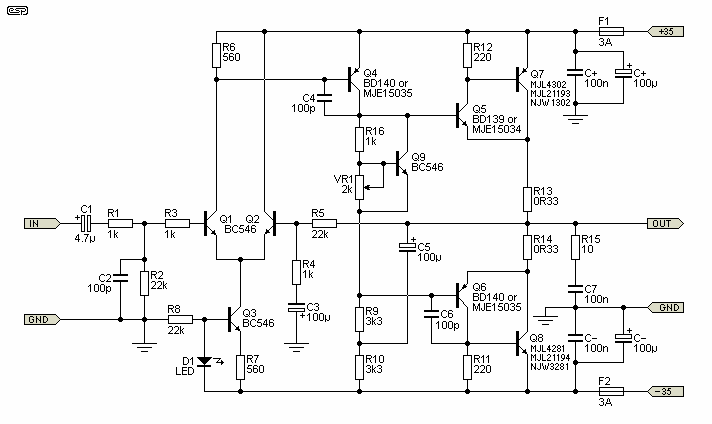

G'day Guys,

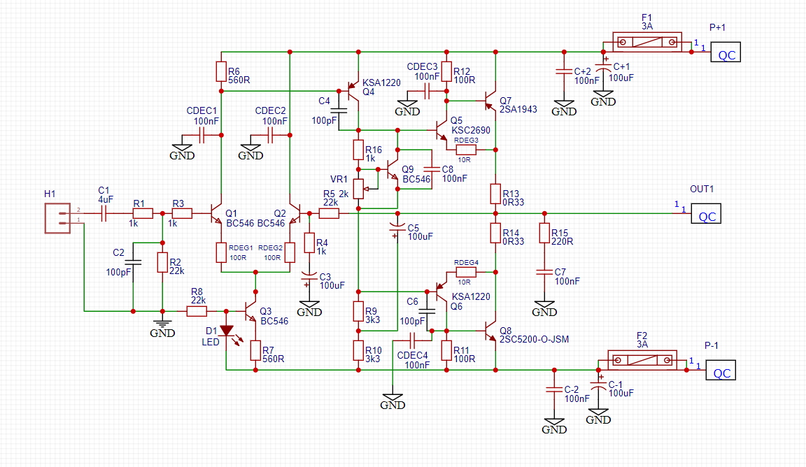

I have collated all of the suggestions so far and come up with this:
Original
Modified.
C8 added across Q9
R11/R12 decreased to 100R
Rdeg1/Rdeg2 added to Q1/Q2
Rdeg3/Rdeg4 added to Q5/Q6
Some other suggestions were:
Decreasing R13/R14 to 0.22R or 0.1R
R11/R12 to 150R
R9/R10 decreased to 2.7K
R7 increase to 820R
Decoupling for Q7/Q8
Decoupling for Q1/Q2
Changing Q4 to BF469
Resistor changes aren't difficult.
I'm not certain that DC offset was an issue. I didn't write down my measurements but I recall something like 5mV on the good channel and 15mV on the bad channel during my initial tests.
I don't think I measured again after biasing.
Extra decoupling wouldn't be too difficult to do:
If I have the idea right here.
At this point I will do some experiments with the good channel and implement whatever is necessary on a new board.

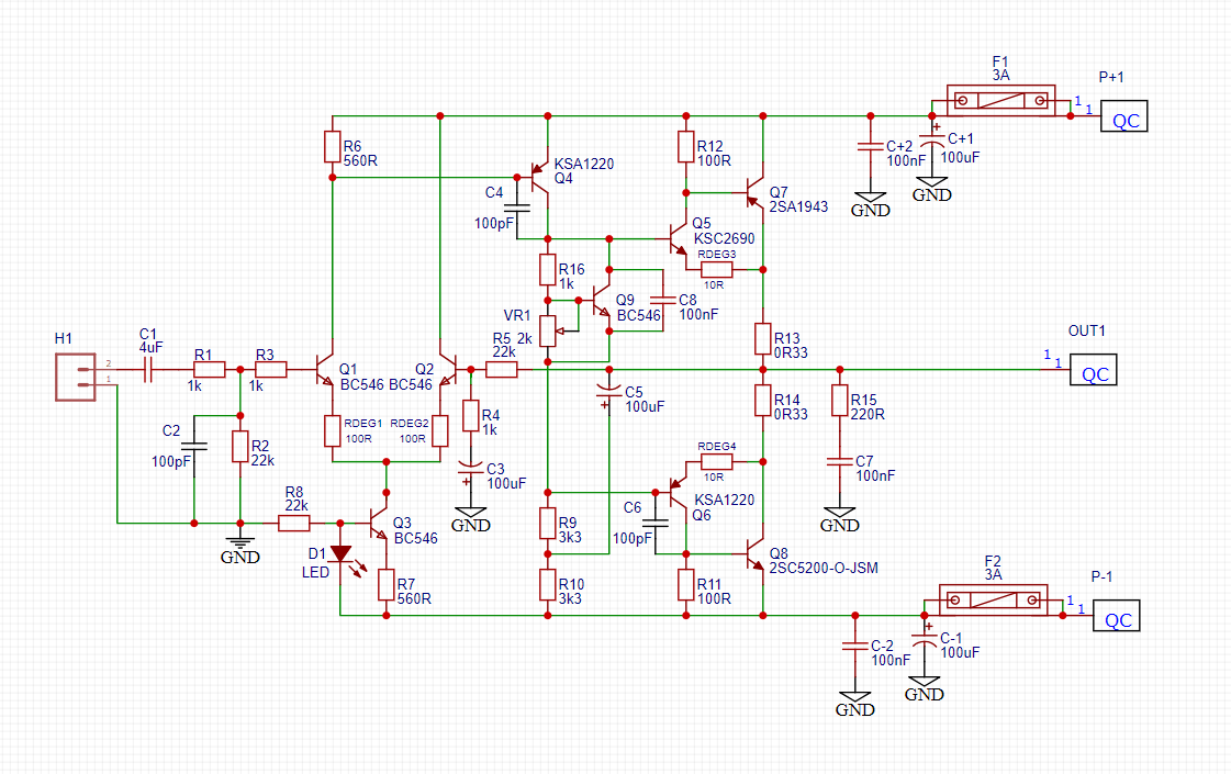

![schematic v2.1.png schematic v2.1.png](https://www.diyaudio.com/community/data/attachments/1125/1125444-b6f76ee76874dcfcbb770daeaefbaefb.jpg)
Q7 has emitter to output; should be to positive rail.
If you use CFP in Class AB you may have difficulty ensuring stability and setting accurate bias.
2EF is not so sexy but they are very stable and can be trimmed for very good sound. The CFP is a very elegant engineering topology which attracts many DIYers but rarely works with repeatable stability.
You could increase the stage current from 2.3mA to maybe 3.4mA with R7 390R rather than 560R and decrease the LTP degen from 100R to 33R each.
Then, in the last, add an emitter follower between the LTP and the VAS, running at maybe 2mA. This increases a lot of transconductance on the LTP and adds more loop gain. Then lag comp can straddle base of emitter follower to base of VAS - two devices, and normally reduces the cap to about 33pF.
Some fiddling with driver base stoppers and output stoppers can give better sound quality. And I'd drop the CDECs on the legs of the LTP. Finesse the lag comp to achieve stability; loading down the LTP is a bad idea.

Hi Sadface, Be carefull where you place your Cdec's. Only place them on the supply voltages. Not on the other end of resistors. Drawing mistake?
Good decoupling can be crucial for stability. I build a cfp amp that required much less hf compensation combined with a superlow impedance powersupply.
