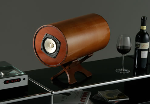

another stereolitic concept, this time from Japan:
M's System
surely it looks cheap and primitive and it is impossible to judge the quality by youtube clips but it clearly creates a kind of big soundstage and provokes some enthusiastic reactions, for instance the description below this clip:
YouTube - ??????????
says:
"This space and this sound… it is splendid"
M's System
says:
