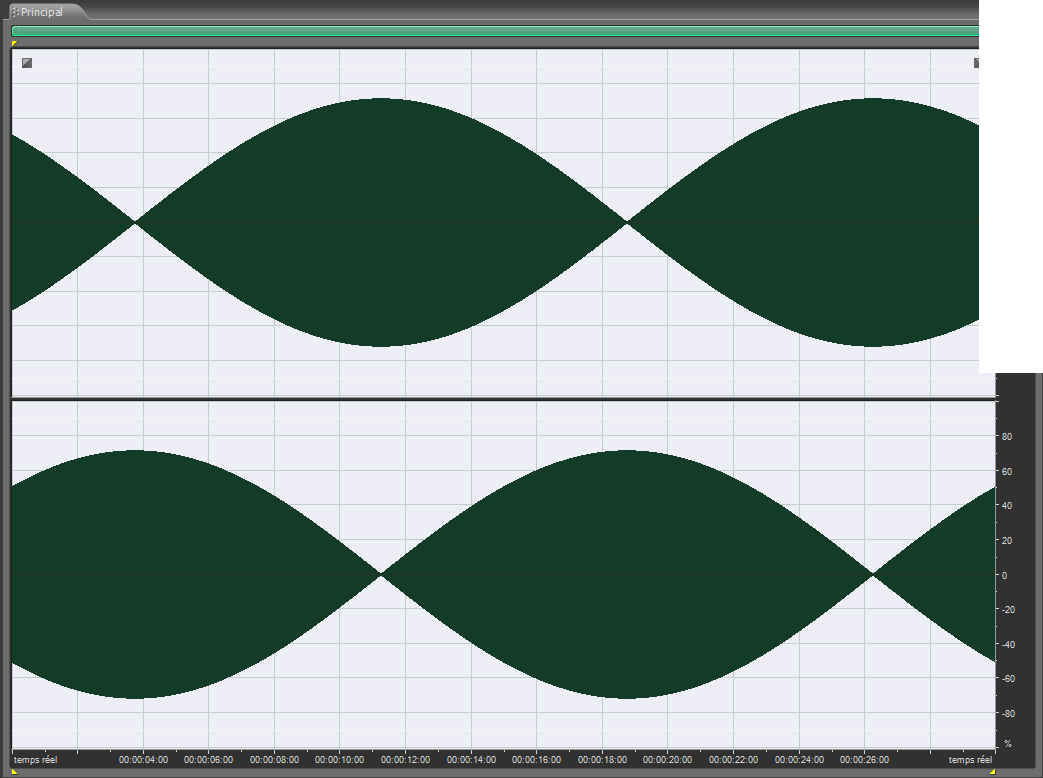

My bad, I just did the google translation, and they say 30 cm from the back wall and keep the sides clean.
Now, the question of the asymmetrical hearing properties (justification of the asymmetric tweeter) is very complex. Anatomically, the nerves give their infos to our both hemi brains, but it's not 50/50, the repartition is lateralized...and the 2 brains are specialized.
Almost all the authors agree now that on a right handed guy the right ear will more efficient for working on voices and the left one better for noises then music. But as it is a cognitive process, there is no general law, this depends of education, culture...
example: right handed musicians are supposed to hear music with the other side of the brain (more analytic than emotional), and for the japanese all is inversed.
I'm not a japanese musician, but I tried to move the tweeter, with a method allowing the control from the seat, closed eyes and so and on.
No difference at my level (never heard the difference between cables or other subtilities as the brand of a resistor
joined pic, the exclusive remote control of the tweeter![xeye :xeye: :xeye:](https://files.diyaudio.com/forums/images/smilies/xeye.gif)

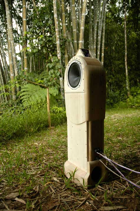

About the bass-mid driver: I understand you use Supravox because you had them? But Stereolith has 13cm side drivers whereas yours is 20cm diameter. Also as stated by Stereolith inventor the range of the most critical area for the 'effect' is around 1kHz. Now in this range 13cm driver has much wider dispersion than 20cm driver, and the direct sound to the listening position should be more than what you are having?
Also your room (I mean Hall
) is very big and side reflections are much delayed, as you measured. *Maybe* Stereolith requires side reflections of shorter duration than what you are having. You know the summing localisation works only up to some specific time delay after which reflections are perceived separately and not contribute to the imaging.
- Elias

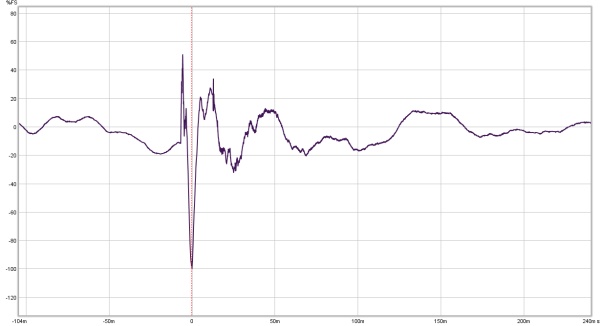

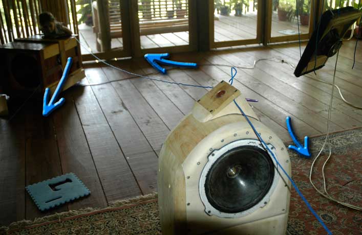

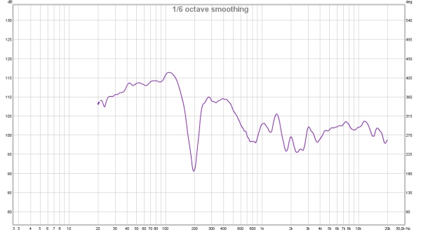

Good remarks from the other side of the world. It' an eye opener.
I was not thinking that the size of the room could be an issue. But I noticed that listening from as far as 15 m was nice, this has to be tested seriously
In these conditions the shift direct/reflected is 6.5 ms vs 19, so the reflected is also integrated in the tune perception, not so much tweeter delay and for sure a better "global feeling". (and a very low head room
The dispersion & beaming is a native problem of the supras. Now I setup the EQ differently :
So, except error (I am a specialist in this domain), dispersion is not the big issue in its topography.
But as you mention, there is for sure an issue with it's content : the supra is under the "no filter" rule and makes still a little 12000 with the generator. I am not yet a full range maniac
D
) but it's like that that I got the best results. The more the tweeter does, the more the image narrows.
I have a ceiling HF diffusor of 3 x 1.5 m inclined at 45° just on the top of "the" speaker. This kills the ceiling reflections of the other system. Maybe it's too much for a single poor little dome. As the diffusor is controlled by cables, I will try to neutralize it.
I am very far from the Stlith behavior, my thing is more apparented to a Bose (that I respect) : wide range + reflect use + EQ.
PS : this cluedo game is very funny !
- I make it flat on it's own axis
- the inter driver shift is integrated in the EQ
- I use low and high 6 db shelvings on the INPUT channel for voicing the response at the listening spot.

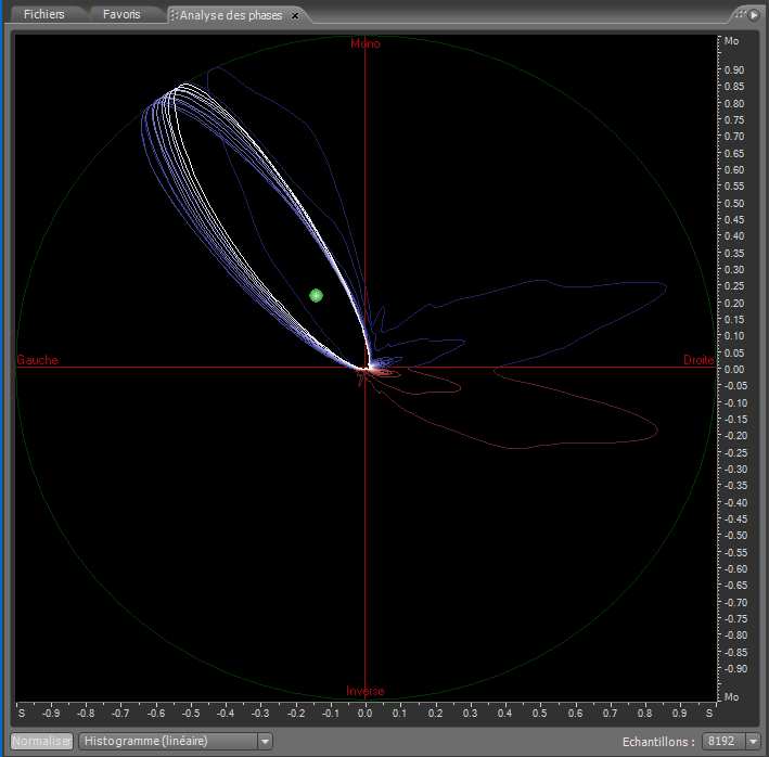

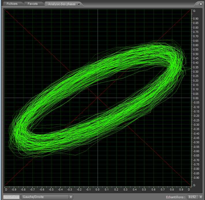

Hello guys
I have to say two different things :
First, I was listening and testing my little speaker with faulty amps : + 1 VOLT DC offset on the 3 channels !!!. Because, last week I changed a lot of details in the input stage, good idea, but checked the offset with a multimeter having a dead battery. Skilled a lot .![Christmas Hat Smily :xmasman: :xmasman:](https://files.diyaudio.com/forums/images/smilies/santa_smiley.gif)
Now, the pseudoSL makes everything much much better, including imaging, and my comments about the poor dynamic, nigh time speaker or very weak poor Supravox were justified only by the amps.
Second, about Tubamark...Hey, interventions like yours are absolutely welcome, necessary and mandatory, if not so each of us has better to stay in his corner.
I will not copy your text and adding my little comments in blue, because I agree almost with every statement. Laws of physic are one.
But there's a difference between what the speaker emits and what the listener feels, not because of any black magic, but because of the reflections, as you guessed, and :
PS: I am not a stereolith fan, just here to play with. But, OMG, it works really well.

After these emotions, let's go back to business. I've been checking if this lonely speaker can create a stereo field outdoor, without walls then and their very helpful reflections.
For this, my idea is to use Adobe Audition that has a lot of tools for evaluating all this
. After spending one day, either for making a good signal or for founding some "as flawless as possible" procedure, I've been measuring the speakers IN & OUT.
I was pretty sure of the opposite but : this lonely speaker produces a listenable and measurable stereofield outside.![faint :faint: :faint:](https://files.diyaudio.com/forums/images/smilies/faint.gif)
Of course, it's not a PA system ! I've been keeping the EQ and delays used inside, so it's not very adapted to the outdoor use. To tell the truth, the best place for listening here is to have the nose under the tweeter.
Absolute nearfield.
The SL really needs the reflections, I will never tell something else.
But, no doubt, at 2 meters, I had many stereo effects, the soundstage is narrow, but it's correctly lateralized. A good exception, a Q sound demo, the jet taking off : the plane is really leaving far away on the right side, with normal stereo
I don't tell you all the details of this saga, but it has not been a piece of cake.

- the wave used in the tests, 1000 Hz, rotation 180°
- one aspect of the phase analysis
- an other one (linear histogram)
- the 150 ms FR of the speaker : all that's missing is produced indoor by the reflections...a lot !
- The step, I believed it could have a better decay outdoor
- finally, a view of the operations, it's not a hoax

I wonder what it would look alike with those delays. How does this outdoor measurements compare to indoor measurements without delays?
I seriously believe that under such conditions Your "stereolith" works like an ambiopole, according to the equation given by Bock and Keele:
my theory of Your "stereolith" was different than Schupbach's theory of His Stereolith
I thought that it acted like a sound projector with room boundaries acting like a screen
Your experiment shows that the truth must lie somewhere in between
I expected no soundstage with an exception of this ambiopolic absolute nearfield case in which I was expecting correct lateralization and all other elements - as evidence that the projector throws sound images in correct directions, faithfully
yet there is some soundstage, so there is also something in Schupbach's claims
on the other hand it is not fully developed, quite residual, so there is something in my understanding as well
interesting is the case of exception:
this suggests that there might be no inherent problem in the design as such which makes it not very suited for outdoor use, perhaps it is rather a problem of compatibility with recording techniques

Er... I won't pretent I understand the phase analysis graphs... Looked up Adobe's site:
Adobe Audition 3.0
It says,
The colored ball shows the overall stereo and phase location of audio. The ball turns red for out‑of‑phase audio, green for in‑phase audio, and yellow for borderline audio.
The white outline shows the percentage of samples in each channel that are in‑ or out‑of‑phase, reflecting the width of the stereo image.
---- The white outline shows blah blah blah that are "reflecting the width of the stereo image. "
So... as I've seen in the video, in- or outdoor has very different (opposite) behaviors in near / far listening positions:
Indoor - widened when it's far away ; outdoor - widened when it's very near.
Or I mixed them up?
And that leads to:
