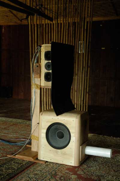

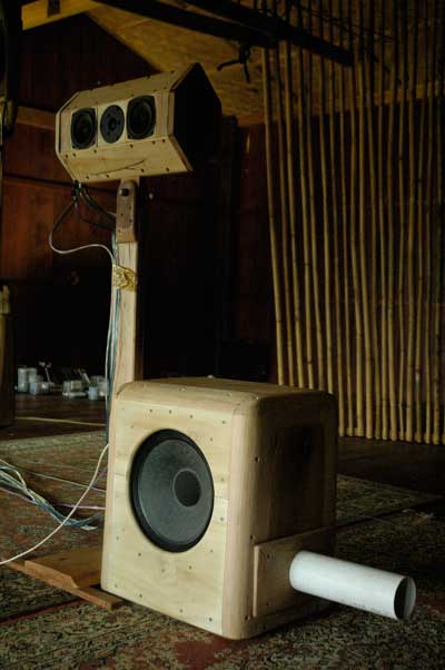

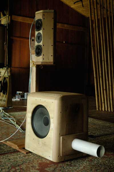

for all those experimenting with back-to-back - an important information perhaps:
it seems that around 20 cm or more width is really needed, too narrow back-to-back basically doesn't work
in fact (perhaps I have already told the story somewhere above) I tested three versions of back-to-back boxes, the first was just just 13 cm wide
the first one was a complete failure
