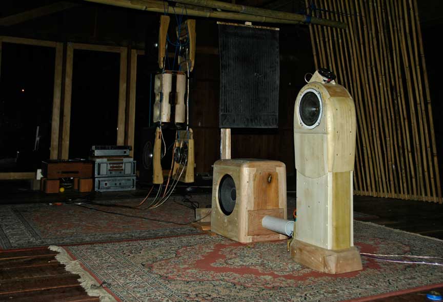

My difficulties are the most common :
it's not working as it was supposed to.
The duty if this pile of wood was multiple :
Then, I've seen the Finland pillow tweak. I tried with truck mudguard, this worked instantly. Ridiculous, but efficient.
Have to say that 2 barriers on axis have no interest. Some frequencies of the direct radiation have to be attenuated. When measuring, it's a big notch centered on 700 Hz.
- exploring the CTC (mids section horizontal, second driver wired from the other channel and in phase opp : nothing happens)
- exploring a special topology of filter that works very well on the other proto, unsuccessful again.
- and whatever I did as paradoxical wiring, DCX phase modifications, other placement in the room, I always had a 80 cm wide soundstage.

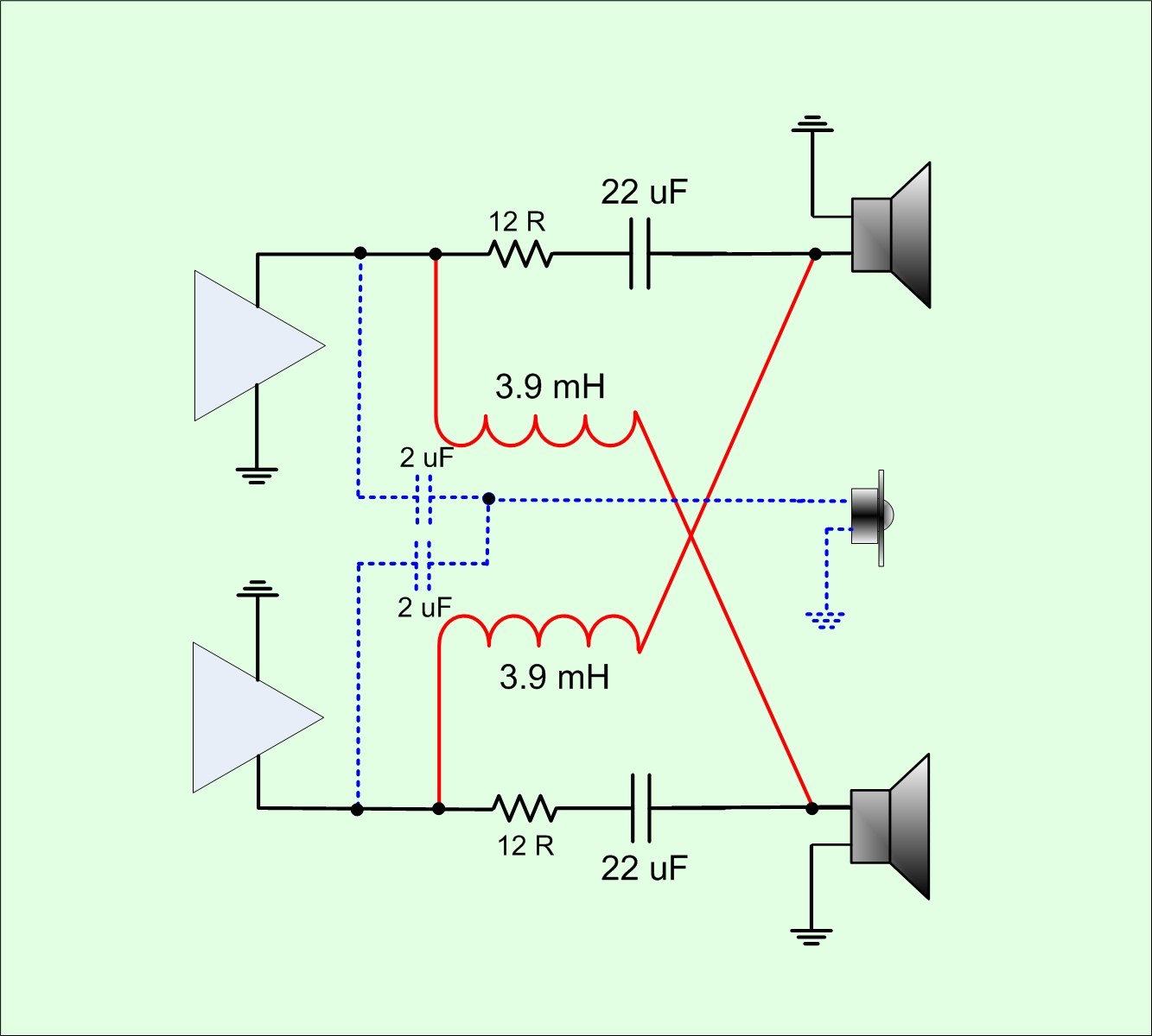

The first proto (TQWT with supravox) is now fitted with a quite special passive filter.
To make short, the ILD part remains as it is (left or right), but a part of the ITD related frequencies are sent to the opposite channel. Pink noise gives the localisation on the appropriate side, and the music too, slopes are swallow. No modifications of the FR or of the impulse. On the scheme, the 12 ohms is here to give the illusion of more bass, and the component values are also tailored to regularize the FR.
The results on the supravox are simply amazing, sometimes I am instinctively searching the source with my eyes so much there is a presence. It works also outside, but in the room, with the reflections, I heard a really 180° display on some musics. Just one problem, this kind of "wide range sound" needs a lot of bias from the listener.
I believed this filter could be an universal solution, obviously not, it's impossible to fit on the 3.5". Huge notch, then big overlap required, then no effect...
OTOH, some amps could disagree by blowing something.
Last word : a good way for comparing instantly two systems...with a PC as source, one system, passive, is linked to the analog output of the soundcard, the other system, through it's own DAC is linked to the digital output. Just have to click on the advanced play control panel. This is very revealing and destroys the listener's bias.
