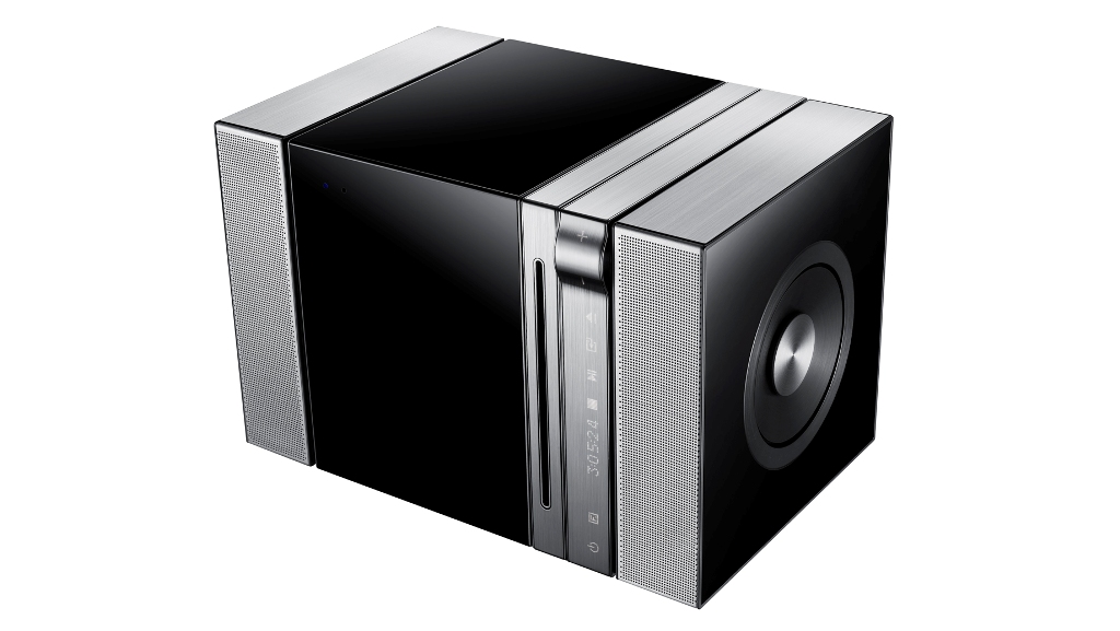

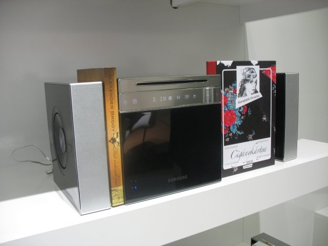

take a look at one of the latest Samsung products, it's HT-D7100 Blu-ray home theater system
