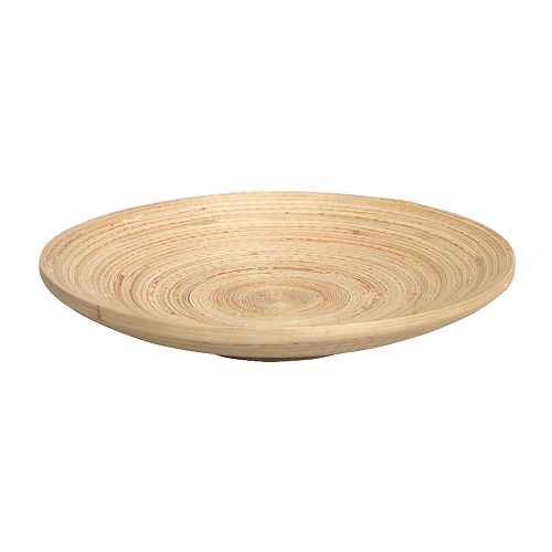

Have You tried the Brociner deflector option (like Radugazon's half-waveguide type)?
You can use various types of deflecting things for instance various bamboo bowls

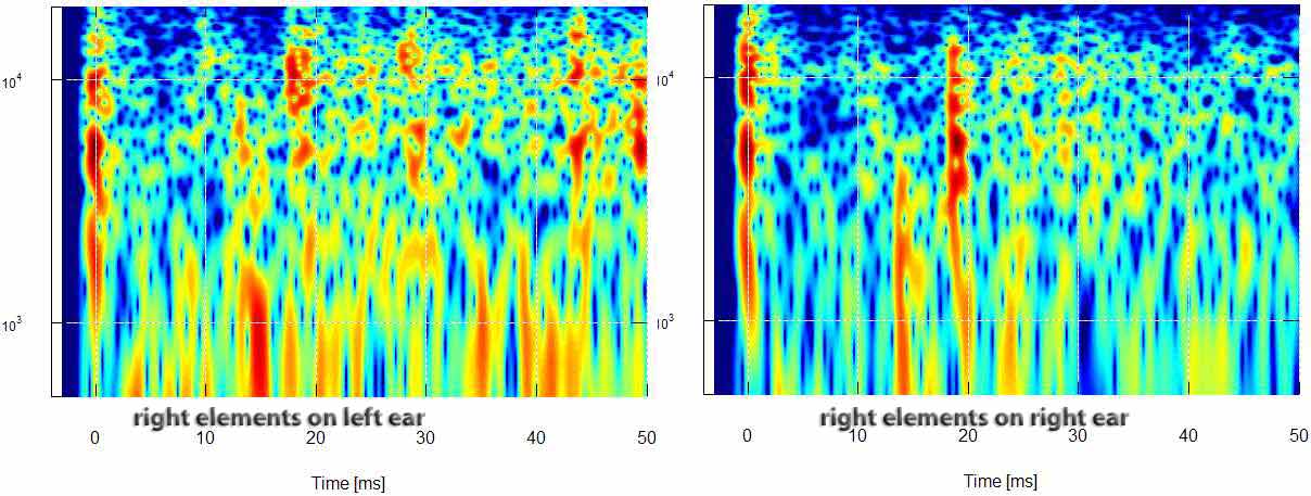

but experience contradicts this intuition, my own and also Radugazon's for instance:
Now the sound :
Some informations can be identified as coming from the walls, but not very often (if not so it’s a big trouble). Mostly the virtual sources are between, in the no speaker/no wall zone, and they are stable. More, they are where they have to be.
- The sweet spot is very wide, at 2.50m, at least 3 people could seat side to side. They can turn the head, nothing changes.
Listening this will then be listening :
- imaging is more contrasted, stable
(...)- the listening spot is almost anywhere except in the waves guides axis

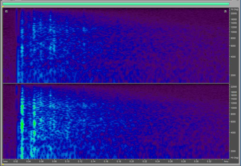

Get out your old cardboard boxes and measure. There's way too much speculation going on in this thread. I'd like to see more hard facts.
actually at least Elias and Radugazon have presented a lot of hard facts recently - with measurements, diagrams and pictures
Show us some hard facts about Stereosphere please

I've mentioned before (in this thread), I don't currently have that capability.
As for speculation..
The manufacturer lists the driver as 13cm, or in the states what we would refer to as a 5.25" driver.. NOT that the driver's diaphragm is 5.25" but rather the total diameter of the driver is *roughly* 5.25".
As I've mentioned before, I don't currently have access to measuring equipment or even the smaller driver's I've used in similar experiments.
What I have seen however is:
1. manufacturer data on all sorts of "5.25" inch drivers. (..and in many cases extending to 60 degrees off-axis - which of course exhibits *less* pressure loss than at 90 degrees (..depending on combing)).
2. Elias's measurements with a MUCH smaller diameter driver and measurements that are NOT nearfield (post 437).
3. Your own measurements (post 326).
