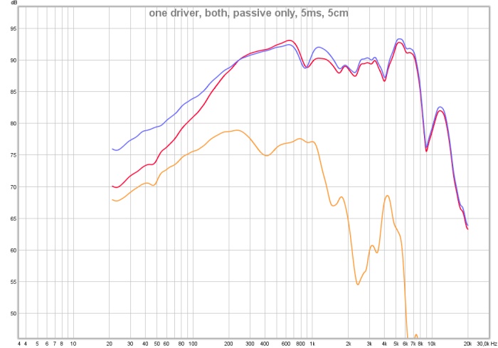

Nearfield left midwoofer, testsignal left and right:
A signal at the right woofer terminal is fed over a 6 dB/oct lowpass @ 100 Hz to the left woofer too. Is that what you are trying to show?
BTW: In the picture of your measuring layout - is 0° along the tweeter axis (plane) or along the woofer axis?
Good point Rudolf, there is something, because from what I know, in a common enclosure, the unconnected driver cuts abruptly after +/- 1000 Hz. Can be seen here
I suppose it's around 1mh + 3.3 R serie.
Looks like I'm not the only one to play with X-filters.
Only one solution now for markus : the screwdriver. Please markus.....
While doing this nearfield measurement, are you having both of the mid drivers connected to the amplifier?
Yes.
Also is your amplifier having common ground or two separate balanced outputs?
Test signal goes into a DCX2496, is split to output 1 and 2 which are fed to the left and right input of a Samson 120a.
How do the impulse responses look like?
From the nearfield measurements?
I think the drivers operate on the same volume. There's only one reflex port...
0° is along the tweeter axis like in the picture.

Can it be that the signal from the other channel has the same phase? I rather expected something like -L on the right side and -R on the left.
