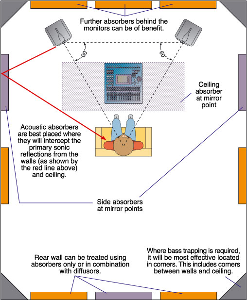

PS. @Rudolf
So no patches of absorbing material (curtains, windows etc.) or protruding furniture anywhere in the 150° space in front of the listener, right?
obviously WRONG
actually rather some small patches of reflecting material are needed
for instance take a look at this:
The Studio SOS Guide To Monitoring & Acoustic Treatment
and at the drawing attached below
then replace in the linked text the expression unwanted reflections with wanted reflections and place reflecting patches at mirror points instead of absorbers or diffusors
piece of cake, isn't it?
