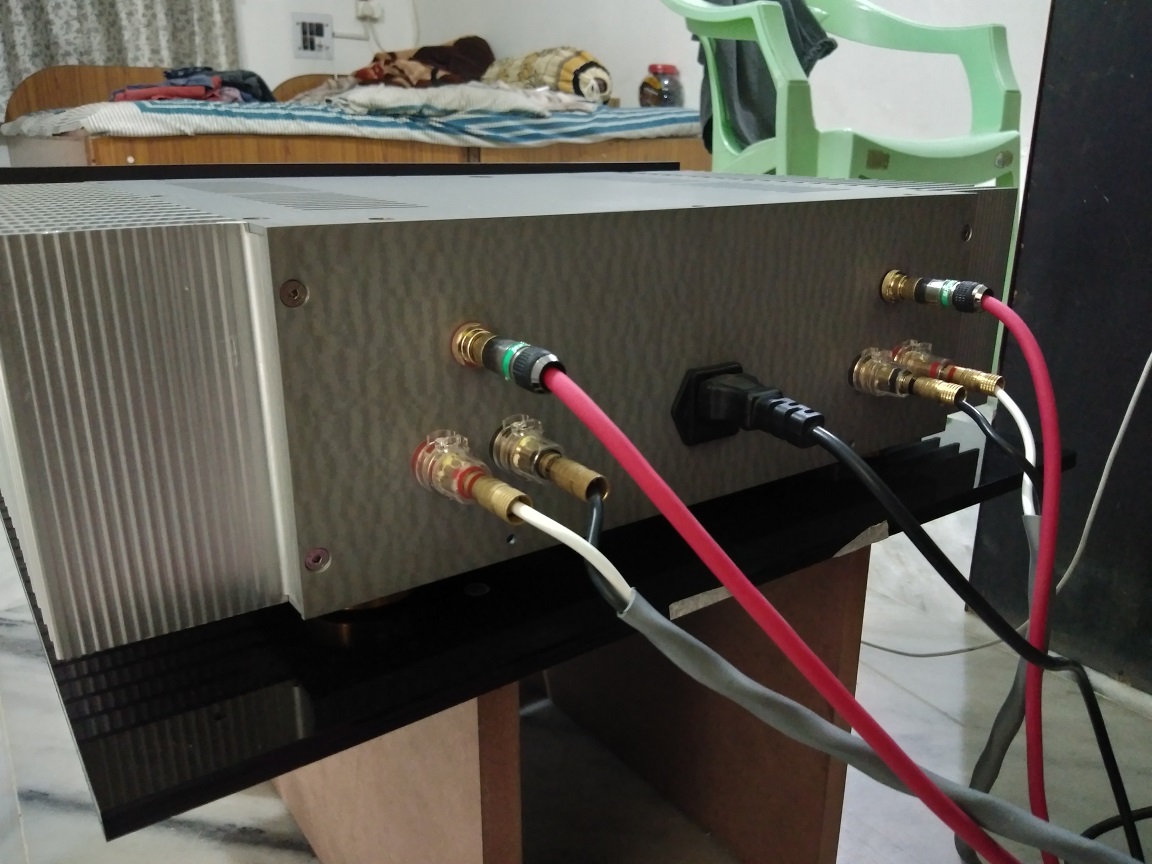

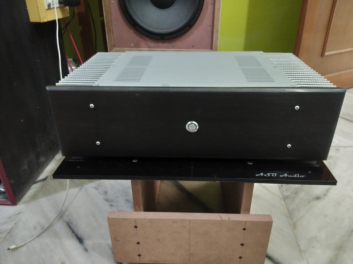

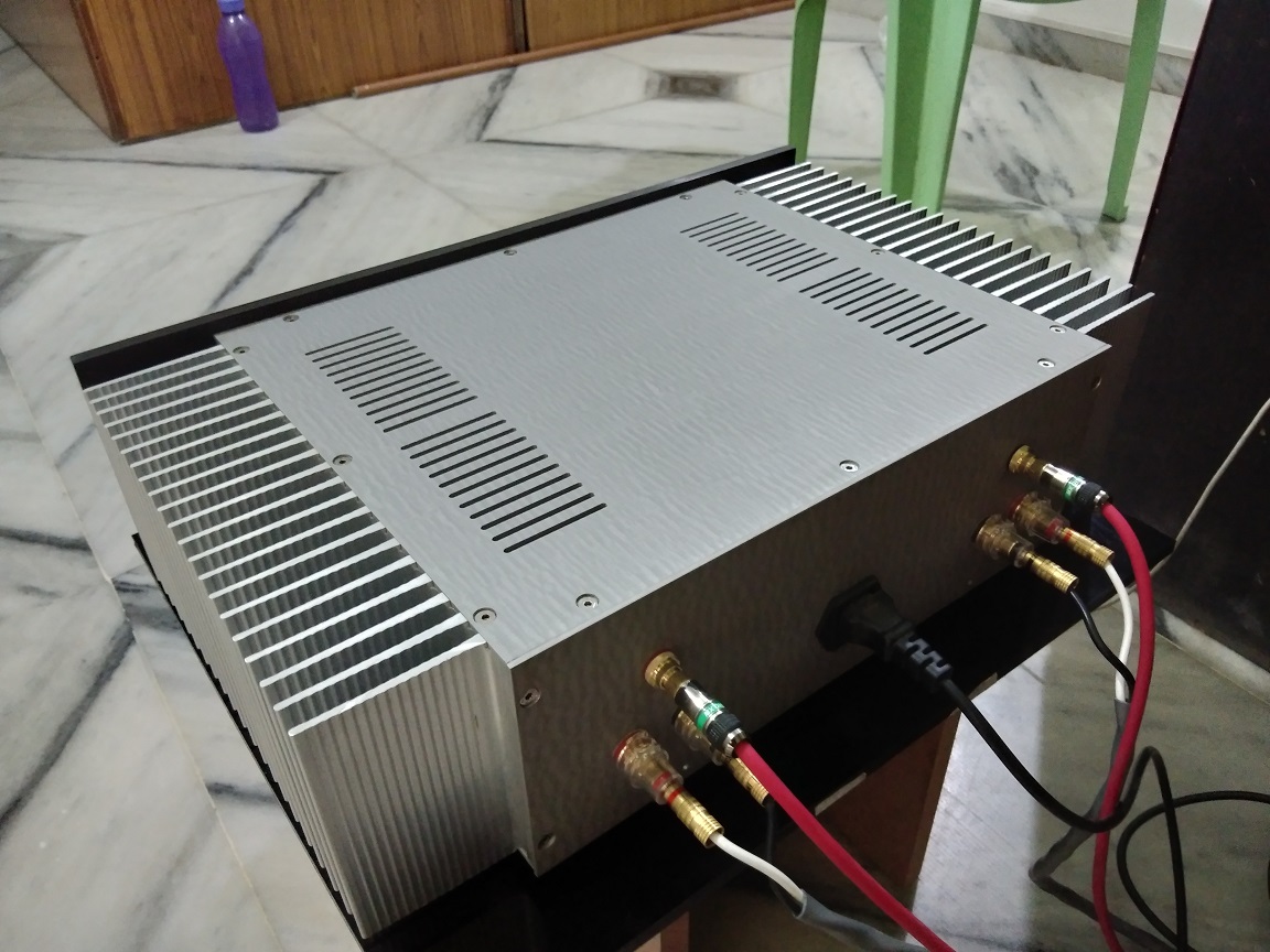

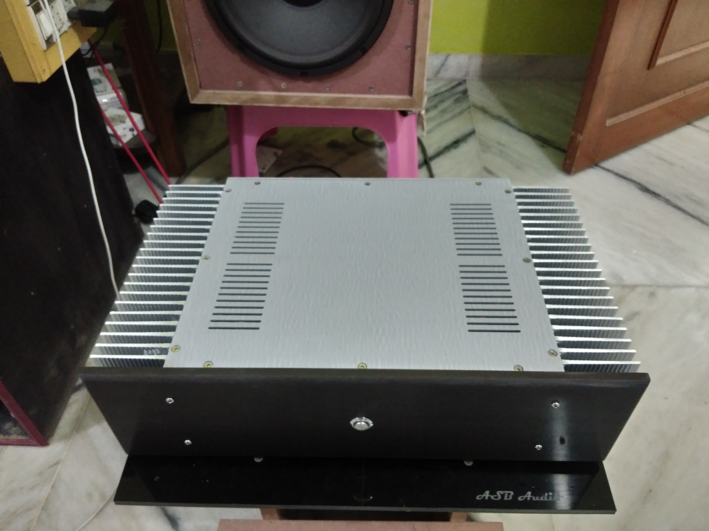

Here are my final photos of SR200 Amplifier.

Sadik,
It really looks very well organized and professional.

I think everything is included in soft turn on board. I just have to make connections from the main line & to the transformer thats it. More details can be found on the link which i shared above.
Nice work, what is the heatsinks?
Where you buy these?
These heatsinks are available in India. I purchased from stockist named "Akash Enterprise" Product Code: K 300 | Akashheatsink.com
