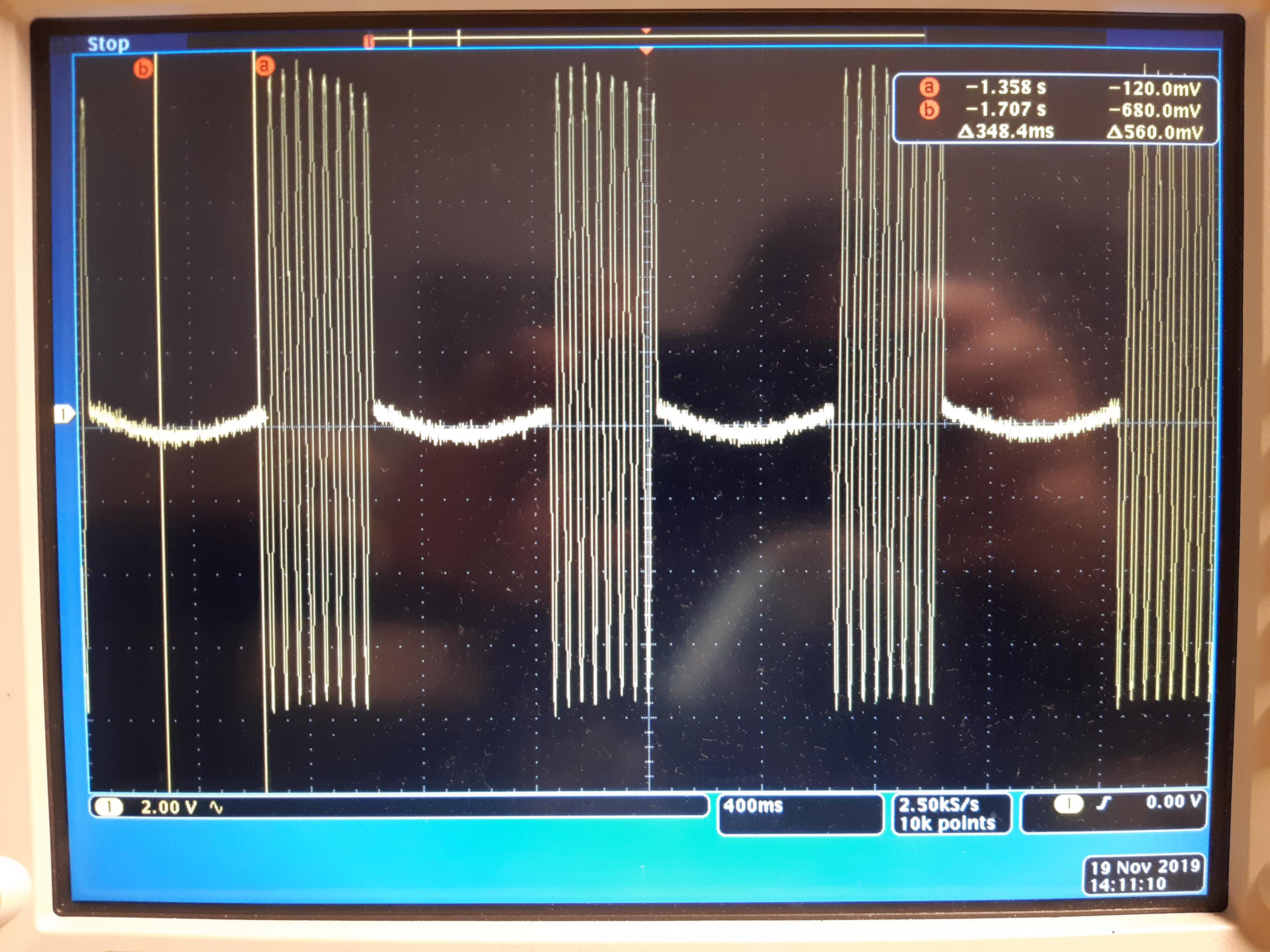

I have also converted the PNP JLH to floating ground now, and I can see some swinging/oscillation in the ground voltage when I quickly increase/decrease input signal. The oscillation is damped('rings out' in a couple of periods), and around 1Hz. Capacitance on the main capacitors for the floating ground is more than 15mF each, but C4 is only 200uF at the moment, and input capacitor is 47uF.
Am I correct in assuming that increasing C4 should make it more stable/slow?

I did not trust the LF performance of such a design, but simulated it a while ago out of curiosity. Indeed there was an undesirable low frequency damped oscillation. It was ameliorated using 1mF -100 ohm decoupling filters on the input bias chain, to a tolerable level, and yes you could not use a single supply for two channels.

Here is a screenshot of bursts and the swing between bursts. I guess the moving midpoint would not matter much until the amp approaches clipping?

I see the same oscillation at startup too, but with the input open there is no oscillation, leads me to think the variation is fed back trough the input, causing the big swings.
Maybe a smaller input cap, or some kind of 'filtering' on the ground side of the input would improve it?
EDIT: Tried a smaller input cap, and the oscillation is gone. Guess it's a matter of fine tuning the input cap..

I think you can blame the start up issue on the use of a switch-mode power supply following which it settles.
The subjective perception of loss of bass is likely to be due a supply output impedance which is not adequately low in that frequency range.
