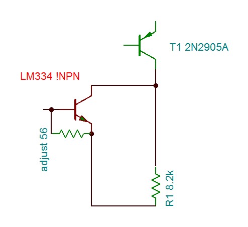

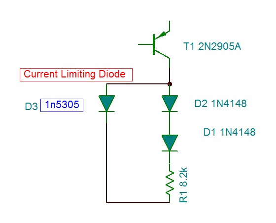

no , mine, pulls the bias of the input transistor from the collector about two extra ma. If you do it by reducing the collector resistor that the gain will be reduced .Is it in principle the same as this? (Q5/Q6)

I have done the mod, and checked that they function with scope and low Iq setting. Only thing I saw, was that it looked like the noise was higher now on the scope after this mod. I used the BC337-40, could the high gain give more noise?

Which simulator are you using? Thank you ...A 100uf grounding the bases can help reduce the noise .
Tina Ti free download from Texas Instrument.Which simulator are you using? Thank you ...

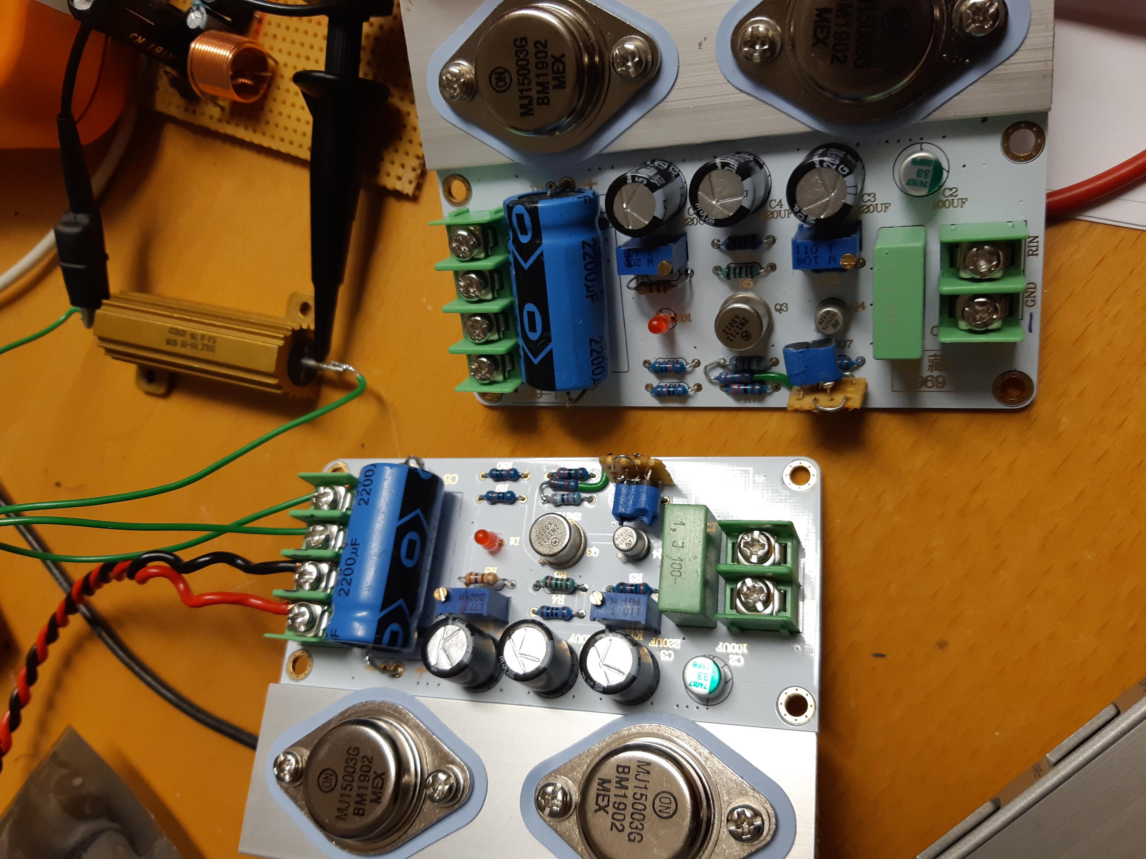

Ok, I have done some measurements and adjustments after adding the current limiting circuit. It seems the DC balance changed, so I could not get Iq higher than 1A, and I had to do a lot of turns on the offset trimmer too. I changed back R8 to 220ohm to get higher Iq, and adjusted for lowest distortion. Iq is now abt 1,3A after warming up.
On the measurement IMD is higher than the measurement I did here https://www.diyaudio.com/forums/solid-state/3075-jlh-10-watt-class-amplifier-562.html#post5969996
Now the 1kHz peak is a little bit higher, and there is another peak at 2kHz almost the same level as 1kHz on the two tone FFT, so I would say it measures worse than before.
I have only listened a little bit, and first impression was that it sounds a little bit brighter, but I'm not sure... First impression is that sound is good, but I need to give it some time.

Also changing R8/KT2/R7 to increase the current here? In this case I can not use trimmers to do 'my thing' adjusting the current and balance between the transistors. Too high power for trimmers I think?
Yes, I think the sound was more mellow/laid back before, now transients sound sharper, and overall a little bit brighter sound. Not sure which I prefer yet.
As you noticed a difference in sound you can adjust at your taste by Ra 8.2k to have more or less definition. The 10k input load is in case the source has also capacitor output , than the 100uf capacitor can not polarize . The biasing resistors you already adjusted , once finished replace the low current adjust by a fix resistor . Rb 3.9k is indeed a pull to provide current to 100 ohm in case the speaker is not branched .Yes, I think the sound was more mellow/laid back before, now transients sound sharper, and overall a little bit brighter sound. Not sure which I prefer yet.

Jlh needs to function with very low current biased input transistor. This error comparing stage functions with IC/Vbe character of the transistor. Transistors need several milliamps bias to polarize the base emitter diode in more linear operating point . There is a transistor specialized for low currents is ksa992 . Probably it is the best choice.
