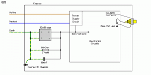

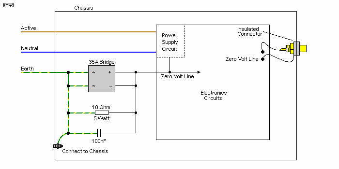

Today I applied the 3k3 from the base of 2n1711 to ground, the cascode (made from bc413b) and the 8k2 from V+ and got full 28V on the output instead of half Vcc. Have any ideea? Do i have modify everything as you did to work, or i can modify only that part?
Also when putting the floating ground center to GND (through ground loop breaker) it shorts one cap. How do you connect the floating point to GND? My star ground is also connected there to clean the ripple out. Or you dont have a ground loop breaker?

I suppose what you call cascode with bc413 is the current mirror 2xbc413. You made the amp function without speaker neither 3.9k pull up resistor , so the input transistor pulled the 3ma current from the upper capacitor . Plug in the speaker and re adjust the Vcc/2 . The precedent ground is now called -14V . The only ground, non floating, is the joint of the two capacitors which must be used as the star point . The speaker the emitter resistor of the input and the input reference ground are taken from the common joint of the two capacitors. In the picture these capacitors are near the circuit , they must be upon the output transistors with the leads of the capacitors link directly without wires the collector and the emitter . You can fix the joining leads to the heat sink . Without this procedure you louse lot of bass .
What is ground loop bracker?
smiley with a big eyes !!Thank you very much. Now i understand it better. In the pic bellow is a pic posted from ESP page wich shows exactily how the loop breaker is done.
