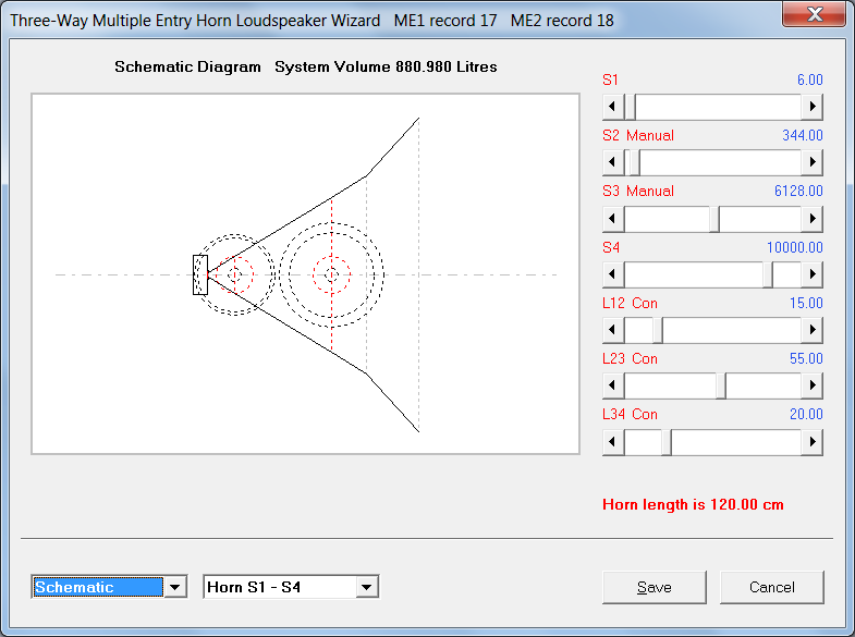

What starting value should be used to calculate the local flare rate for a 1" CD? Candidates are 2.53cm2, 3.226cm2 and 5.067cm2.

This is how I've tried to go about it so far, step-by-step:

2. Double-click S1 to bring up:
![33m5x21.jpg](/community/proxy.php?image=http%3A%2F%2Fi64.tinypic.com%2F33m5x21.jpg&hash=008428e0fd5c0c3ffe36908223a9373b)
3. Click to calculate L12 instead of Fta:
![2d170wz.jpg](/community/proxy.php?image=http%3A%2F%2Fi64.tinypic.com%2F2d170wz.jpg&hash=bf361eac9c9f13f3bbf5dcd4ea1b5110)
4. Amend S2 to double that of S1:
![25zgi12.jpg](/community/proxy.php?image=http%3A%2F%2Fi68.tinypic.com%2F25zgi12.jpg&hash=46e1d08ddfda8c5d33899185e77a3bad)
5. Click calculate to get L12 (in this case 0.59):
![5510g4.jpg](/community/proxy.php?image=http%3A%2F%2Fi65.tinypic.com%2F5510g4.jpg&hash=28f19cae2c6d2969866523ab8b37b524)
6. Click save to return to input parameter window:
![jr7j9v.jpg](/community/proxy.php?image=http%3A%2F%2Fi65.tinypic.com%2Fjr7j9v.jpg&hash=3841abb9d17eedf54d2b17189e57a6e4)
7. Highlight Con12 (0.59), hit "E" key to change from conical to exponential, and read flare rate in F12, as circled below:
![2w2el2c.jpg](/community/proxy.php?image=http%3A%2F%2Fi66.tinypic.com%2F2w2el2c.jpg&hash=5606092b98eff36a2bf8c56f2a5cdf9a)
... which doesn't look right (too high) for this 80 x 40 horn. Using different S1 doesn't change this fact:
![2h2qhiq.jpg](/community/proxy.php?image=http%3A%2F%2Fi67.tinypic.com%2F2h2qhiq.jpg&hash=dc1fbc0ff7603f6943cb3d6143511711)
![2yl4mcw.jpg](/community/proxy.php?image=http%3A%2F%2Fi64.tinypic.com%2F2yl4mcw.jpg&hash=3a576a4ad1716bb893b5fa0fd6050726)
What am I doing wrong...?
Why are you changing to exponential? I don't think you have or want an exponential expansion there near the throat do you?
BTW, my suggestion in the spreadsheet to use a 0.707x0.707 square as the initial throat is because I planned to then open it to a 1"D circular throat with a drill. My cheap'n'easy way to repeatably transition from a round throated driver to a rectangular horn, so the throat actually starts as a 1"D circle. No idea if that scheme is ideal, but the other easy option was to start with a 1"x1" square and then use wood putty to smooth that down into a circular throat, which wouldn't be as repeatable. I made horns both way, can't say either worked any better or really much different than the other. Contrary to lots of reports I've read, smallish changes down there never seemed to make a big difference in measured response. I've also considered doing it the way Danley did, and just have the throat be the circular hole of the compression driver mounted on a square entry to the horn ("getting the diffraction over with" was I think how he stated it in a response to a post by Geddes), but haven't actually tried that one.
Also, my usual strategy of getting the mid entry as close as possible to the throat may not be technically correct, but as my waveguides were always wide angled (usually 90 degrees) and my compression tweeters small (usually CDX1-1445, which doesn't go much below 2kHz easily), the best place for a highish crossover always wanted to be closer to the tweeter than I could get it. With a narrower conical horn (longer, with slower expansion) or with a tweeter that pushes lower, then the best place could well be further up from the throat.

Just to be clear - 5cm2 is the correct value for S1. That is the area of the 1" dia circle you end up with when you do as Bill says and drill out the initial .707" square.
I agree that the flare rate is confusing. Long back I asked for a theoretical/mathematical explanation and got that step by step procedure for getting HR to calculate it for you. What should be pointed out however is that once you have the HR plotted frequency response of the mids on the horn, you don't need the flare rate. You can see how low they will play. Just for grins, do a sim with a 2x longer L12 and correspondingly larger S2. The mids should play lower but not as high. Just another compromise you will be forced to deal with if you design a synergy horn. The low limit is determined by the flare rate at the entry point; the high limit by the round trip time for the reflection from the CD diaphragm, both together with the driver characteristics. To get an accurate reading of the latter, you need to add the acoustic path length of the CD to the L12 of the horn itself to get a total L12 for HR to crunch on.
While playing what-if games on teh simulator, you can change the first segment from CON to EXP and see that it doesn't change the response much. Where you will see big changes is changing the chamber type to throat ported (if it isn't already) and then playing with port length and area, Vtc, and Atc. These take a lot of optimization and some cut and try is inevitable no matter how much HR simulation you do.

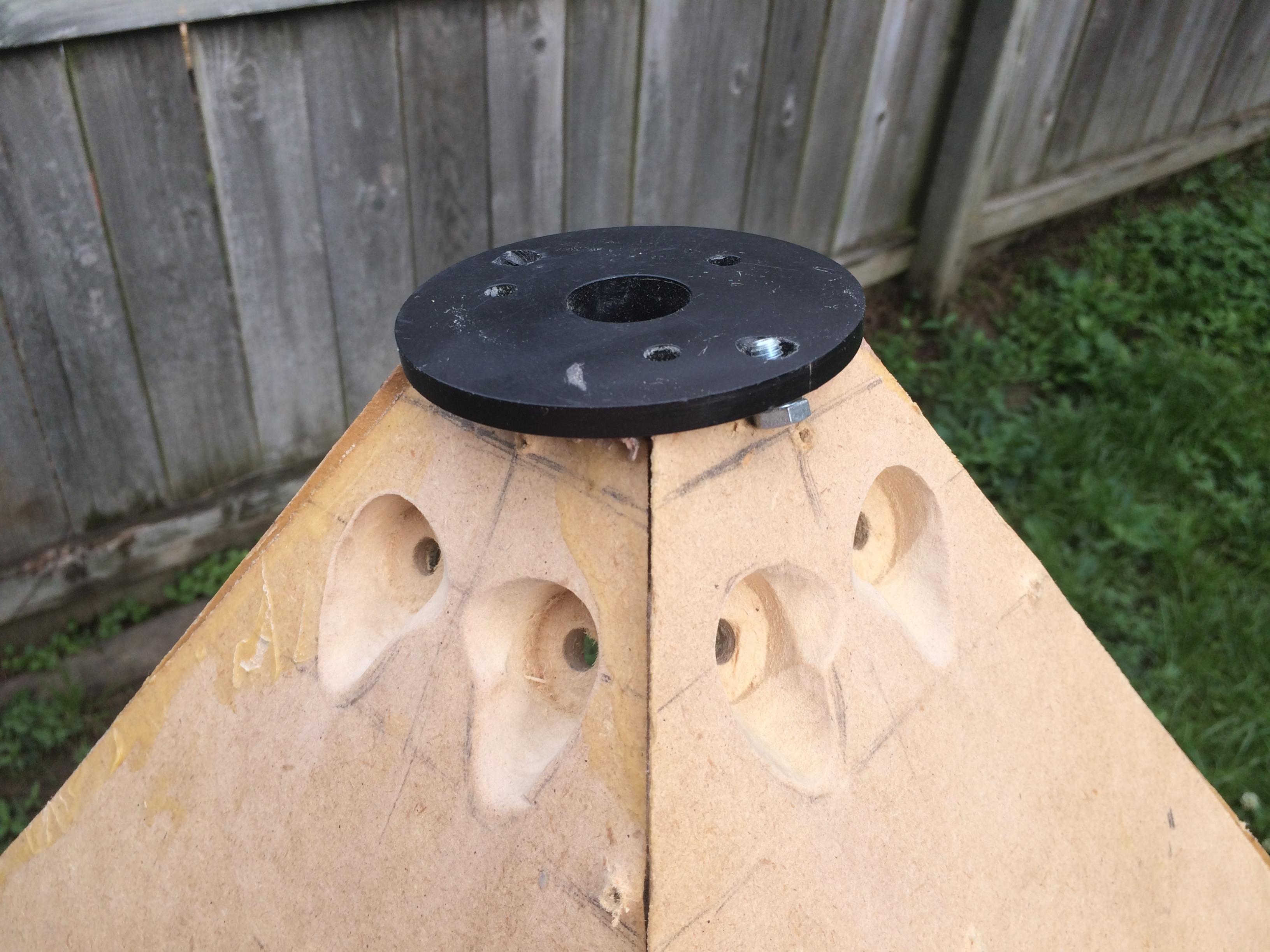

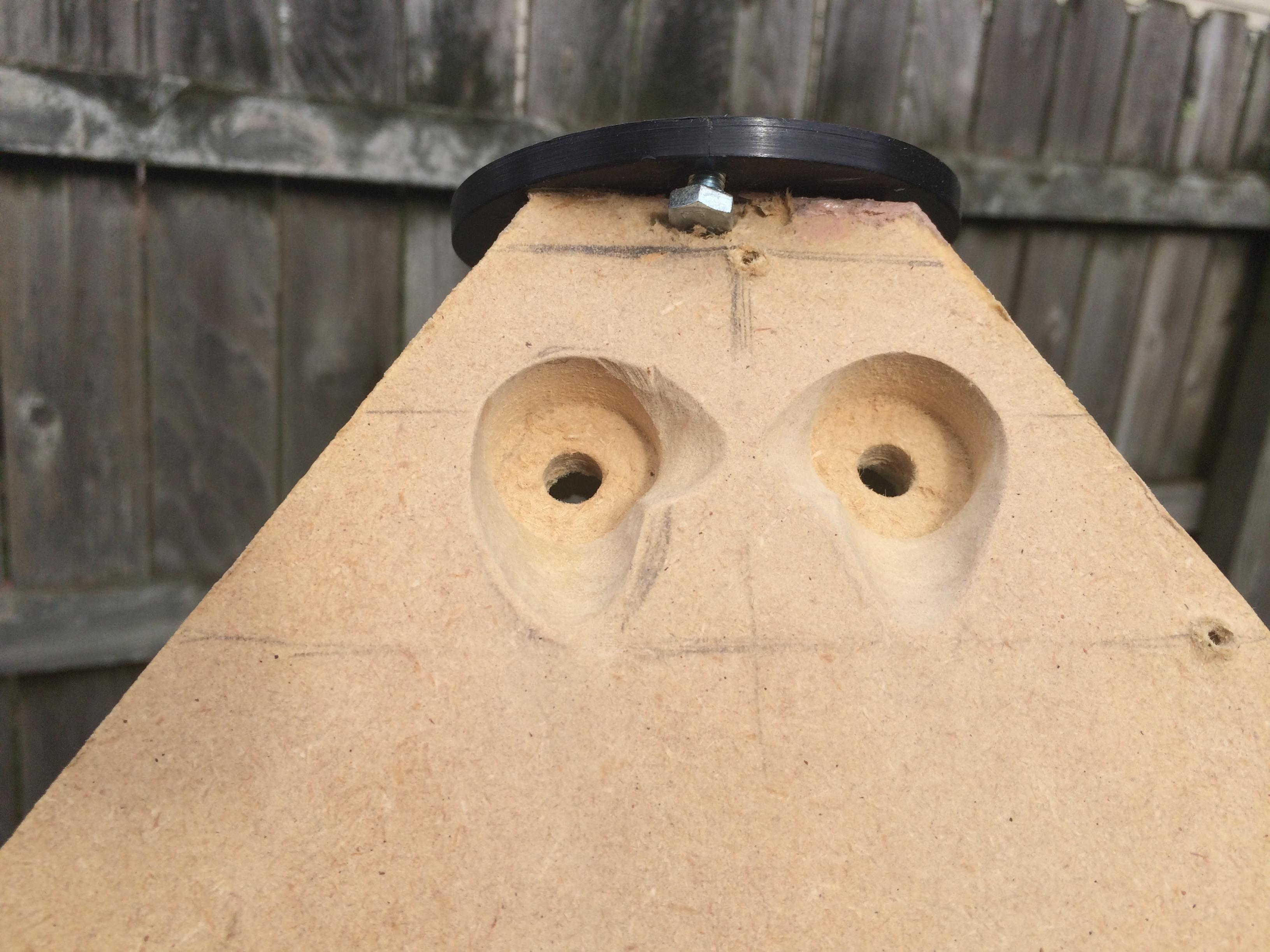

![TfvLvrz.jpg](https://i.imgur.com/TfvLvrz.jpg)
![PvJEirL.jpg](https://i.imgur.com/PvJEirL.jpg)
![LyFcOD3.jpg](https://i.imgur.com/LyFcOD3.jpg)
Finally got to a point where I could listen to the speaker. Still very far from finished. The buyout Titan drivers work decently. Only put 2 of 4 on so far, but I was eager to have a listen. After some time doing EQ, it sounds quite good. I'm sure I could get it flatter than shown if I used the rest of the PEQs, but that would probably be a waste of time.
I will have to do a lot of experimentation with the mid chambers. They're currently flat out to 800hz, but I'm hoping that by shaping the ports and reducing the chamber volume I can get them up to a more reasonable crossover point like 1.6k or higher.
If I can't get them high enough to not strain the D220Ti, might buy some Eminence PSD:2002s and put the Seleniums on a different project.

I used some very low cost GRS mids, which only cost about $1 more than the Titans. They should be very similar (cheap, no frills, oem'ish)
I did this with a dremel tool. I might still try to fill in the area between the cone and horn to raise the freq resp and increase the overlap with the CD.
