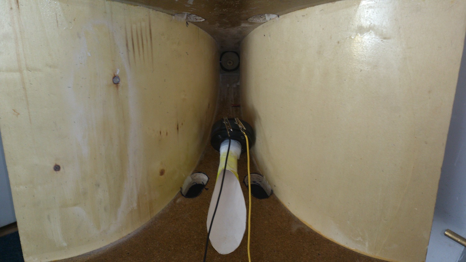

Guess this is a good a time as any for an update. I finally assembled it with all 4 mids and frustums on the ports. Now I just need to reduce the chamber volume to bump up the high corner. EQing the response flat is trivial because there's tons of headroom, but it's something I'll have to address eventually. Also noticed that my distortion figures on the CD were pretty high in the higher frequencies. What kind of figures should I be looking for?
The pattern control is amazing as always
https://youtu.be/gxZFNINsBqo
Really love the sound. Can't wait to have these things FINISHED. Extremely rewarding but man are they a pain to build. I set out to demonstrate that you could make a very good synergy speaker with very cheap drivers, and I think that's been accomplished. But now that I've put all the time and effort into building it, I feel like taking the absolute cheapest route on drivers is difficult to justify.
