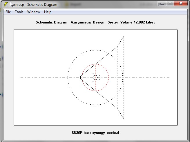

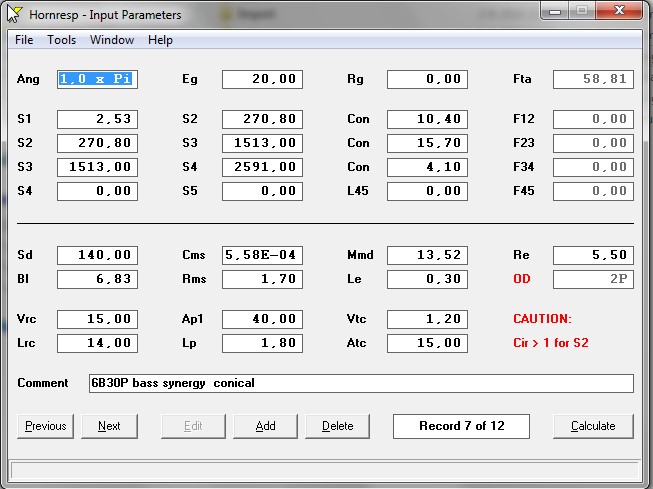

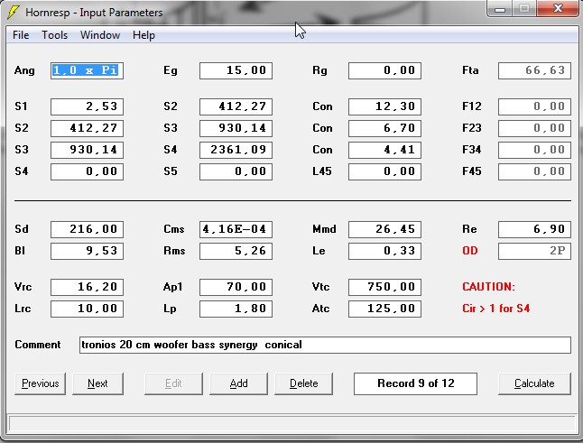

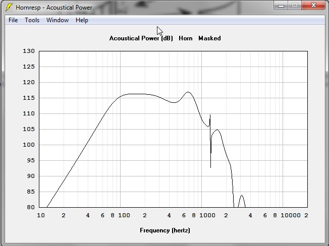

Its not 1/2 or 1/4 Sd. Its not a matter of compression ratio. Its a matter of tuning response shape around crossover with port area and port length, best done in simulation. Also note effective port length can be reduced by creating a frustrum around the port and smaller is better. You make the hole as small as possible consistent with your bandwidth requirements and checking that particle velocity in the port doesn't get too high at high volume.
In my "Synergy Corner Horns.." I used one 1/4" wide, rounded end slot per 4" driver, each slot 5/8" long. The horn walls were 12mm but thinned down to half that in the vicinity of the slots to create a frustrum. That is the smallest I've heard anyone make work. If you start there, you can always make them bigger.

Are you going to have both the vent and the cone ported into your Synergy horn? The highest velocities will be associated with the vent, I think, allowing the main port to be smaller. You should consider porting the vent through the baffle instead of into the horn. There is no doubt 45 Hz will be below its pattern control frequency.
These ports should be "frustrumized" to reduce the effective port length which will also allow you to use smaller holes.
A HornResp sim will allow you to find optimal port sizes and predict velocities.
I was looking at porting my 15's into the horn just like the synergy horns of DSL. So normal "4th order," on the mids and then 6th order on the 15's with the 45hz port exiting into the horn mouth.
Just like it is here in Danley's.
