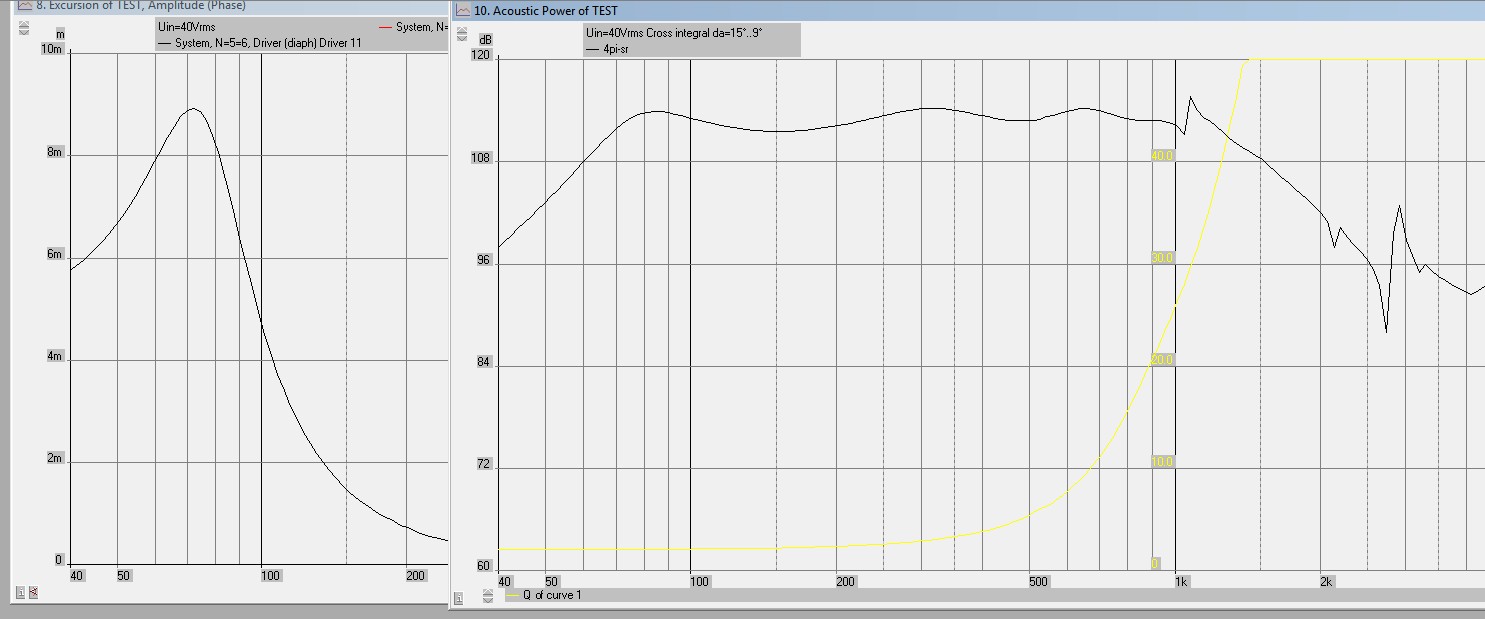

Oke, for the others, I have try in akabak the two phillips woofers, she do work with a nice bandwidth but run out of Xmax quick around 80 hz where afcourse hornloading is no more present, with a basreflex port things are better. this is the last question I have now enough stuff to go practice a lot with that speaker thingie.

The sheet for calc a synergy horn is nice stuff, when I calc a horn 400 Hz then I get this with the two phillips woofers.
A compression driver is needed, do not now what a tweeter does, have to measure this when it is that far.

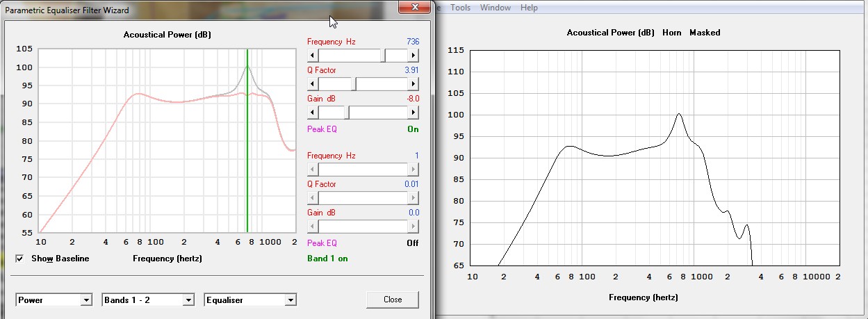

I did a EQ for the front chamber peak of the woofers, (woofer chamber filled half each for smaller VTC).
Also I need a bassreflex port for woofers to limit Xmax considerly. And the eq for the peak is easely done with analog filter, adjusting with sweep signal measuring output.

Kees,
You might try a Helmholtz resonator stub to control that peak passively without electronics or filters as you say you are not using DSP. A 4.5 inch long stub filled with wadding may control that quite nicely. Very easy to simulate in AkAbak prior to build.
I am surprised you say a BR is needed to control excursion. I usually find a small sealed chamber more effective although bass extension won't be as low.

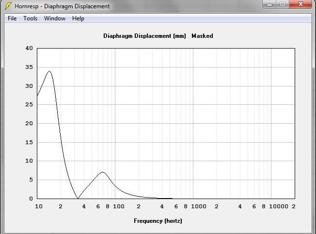

Sealed chamber do work, but I did simulate that it has to much excursion when go above 110 dB, you are proberly right about that this is quite loud, and the phillips has not much Xmax peaking easely above that when watch movies for example, so a BR do help here.
I go for the conic synergy as a start, and so try everything when it gets winter here.
that Pipe I do hear some of it long ago, however you now I am still a akabak nert, a filter with a scap/inductor in serie who have some Q do work fine, Q set makes it set bandwidth, this sit between speaker terminals, more I do not need.

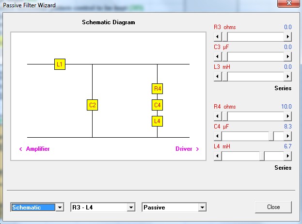

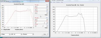

Oke I did use the hornresp filter capacity to let see how easy it is.
Q of coil/cap is make low be resistor after the low pass.
Afcourse it is simmed, so in real world it is harder, but a adjustable coil and resistor will do I hope

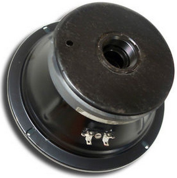

I seen this oddball over at ebay (Speaker Addict's Store):
Eminence 8" 8 Ohm Sealed Closed Back Beta 8CXCB 2 Way Coax Midrange Custom Made
Search it, I have no luck with copy/paste links that got tracking info embedded in them.
No idea what might be the sealed back TS, cause he's
listed wrong set of specs from the normal Beta8cx.
There are multiple answers to that. What do you want it to do? Maximum usable bandwidth would lay somewhere between 70Hz and 790Hz.
Thanks, John.
I have 200Hz horns with compression drivers. That implies a crossover between 300Hz - 400Hz. I am looking for "something" below this crossover
frequency. Since I have Studio 8M drivers, these are a possibility.
