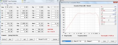

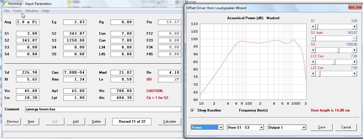

Ik have a very old phillips woofer 8 inch, it did this in the synergy.
port 7 cm from the throat, as you see it go above 1000 Hz.
But I go on with the tractrix horn, will on a day go try these synergy also, keeps me busy.
