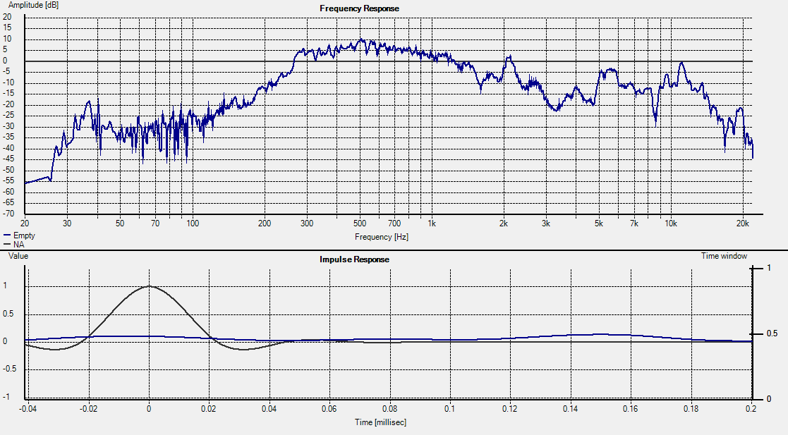

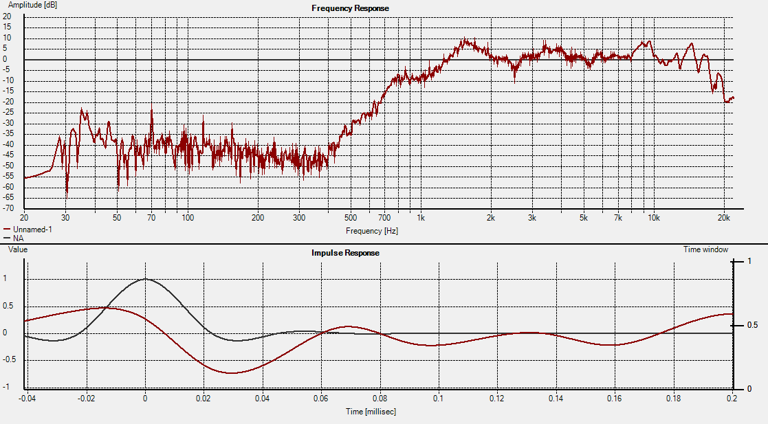

Hello All,
Here is what I have so far. I built this horn based on Jmorkins thread:
http://www.diyaudio.com/forums/multi-way/195955-unity-horn-budget-drivers-active-x-over.html
It looks like I get good extension on the mids. It is my understanding that having some overlap between drivers will help when crossing over. Im stil trying to find out if I have the mids ported in the right area to create the "synergy" effect. With crossover in place I should get near perfect phase tracking?
Just an FYI: I know how to press the measure button on my gear but that is about it.
Ah, if only it were that easy. The midrange placement HELPS getting phase tracking, but it certainly doesn't do the whole job. It just helps to counter the delay you'd normally get from the midrange's lowpass crossover response.
That said, I think your overlap looks fine. If I were you, I'd get a miniDSP and use that as crossover, much easier to work with delays and response flattening than trying to do it with passive components (which, plainly said, is an absolute b**ch to do). And since you can press the measure button, just keep pressing it and watching while you change crossover points, delays, filter types, and parametric peaks/notches on the MiniDSP, till it all works out (and till you have enough isolation/protection for the tweeter). Trial and error works great when you have the control a DSP gives.
Also, 'That Said' again, getting the response to be 'linear phase' (a.k.a. 'waveform faithful', 'square wave coherent', etc., etc.) hasn't seemed to be a dramatic (if even noticeable) improvement at least in my setup. Getting all the sound to come from the same point and having the uniform directivity is the bulk of the benefit, and you are basically there already. I think that speaker is going to sound GOOD.

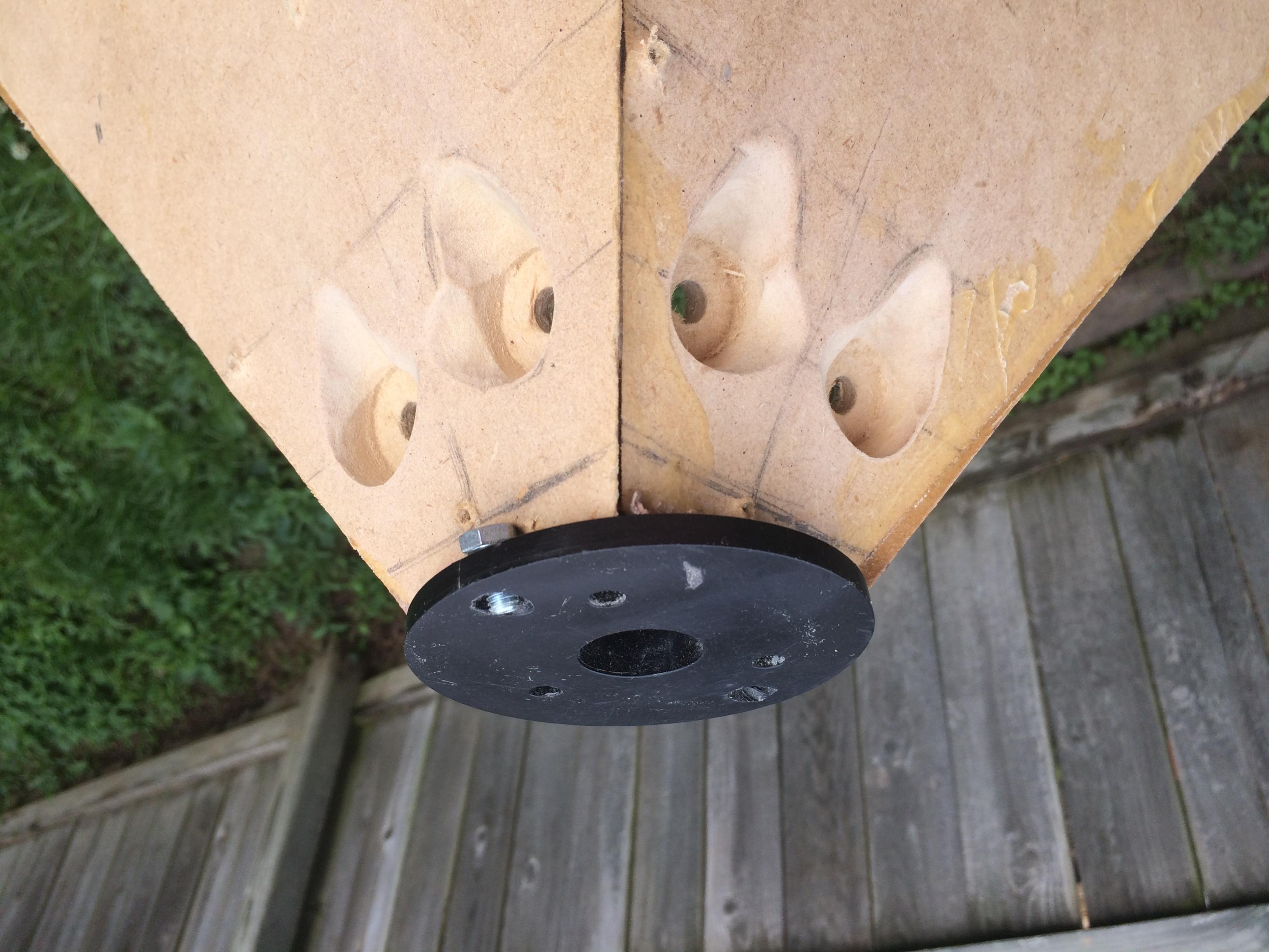

I got some time with my son on Sunday and made some more sawdust for this project. I would love to have built a fullsize horn the first go around but I didn't expect to want to build a 3 way horn (IE SH-50/SH-96 etc) I had planned to build a more traditional speaker that had WW/MT comprised of a Synergy horn. I will be in need of all my best duct tape and bondo skills to get the horn extensions to match up but I am very excited. FYI the Bass driver will be mounted up snug with the mid not where I am holding it.
Steve

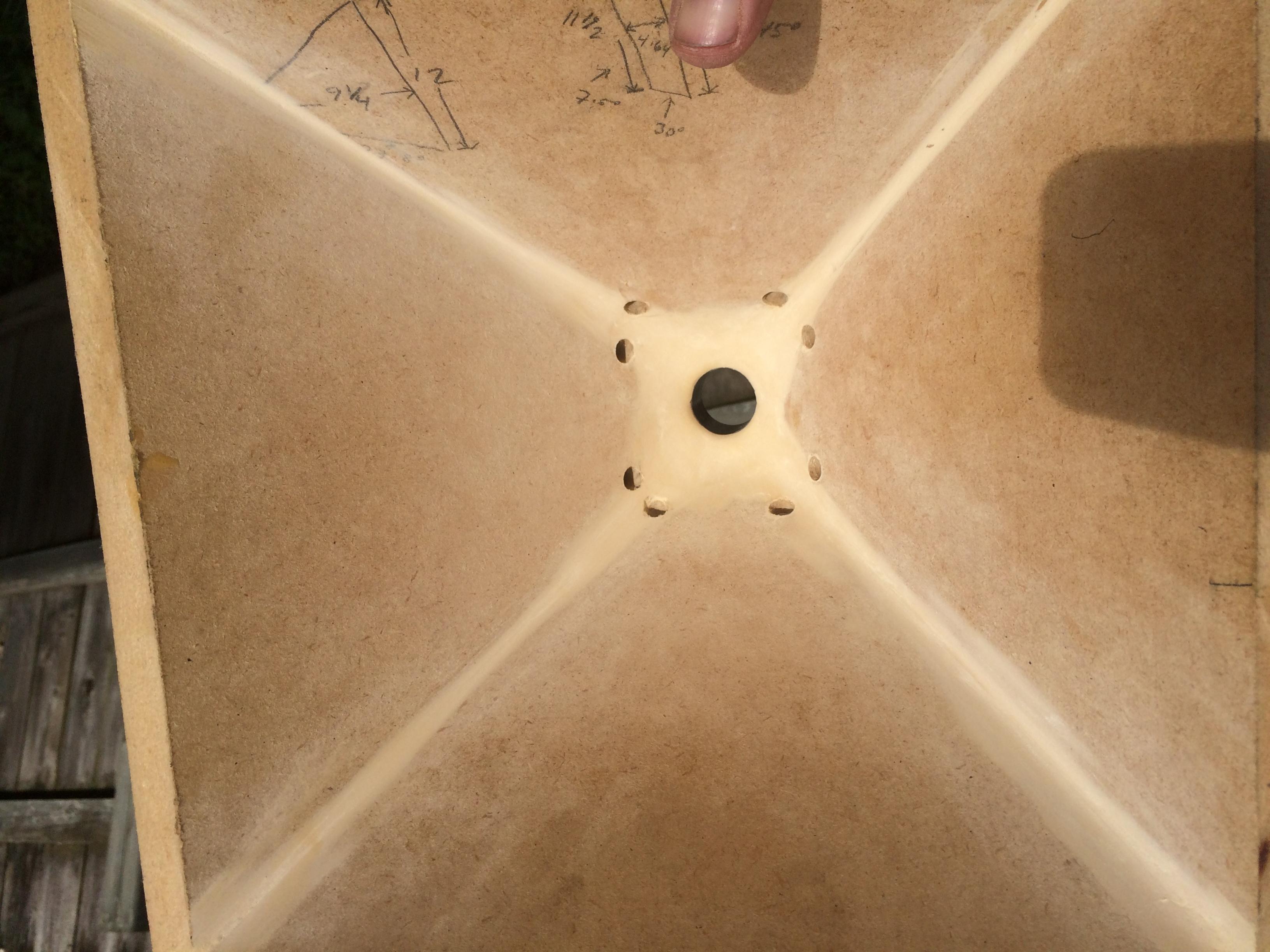

Almost done with both horns. Anybody want to give me some input on hole size for my woofer cutouts? How critical is this hole? I want the woofers to run between 60/80HZ up to 300HZ. My gut says around 2=2.75 inches
Don't bash me guys I know all this can be put into Horn Resp but Im not that type of guy.

Woofer holes are not critical to put in sim. They aren't horn loaded anyways and are essentially band pass woofer holes. The size vs volume of chamber formed by cone will affect your HF extension though. You can always make holes bigger but harder to make smaller. You can add volume plug in cone to reduce volume and increase upper HF extension. Should do that anyway for best performance. 2.75in sounds fine.

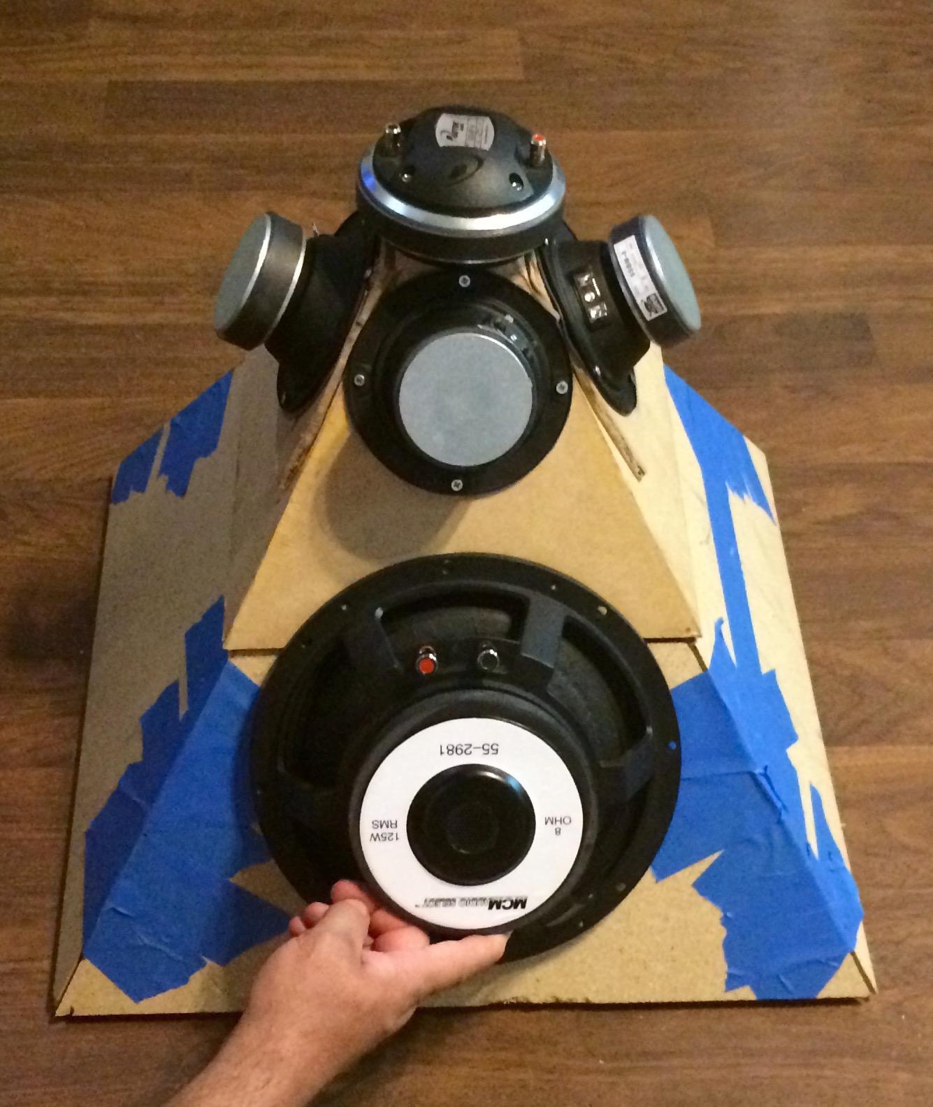

I do not know if I should keep posting here. I have come to think of this thread as a catch all DSL/Synergy Horn resource. I don't think I am building anything that needs it's own build thread. If any body thinks my posting is cluttering up this thread or misplaced please advise me.

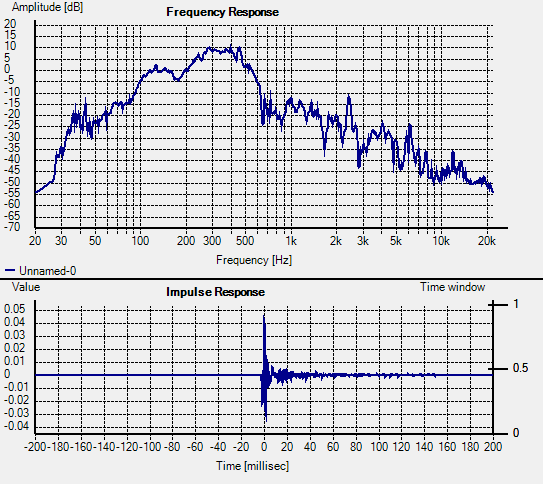

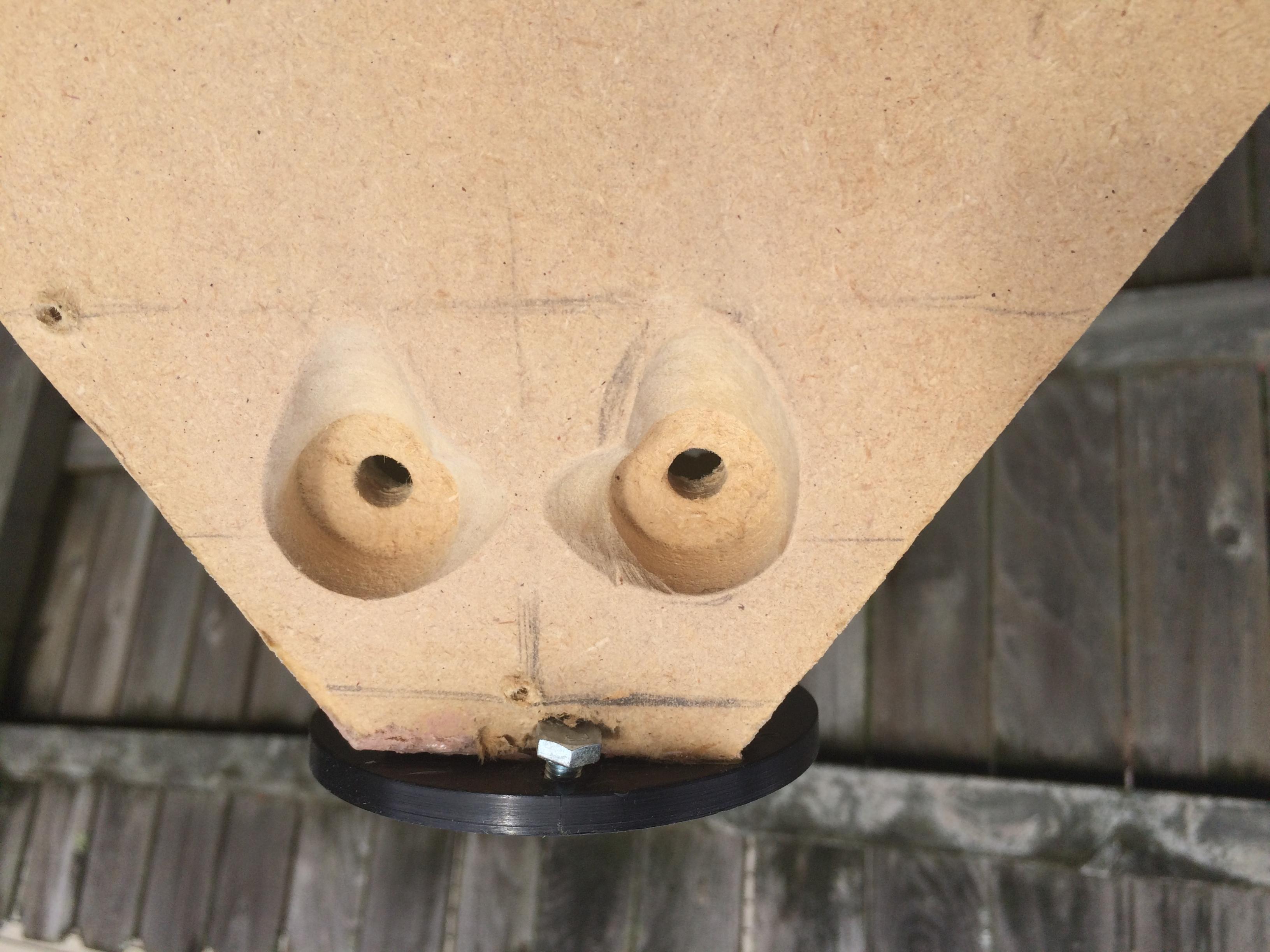

Here is the result of the last few days work on this project.
I added on to the Synergy horn I built last year that only covered to 300Hz. I will now have 2x10 inch bass drivers. I would like to get down below 100Hz from these speakers. The bass driver measurement is without any real box behind the driver. I mounted the woofer and added gasket foam to the backside and screwed down a cheap plastic bucket about the same size as the drivers frame. I will build a box later as I decide how I want to make the final box.
I calculate the air space as 0.25 - 0.3cft. I know there is room to improve here. I have not put the whole thing back together but the bass sounded pretty good on the test tracks with just one woofer!
I still think I could go passive between the woofers and the mids to basically make this speaker bi-amped with my Rane Driverack unit. For right now it will be tri-amped with the MiniDSP and the Rane Driverack.
Looking at the graphs I wonder if I should open up the width of the mid's entry holes? This would filter out some more of the upper freq information IIRC.
Will update as I go along,
Steve
