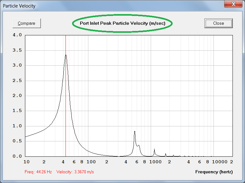

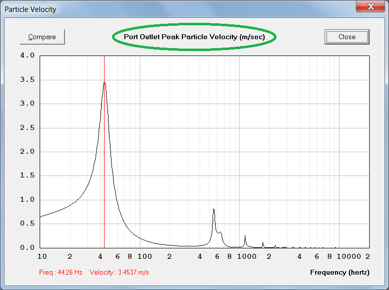

Correct me if I am wrong but hornresp measures velocity at throat or mouth and not at port in or outlet?
Hi Hrmmf,
Hornresp can do both horns and ports.
Port tube inlet and outlet velocity examples attached - note the slight difference in results, as mentioned in my previous message.
Kind regards,
David

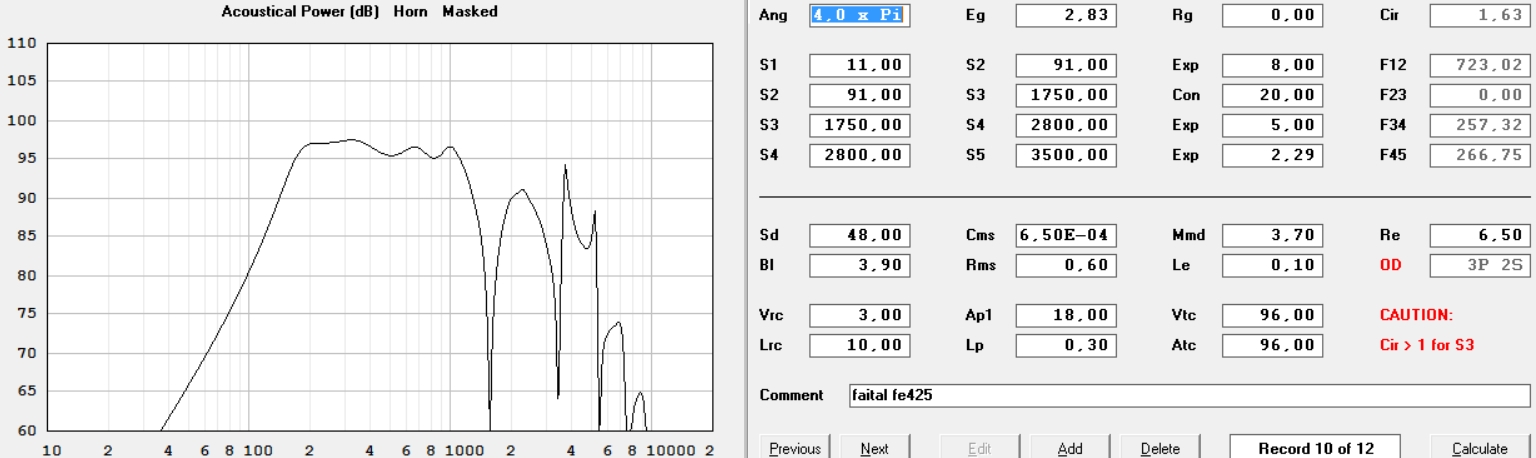

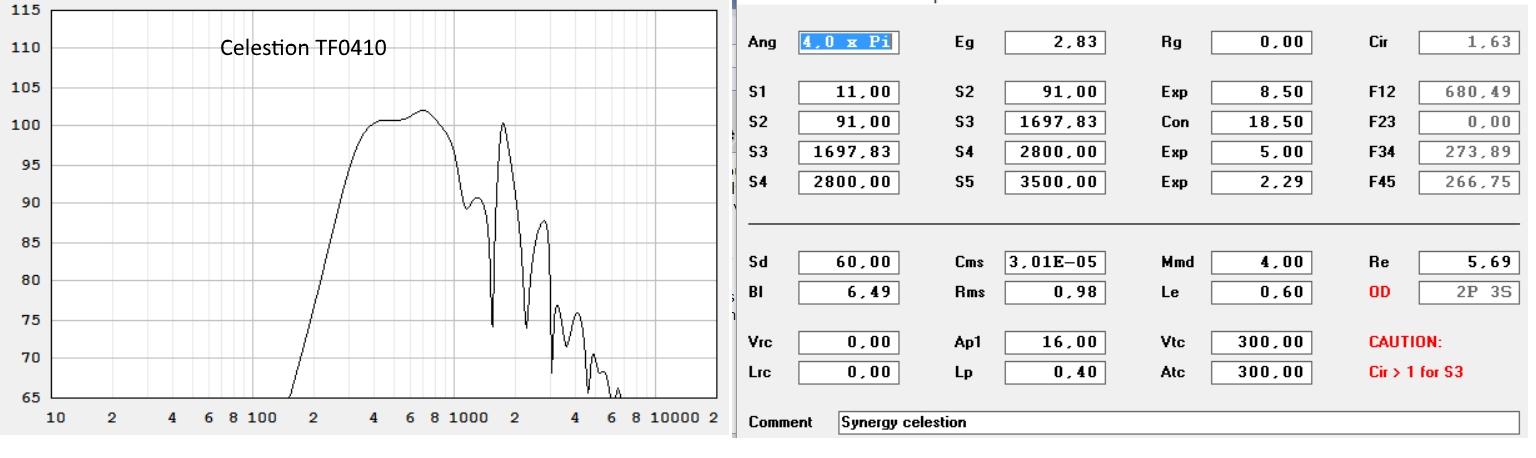

Because of this I started out with copying Paul's hornresp parameters using the Celestion 4" drivers that Paul and several other use for this application, and got this:
Bandwith looks narrow, rolling off earlier than I wish for. But this is maybe what you have to expect when using a fast flaring horn?
Then I tried several other candidates, some did go a bit deeper, some were louder, but the best result I've had so far is the FaitalPro 4FE35:
http://www.faitalpro.com/products/files/4FE35/8/4FE35_datasheet_8.pdf
To me that looks very usable.
Am I on to something, or am I doing something wrong here?
