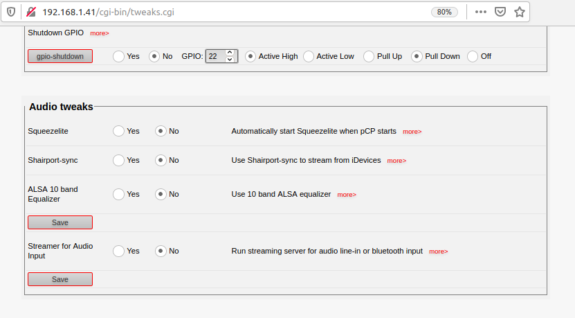

We try one more...
Never give up 😀
I think this could be the case ::
Try to execute ::
Code:
sudo rm /var/run/squeezelite.pid
It look's like the script thinks squeezelite is running, when it's not! Maybe it's the thing...
I think you can start the script after removing this .pid file (if it's exist, i think it does 🙂)
Disable the squeezelite at boot... Then reboot the PI. (See attached picture)
Code:
sudo filetool.sh -b && reboot
Then goto /home/tc/camilladsp
Execute ::
Code:
camilladsp-config.sh example
And ::
Code:
sudo /usr/local/bin/squeezelite-cdsp.sh start
Jesper.

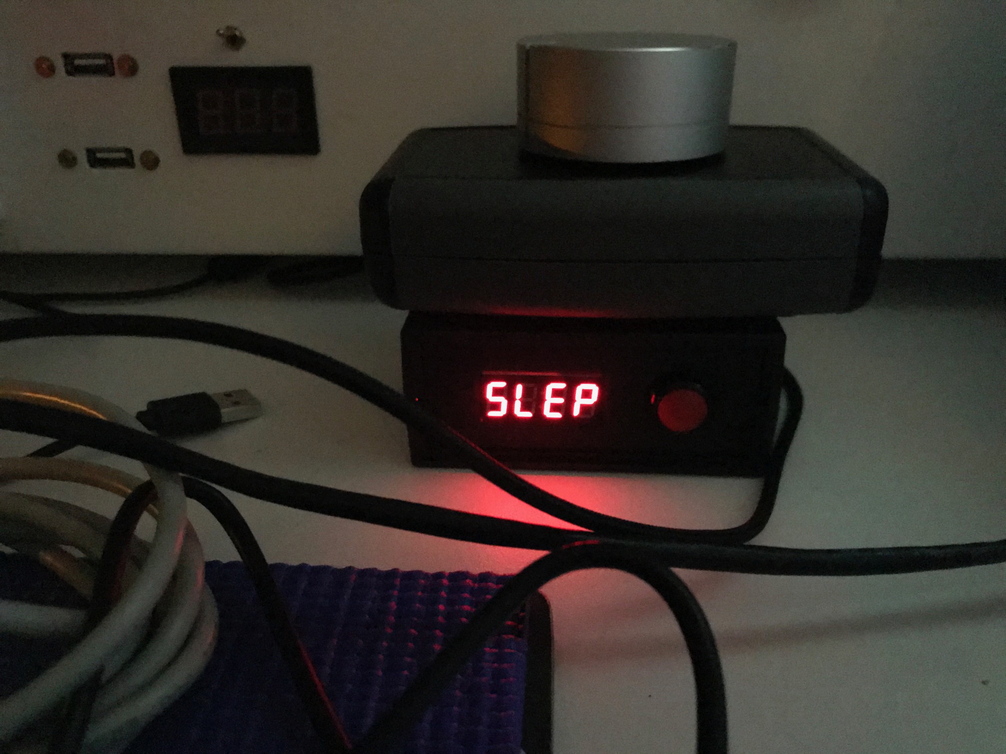

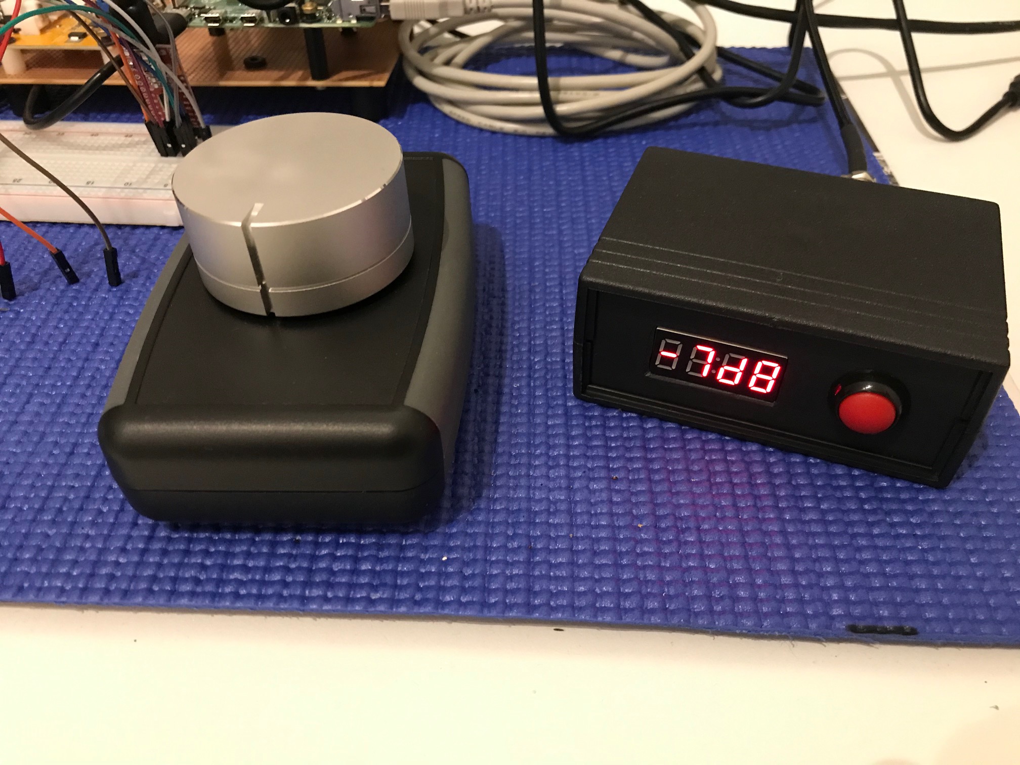

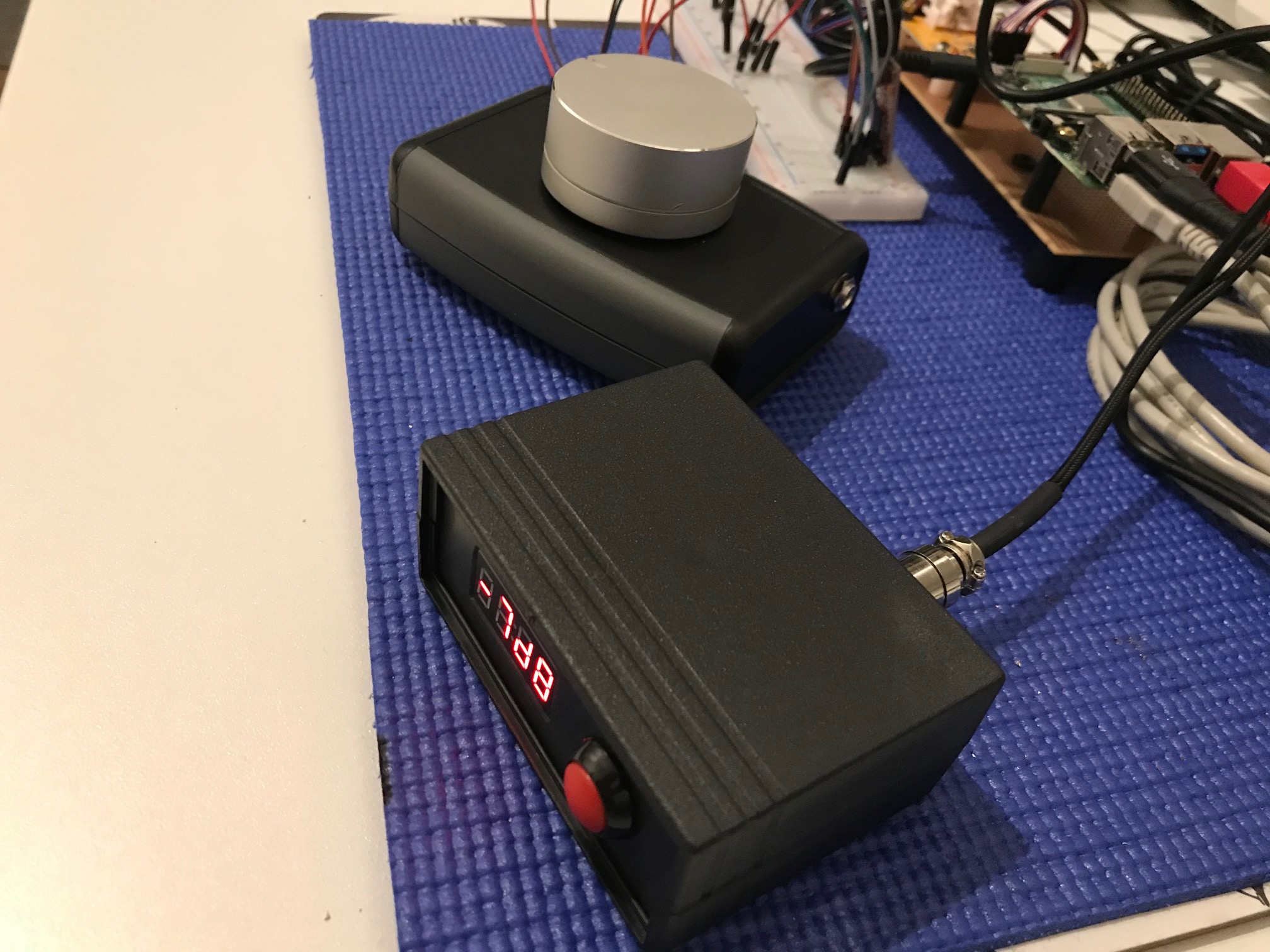

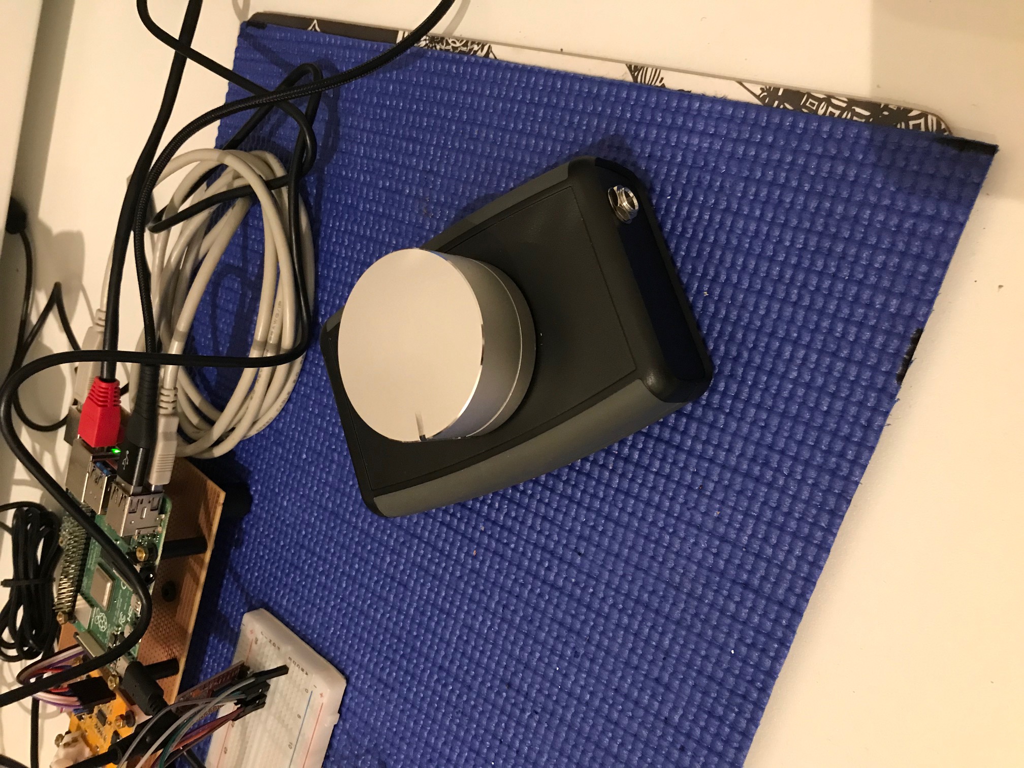

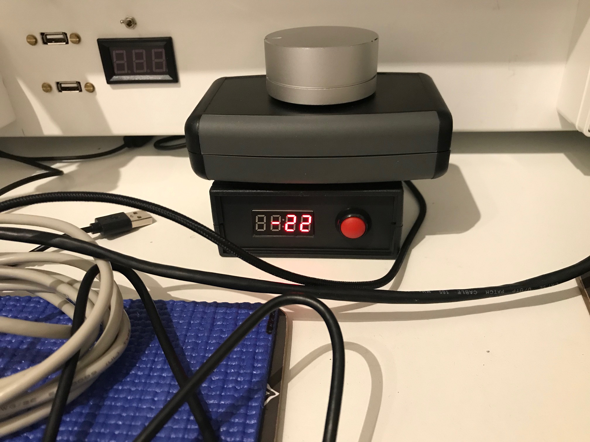

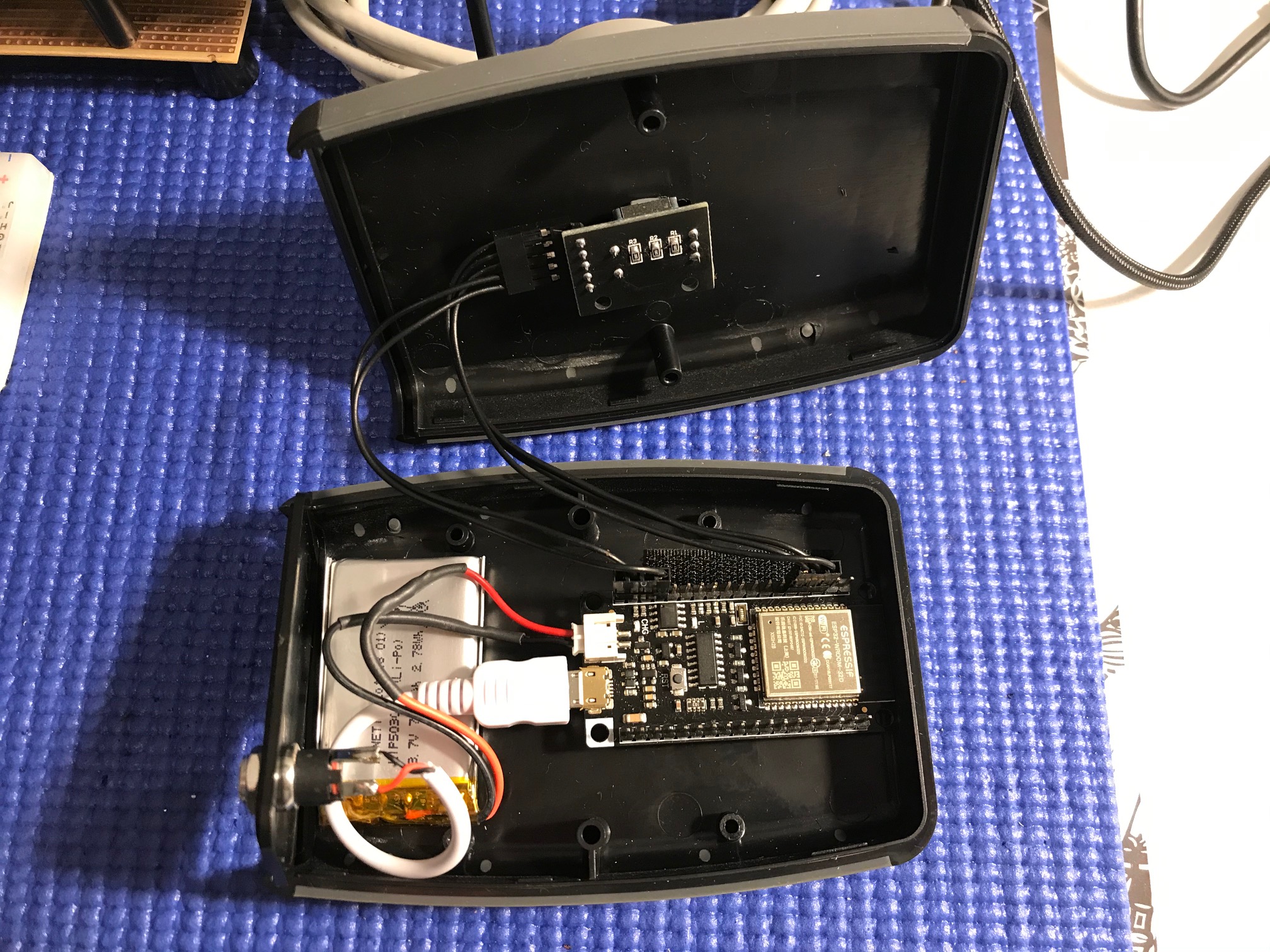

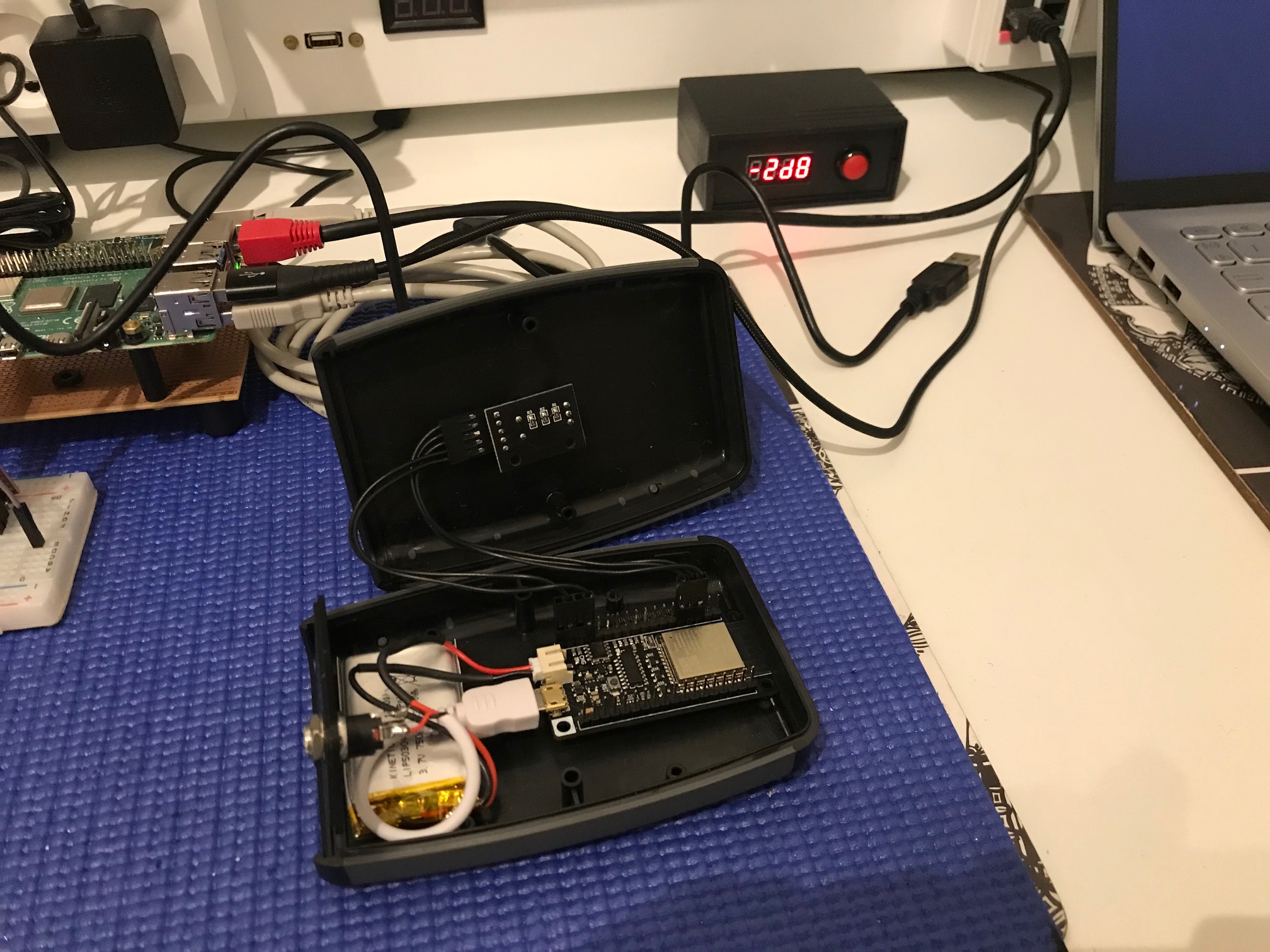

Another thing...
This is much fun to make this Bluetooth LE remote...
It's in real world test phase now 😱
It can do the following now ::
* Play/Pause toggle (Commands send directly to LMS)
* Volume (Either LMS or Camilladsp)
* Display volume on 4 x 7 segment display
* Display "SLEP" -- I now i now SLEP = Sleep 😀 on display when ESP32 is in "deep sleep mode"
I dropped using the RPI as Bluetooth reciever, as it's not working very good when placed inside a metal/alu' chassis like in mine DAC... The range goes very low, say less than 2 meters like that... NoGo!... So i used another ESP32 as reciever insted; this reciever sends through usb/serial to the RPI, and is catched by a python script, which also handles the display on the 7 segments led's...
The display is on the reciever part... It's possible to have this on the remote too, but duo to batteriuse we have to make some switch or like to cut off when not used... I find it much better on reciever end, always on and supplied from my PI in my DAC.
Jesper..
