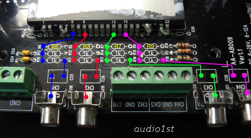

I have been following this Forum for a while now, and finally took the jump and went from a topping tp-10 mk3 to this 4x100w board, with the intention of using it in a bi-amp setup CH1+CH2 for the Left CH3+CH4 for the right.
I have hooked it up to a 24v 14.6A power supply via the terminal blocks and have given it a quick test, all appears to be working correctly and i could hear my source. however my Speaker cone's (kef q3) were visibly resting forwards of their usual resting point (both with a source connected and disconnected). After testing with a multimeter i found these to be the DC offsets (no source connected):
CH1 333mv
CH2 288mv
CH3 -482mv
CH4 136mv
I then tried to adjust these offsets using the trimmers under the heat sink, however the figures were only getting higher (worse).
So my question really is, could i have done (or not done something) something to make these figures be so high? as sure suggest these figures should be under 10mv. Can something be done to correct this offset without sending the board back? my soldering skills are at best - awful!

Hi audio1st,
Thank you for your quick reply!
I have found R6 and R7 (under the heat sink) I guess R8 and R9 are under the daughter board, however R6 and R7 just look like solder is bridging the connections, so I presume that the resistors have been removed, unless I am looking at the wrong resistors?
Is there anything else I could have done incorrectly? I have adjusted the trim pots which has improved the Offset slightly but only by a few mv at best.

Craig, Audio1st, I set my multimeter to 2000m DCV. I unplugged the input into the board. I put the probes on each of the 4 pairs of screws that drive the speaker outputs. I measured 312, 278, 174, -42. Assuming I did that correctly, I wonder if those results are bad. I wonder if other people are getting results like Craig and I. As an aside, I measure my Meanwell delivering 20.5 V at the screws where it ties into the Sure. I have a fairly new board, shipped out just a month ago. Should I unscrew and twist off the heatsink, so I can have a look see at my R6-R9, and I tweak what I assume will be 4 trim pots under there?
Not just you guys. My board gives:
179mV
-50mV
143mV
-296mV
That's just connected to a 12v/20W wall wart, as I don't have the connectors for my 24v SMPS wired up yet.
I wonder if the DC offset was tuned out w/ the 100k resistors to ground, but wasn't tweaked after they were removed. Or -- worse -- maybe the circuit was built around the 100k resistors, and it's no longer possible to tune out the DC without them? Hmm ...
Anybody know if it's safe to run the chips w/o the heatsink so long as there are no input signals? Otherwise, to try to adjust the offset, I guess I need to find a smaller, temporary heat sink just to keep them cool and let me reach the pots.

My board gives the same offset whether input is shorted to ground or not.

I think the DC offset would change somewhat with temperature also.
With these DC offset values, have you played music using the amp anyway?

I hooked it up to some cheapie bookshelf speakers. Enough to say that, yes, it played music, but not enough to tell the quality.
