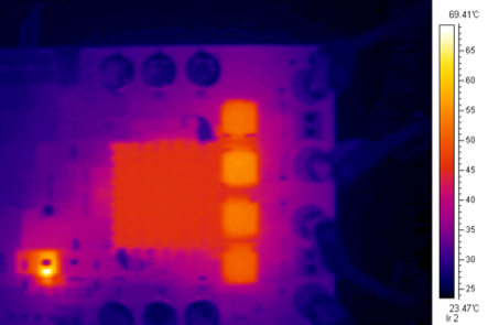

Thermal behaviour
Hi guys,
here is how hot are the Zalman ZM-NB47J and Wurth 4.7µH coils.
I'll mod it as I've done on another pcb, pre-reg at 12V with heatsink, tiny and cheap copper ram heatsink on coils. Will let you see the result. Room at 22°C, 7.5Ω loads, no input signal.

Very good results. Will you test it with 4ohm speakers & high acoustic levels to see how it goes ?
