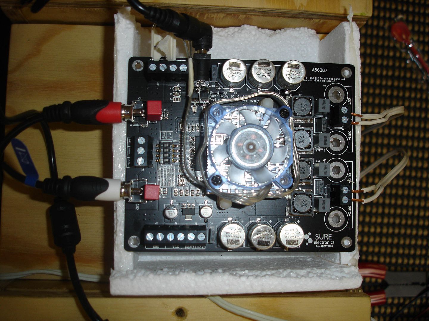

Don't forget to upgrade the heatsink as well.
Pentium 4 heatsink chopped:
Fit's nicely:
The module on the photo is the broken one, still waiting for the replacement.
Fit's nicely:
sayang001 said:Don't forget to upgrade the heatsink as well.
Fit's nicely:

How do you remove the previous heatsink? please outline. Thanks.
audio1st said:I simply added a couple of pieces of bent ally to the fins of the heat-sink. This lowered the temp by 10 degrees C..
what "compound" did u use to hold the ally to the fins?, some sort of glue? I am unsure how people put heatsink on a chip when there are no clips or screw holes.
gychang
Removed the plastic clamps and heated the heatsink with hot air to +/- 70 degrees , then twisted it with my hand. use protective gloves of course. Don't heat to much as you don't want that the tp2050 ic's comes loose as well.

If you have a wide WIMA capacitor, i would just use some sort of extra wires to make the legs reach the hole.
Here are some poor pics of the modding:
http://i78.photobucket.com/albums/j114/wehlami/DSC00188.jpg
http://i78.photobucket.com/albums/j114/wehlami/DSC00189.jpg
http://i78.photobucket.com/albums/j114/wehlami/DSC00191.jpg
http://i78.photobucket.com/albums/j114/wehlami/DSC00194.jpg
The fan spins a bit too fast since its connected to 24Volts. Need to reconnect it with 12Volts so it is silent.
Thanks for the photos whelibob. That makes it clearer, I think I'll be able to figure it out from that.
