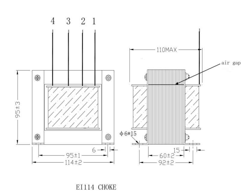

The magnetic force is probably quite large and needs a metal clamp to hold it together. Also it can get warm. I wound hate to see the halves blow apart mid music.
?? How does that happen?
FYI non magnetic SS grade is 321 but you can use a big plastic wire wrap if you are worried.
Hi Daanve,
Not sure why you say it’s nonsense - my choice of going with C or EI core has been per your suggestion. I think I have a suitable clamping system for the core halves. People can discuss using nylon tie wraps but I am not going to use that - as nylon softens at temp and I know these inductors can get warm. I measured 55C when running full power sine wave tests on the LuFo inductor. A lot of questions about whether or not the clamp needs to be non magnetic are here but it’s a non issue if I am using 316SS band clamps.
X
X

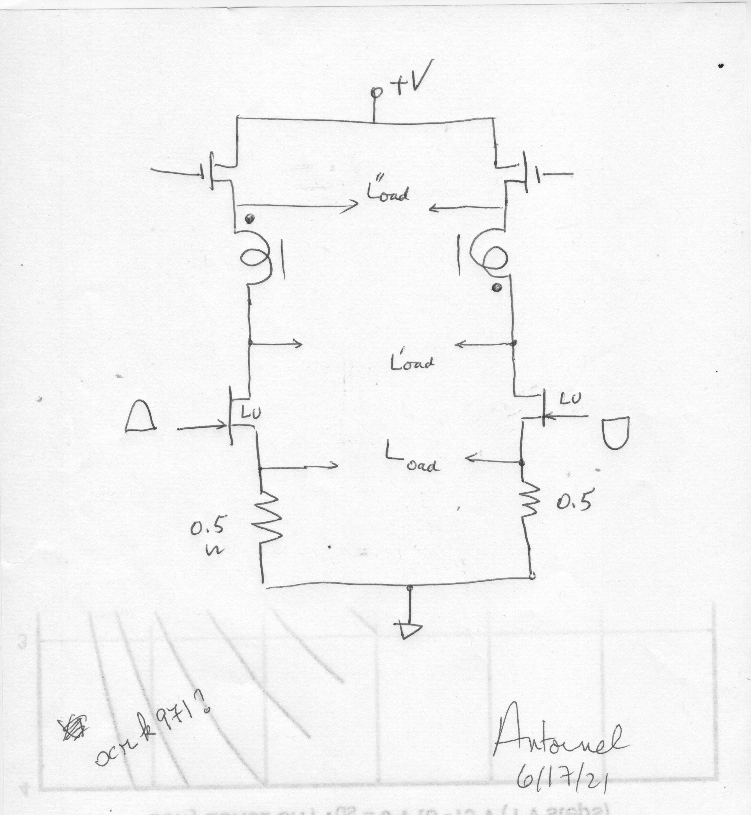

Hello xrk971 and all.
The [SuSy] patent of Mr. Pass continues to spawn ideas and schematics like in post#1. His great works are fascinating.
The attached and simplified schematic shows I moved the transformer from the sources [from post#1] to the drains of LUs.
Is this approach plausible and/or valuable to meet the [SuSy] objective?
Is there a similar value in moving the trafo to the drains of the Mosfets?
Best wishes
Anton
Hi Anton,
Thanks for your proposal of a new position for the inductor. I guess my question is what are you trying to gain by putting it here?
Note that the MOSFET is placed adjacent to the JFET to serve as a cascode to reduce the voltage seen across the JFET drain-to-source. The LU1014D is only rated to 20v. The MOSFETs take the brunt of the voltage drop and associated thermal dissipation and are sort of like a slave to the the little LU1014D which is the master. The LU1014D has special properties of triode like behavior and a high transconductance to give a very low output impedance (high damping factor) amp.
So moving the inductor up between the the cascode elements may negate or minimize the advantage one has with the special properties of the LU1014D JFET.
You should try to simulate it on LTSpice if you are curious.

Plenty of plastic materials get use in transformers, including bobbin wrapping tape.
It doesn't need to be nylon either. A tie wrap melting is as likely as a transformer core 'pulling apart due to magnetic forces'.
Can someone show me a 600VA class core held together with plastic straps, zip ties, whatnot, then? If the clamp band is not sufficiently strong, or tight, the transformer would vibrate like a voice coil with the music. Microwave oven transformers are welded along the joint. They are very quiet.
Hi X,
Just playing the devil's advocate. The concept of using a choke in the follower as a constant current source. It is also to store energy in the magnetic field to power the swing voltage. By hooking up this way to cancel each other's magnetic field, would it mean that there is no magnetic field and hence no energy storage....?
[emoji848]
Oon
[emoji848]
Oon
I asked the same question but apparently from what I understand, this is a trick as old as the hills and is used by push pull tube amps. I think the way to think of it is that the although DC magnetic flux is cancelled, there is still AC magnetic energy and this is out of phase as the sides are anti-phase balanced drive and thus the AC field does not cancel and energy is indeed stored in there and that provides the AC reactance. It’s the DC that causes saturation.
