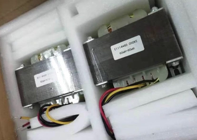

I agree the plates are not perfectly aligned or sloppy. I wonder why they were not squared up before the bolts tightened and varnish or did they come loose during shipment. It was a long journey from Shenzen to Colorado to Virginia.

The manufacturer told me that the laminations moved during transport. It must have gotten a pretty good knock during transport. I think if they had been bolted to a piece of plywood inside a box that would be the ideal way to transport them.

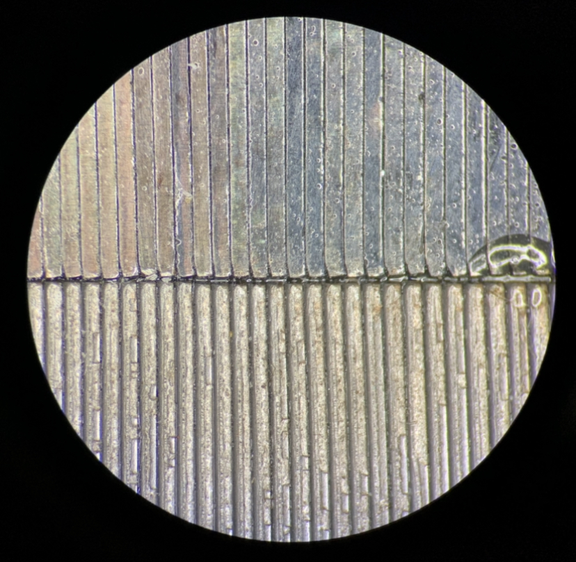

Here is a photo of the airgap under a microscope. I compared with a 0.127mm thick feeler gauge and this appears approximately 0.10mm gap. It’s not consistent though. Maybe there is a shim inside or maybe this is not the the airgap. I am checking with the manufacturer to see if this is air gap.

Here is a photo of the inductors prior to shipping. Looks like they got banged up pretty good despite the foam packaging. Note the laminations are all even. I am told when these ship in bulk by sea, there should not be any issues.

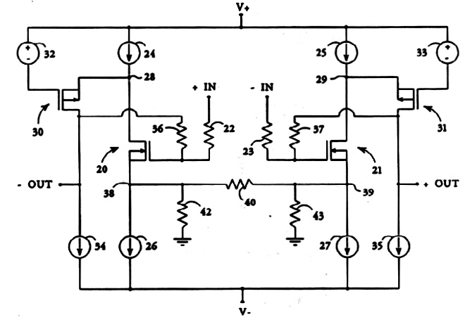

Basically, you are saying replace the choke with a MOSFET set up as a CCS, make two of those amps and connect the output nodes to the speaker in a balanced config without a coupling cap. Balance the bias currents so that net DC of zero volts across speaker load. The inductor provides energy storage and reactance to double the voltage swing. With a MOSFET CCS, there is no doubling so efficiency is less.
If you look at the F3, it is doing this and may be the amp you might want to check out. I think there are plans somewhere to clone the F3 but using LU1014D. The CCS is on top and the LU and cascode on the bottom. Still single rail. I would like to try this amp myself.
You could use something similar to Aleph topology so that the CCS has active push-pull and that can increase the efficiency. It may require an dual rail PSU now and it’s a completely different amp.
![f3_simp.jpg](https://www.firstwatt.com/graphics/f3_simp.jpg)
Well... I see your point as long as you look at the two symmetric sides of the SuSyLu amp as two independent sections. However, they are not. The two chokes wound on the same core work like 1:1 transformer that couples the two sections to each other.
My question is if there is a "coupled dual CCS" circuit that does what the dual choke (yransformer) does in the AC domain.

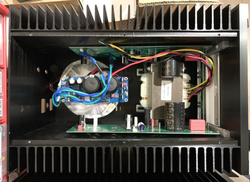

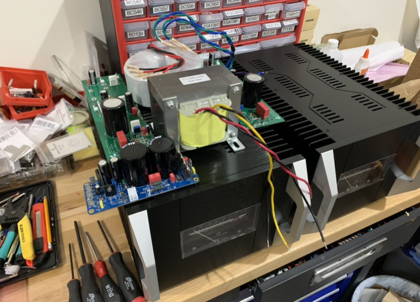

This is going going to be a tight fit to squeeze all this into this monoblock chassis.
Two LuFo boards (can skip the 10,000uF coupling cap), 400VA to 500VA toroidal trafo, a single rail SLB PSU for 6A continuous operation, the custom dual winding balanced choke, a SSR relay DC output protection board, a soft start board, and the VU meter driver board. The front end board will on mezzanine on the main LuFo boards. I hope it’s not too close to the power trafo.
Major components:
Shoehorned inside:
Each side will weigh about 45 lbs.
Major components:
Shoehorned inside:
