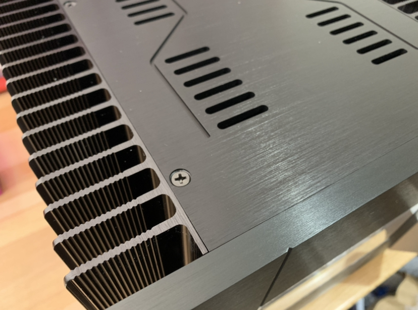

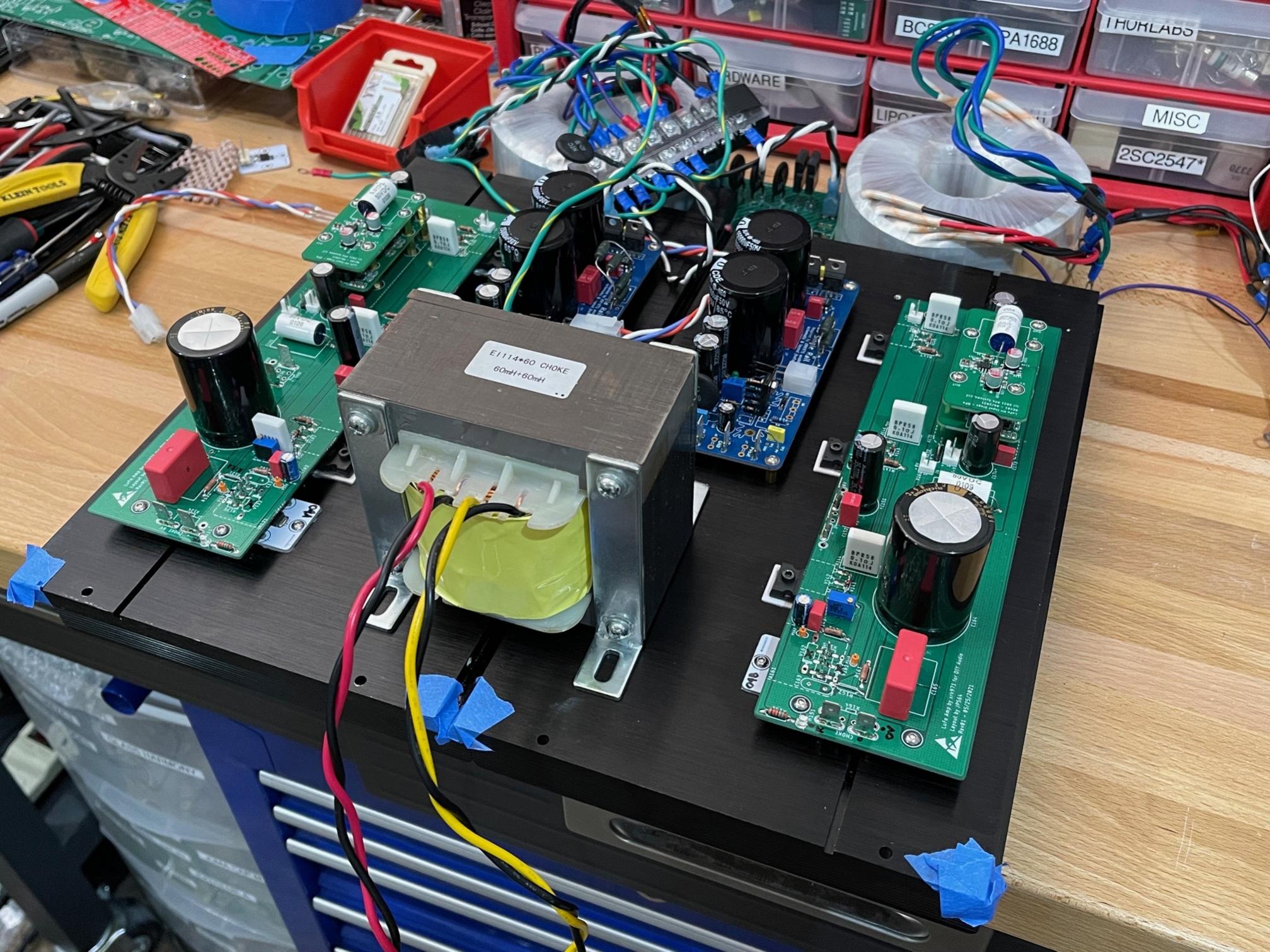

This is going going to be a tight fit to squeeze all this into this monoblock chassis.
Two LuFo boards (can skip the 10,000uF coupling cap), 400VA to 500VA toroidal trafo, a single rail SLB PSU for 6A continuous operation, the custom dual winding balanced choke, a SSR relay DC output protection board, a soft start board, and the VU meter driver board. The front end board will on mezzanine on the main LuFo boards. I hope it’s not too close to the power trafo.
Major components:
Shoehorned inside:
Each side will weigh about 45 lbs.
A link to those nice looking cabinets ?
No where close to working. Just placing components to see if everything fits.
Here’s the link to the monoblock chassis. These are extremely well made. Everything fits perfectly (probably all made by a robot and CAM) and it was packed carefully and shipped via DHL express.
For example, look at the interfaces between the front panel, heatsink, top cover and screw and how tight and flush all the joints sre.
Sorry about that. Try this:
2PCS MC2620 Mono Aluminium Chassis Split Amplifier Class A Amplifier Chassis|Amplifier| - AliExpress

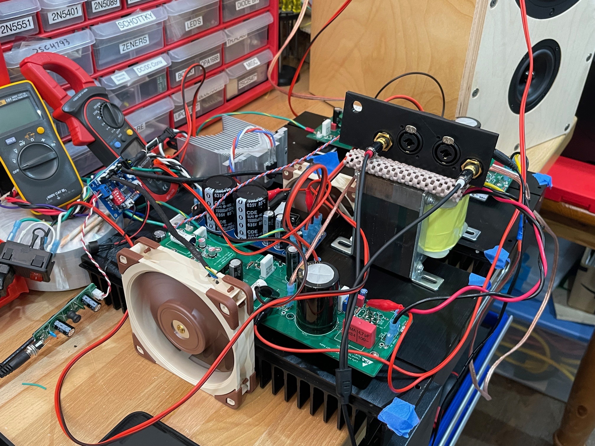

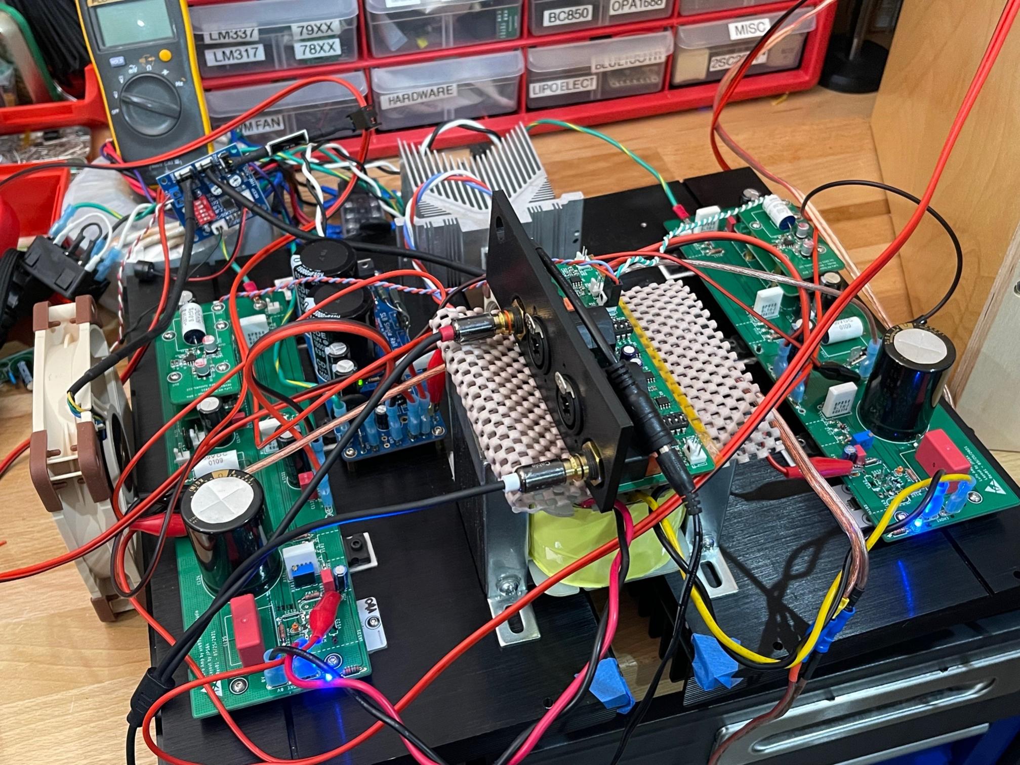

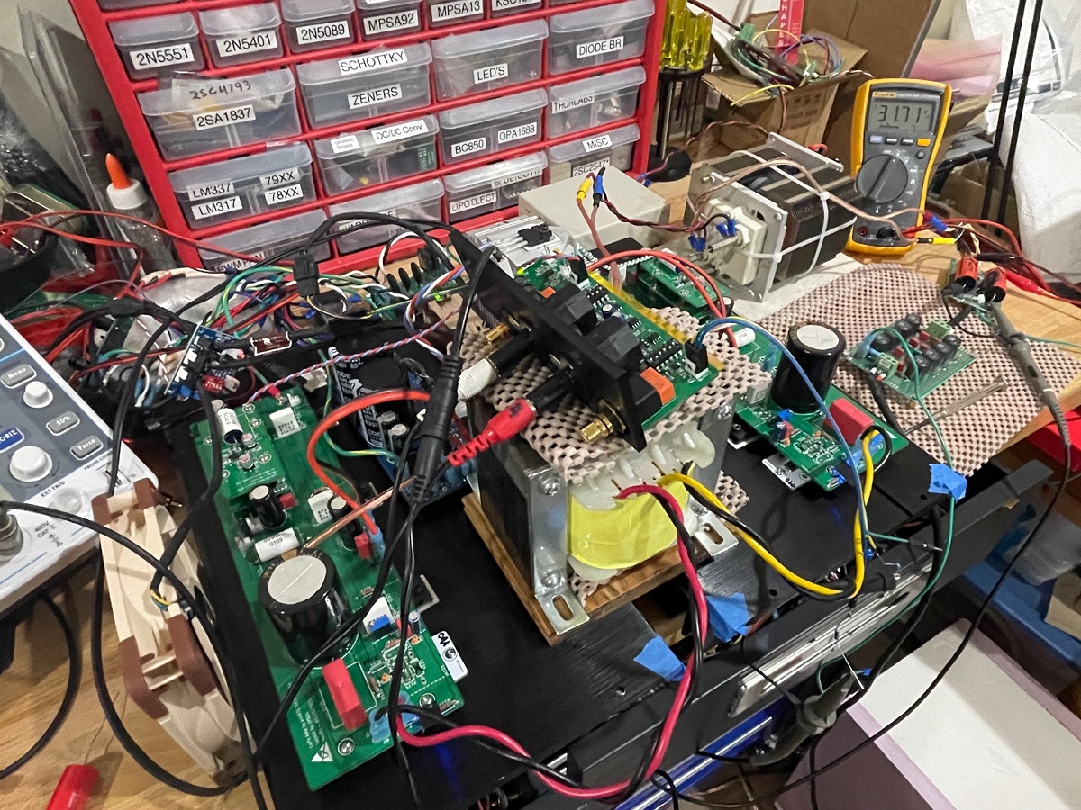

Initial testing of SuSyLu using two LuFo modules connected with a common bifilar wound choke in anti phase is looking very promising. The input balanced signal is provided by the BTSB SE/Bal to SE/Bal input buffer module. I am able to achieve stable bias current settings with DC offsets under 10mV, typically closer to 2mV. Current in each leg is 3.0A and rail voltage is 27.6v from common SLB PSU (active LT4320 bridge with CRC and cap multiplier) with a solid state soft start circuit upstream. Main power is provided by an (undersized) Antek AS-4224 toroidal trafo for both legs. A larger 600VA custom toroidal trafo is on the way as well as a custom Class A SMPS to evaluate which power source is better. No turn on or off thump detected. Still running with output capacitors for now until I am certain DC offsets are stable with longer duration testing. The sound is very powerful and dynamic. Background noise is silent with music not playing. When connected to inefficient 82.4dB sensitive speakers, I can drive it very loud and no sign of inductor saturation distortion / dynamic clipping is observable. Bass is very impressive for a SE Class A amp.

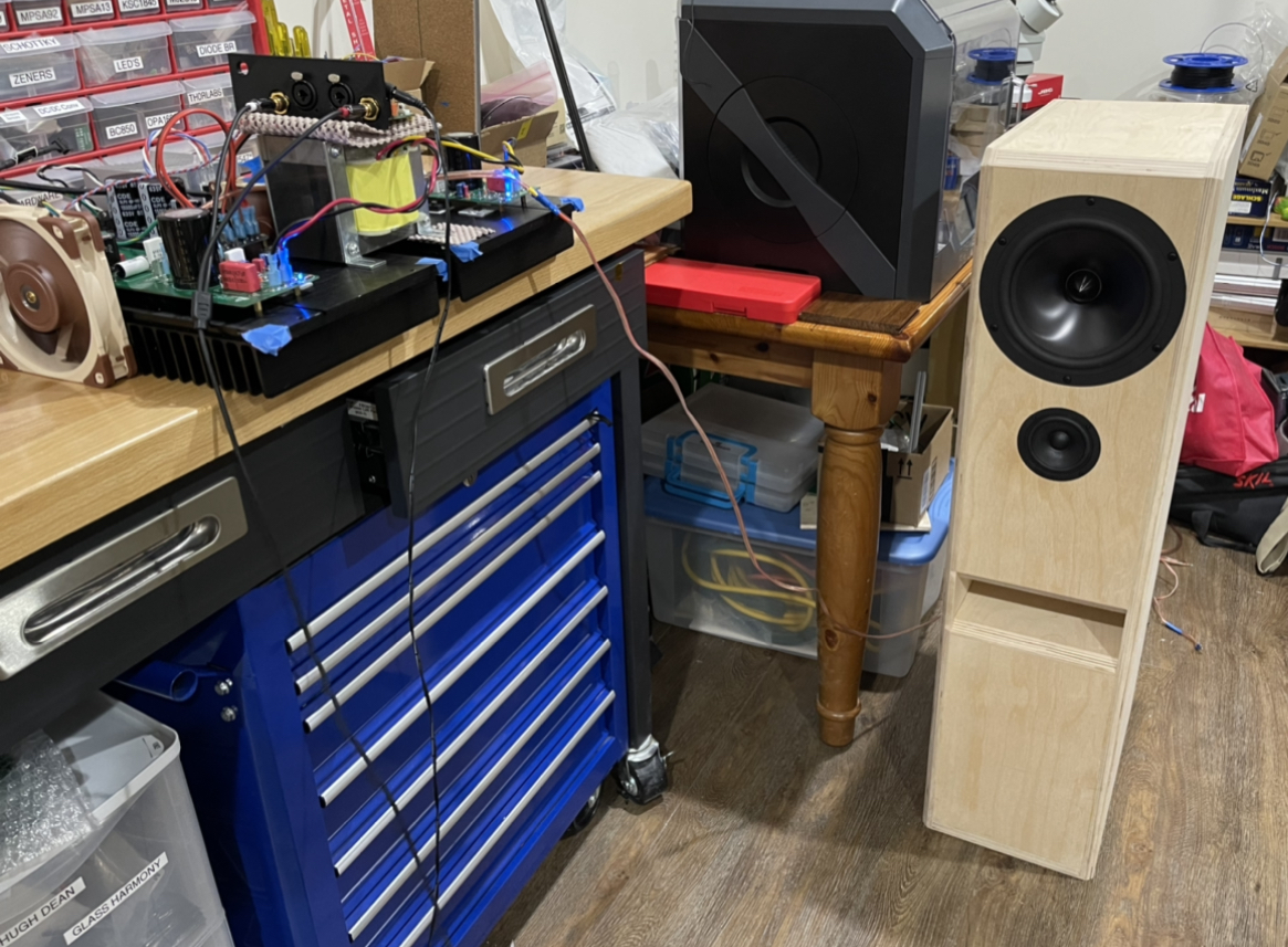

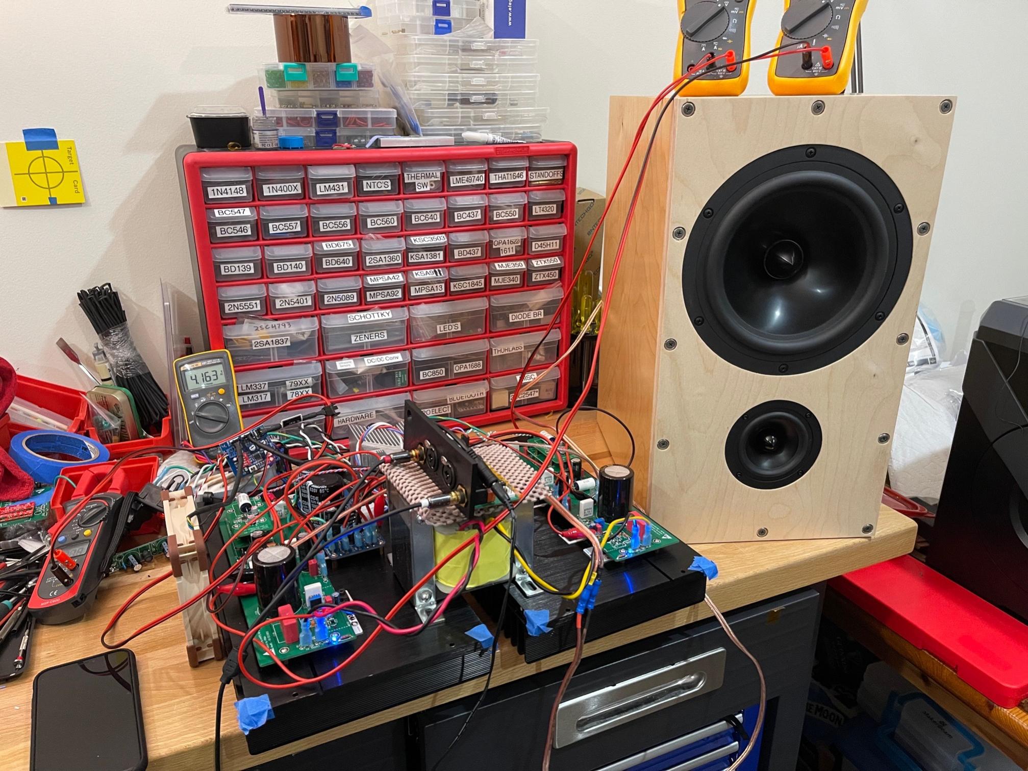

Here is a test setup to check for max output power into an air cooled 300w 10ohm EBG UXP-300 power resistor dummy load. Driven by an Akitika 2ppm 1kHz oscillator into a BTSB SE to Bal buffer, then driving the SuSyLu with OPA454 input stage.
Here is a photo of the test setup:

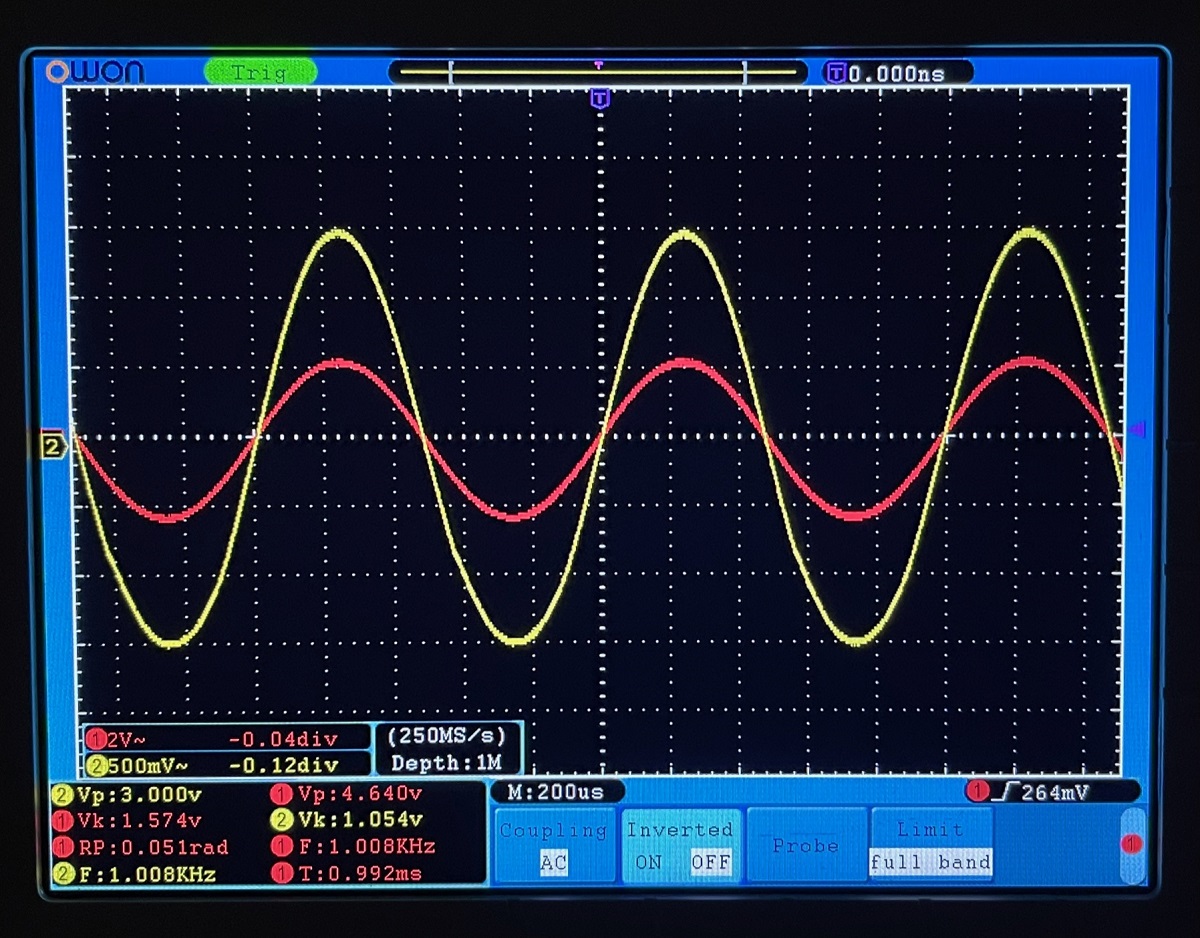

The red trace is the output of the BTSB buffer (balanced output) that the SuSyLu amp with front end sees. The yellow trace is the amp output after a resistive balanced divider and AC coupling caps (remember that this is a BTL output so I cannot connect the ground of my amp to any of the amp's outputs directly). According to the scope, the input signal for max output is 4.64Vpp. The output amplitude has been attenuated but the shape is correct. We will look at the Fluke 115 Vrms reading at the load resistor as 31.7Vrms, or 89.7Vpp into 10ohms. The rail voltage is 27.6Vdc (same on both legs) and bias current is 3.05A on each leg. It is pretty cool to see 90Vpp output from a 28v single rail amp. The calculated overall gain of the amp is thus 25.7dB - I think the output stage is a tad below 0dB. Note that the amp is zero global negative feedback, the feedback is only at the OAP454 front end to set the gain.
O-scope traces:
Close inspection of the output trace appears to show a slight distortion asymmetry on the falling (left side) edge of the wave about 2/3rds down - almost a slight kink in the curve. But this is asking the amp to put out max swing to demonstrate that it hits 100w.
Here is a closeup of the load resistor and Fluke DMM reading. The fancy filter there is a very high order passive 100kHz low pass filter I had made for measuring class D amps - for when I take the FFT readings to come later:
The load resistor defintely needed fan cooling - it was blowing a lot of heat out. Let's look at the thermal efficiency. We have 27.6v rail x 6.1A = 168W of thermal input into the amp (not including the losses from the cap Mx in the PSU); we have 31.7Vrms into 10ohm load or 100.5Wrms. Efficiency is 100.5W/168W = 60%. That is almost approaching theoretical max of Class AB amp.

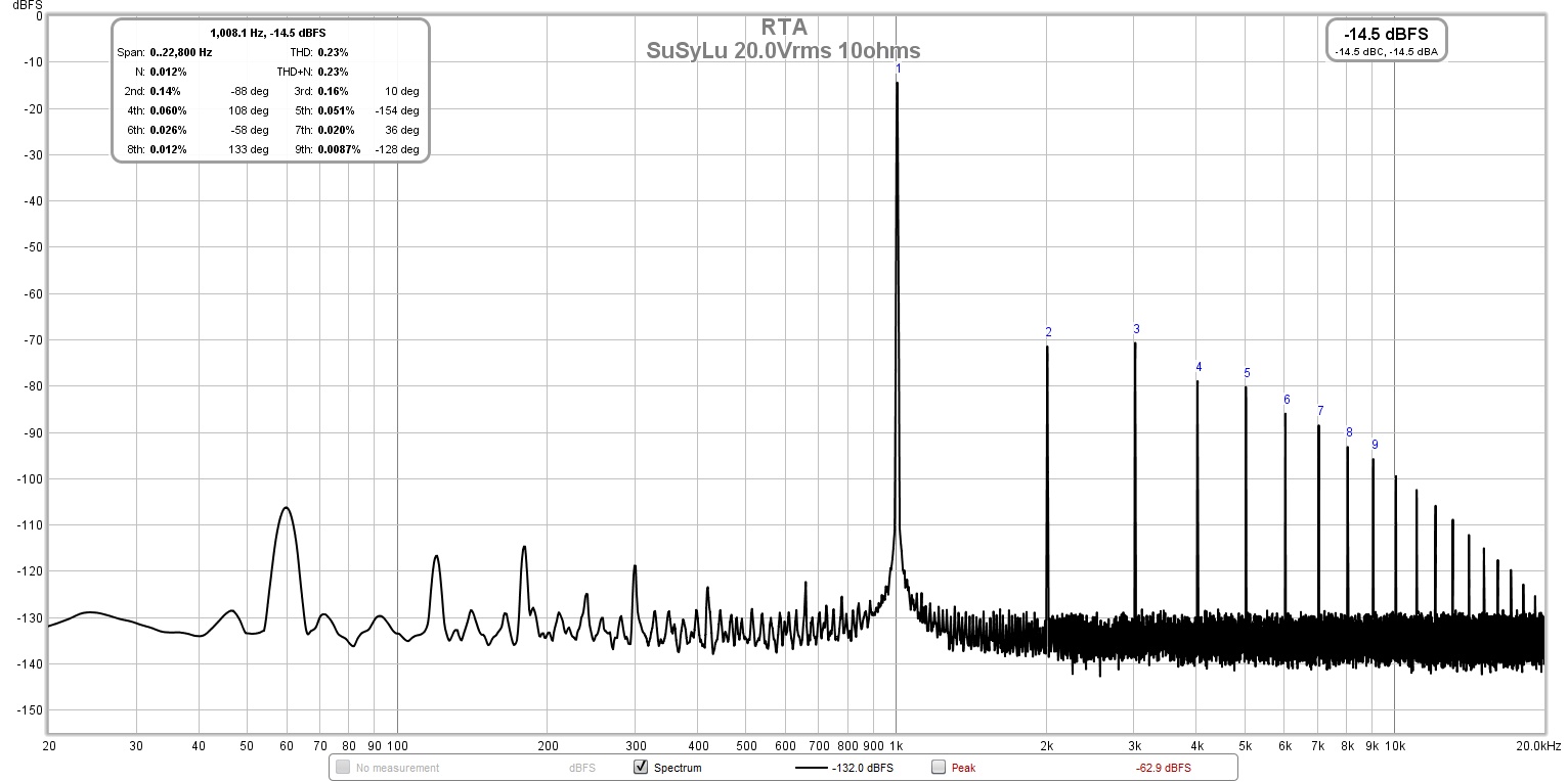

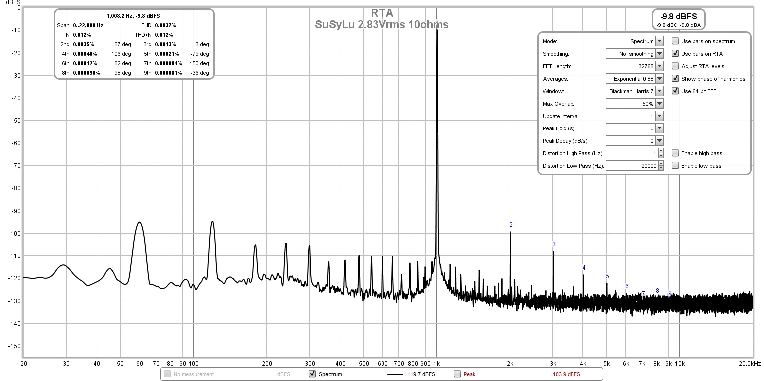

Some initial FFT measurements show that the topology works at reducing overall harmonic distortion. For 2.83vrms into 10ohms, the THD is now 0.0037% vs 0.01% for a single LuFo:
Although this is not as low as predicted in Post 1, the good news is that the harmonic profile is excellent with a dominant second harmonic and monotonically descending higher orders. I suspect that the higher second harmonic and higher overall THD is probably due to imperfect device matching. But I don't think that the increase in THD is bad given the nice profile it yielded.

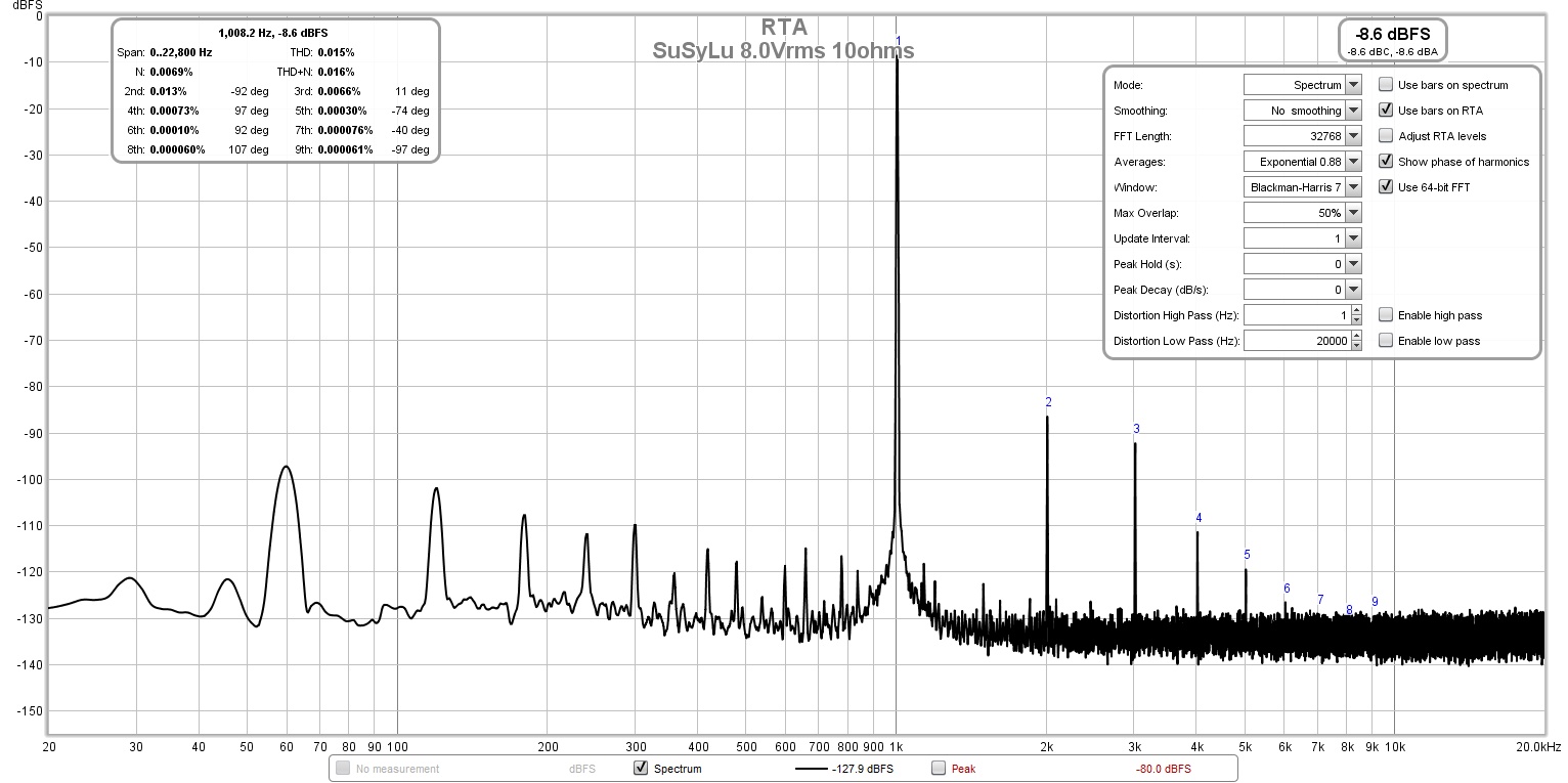

Even at a (domestically loud 8.0Vrms or 8w) the harmonic profile is still excellent and the THD is only 0.015%:
At 20.0Vrms, the harmonic profile is starting to switch over to dominant 3rd order and looking a little rough with THD at 0.23%. however, the profile is still monotonically descending higher orders:
I need to work on the PSU as the 6.1A of current through the SLB does not appear to be smoothing the mains peaks at 60/120Hz, or I have a mild ground loop somewher.
