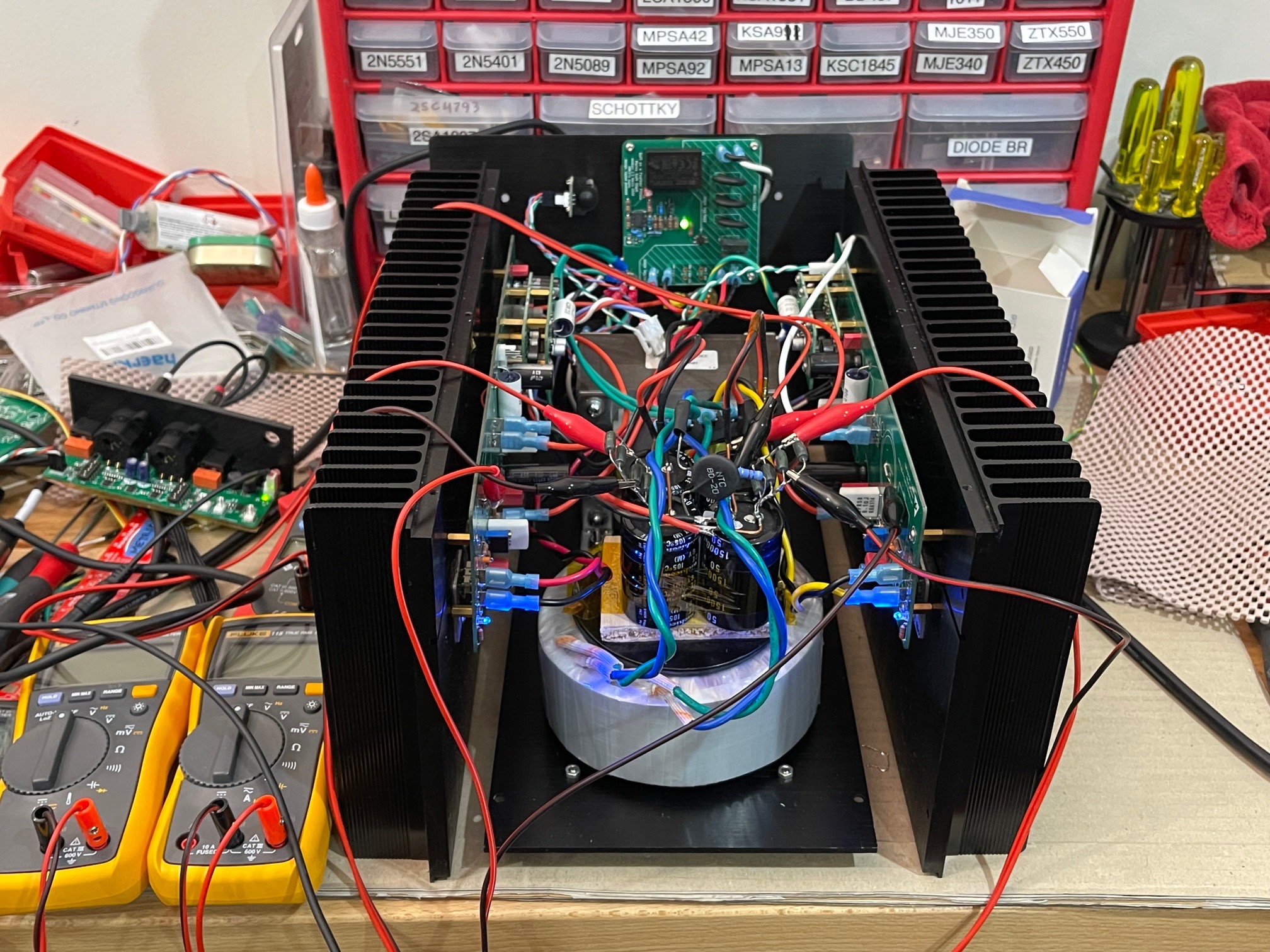

Putting the two SLBs back to back and sideways allows it to fit in this tight chassis. A dry fit without all panels bolted together is yielding higher noise already than when laid flat. Fluke 101 now reads 0.4mV rms. I can hear a little buzz - much less than before. So now the ground loop is solved but there is some spatial EMI effects of the amp going from flat to compact box. More debugging ahead.
We could try flipping the floor panel orientation 180deg. As I recall, that dropped the noise about 0.4mV or so last time. It moves the linear toroidal to the front away from the front end boards.
Having all boards with connectors (Fastons, Molex MiniFit, and Molex KK) make all of this moving around much easier than soldered flying leads during amp prototype development.

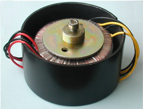

If you stick with the Antek, one of these might help. Link is here. Unfortunately, the 400 VA size seems to be out of stock at the moment.

The noise as measured with Fluke 101 measures 0.1mV rms and speaker is quiet with ear pressed to cone. This is looking really promising but pushing everything back together as a small “box” may prove to reintroduce EMI induced buzz/hum. We are making progress though.
Photos show noise as measured on Fluke 101 in mV AC mode (closely matches audible buzz/hum and 0.1mV is acceptable close to silence). Photo also shows where ground pin was moved from and to.

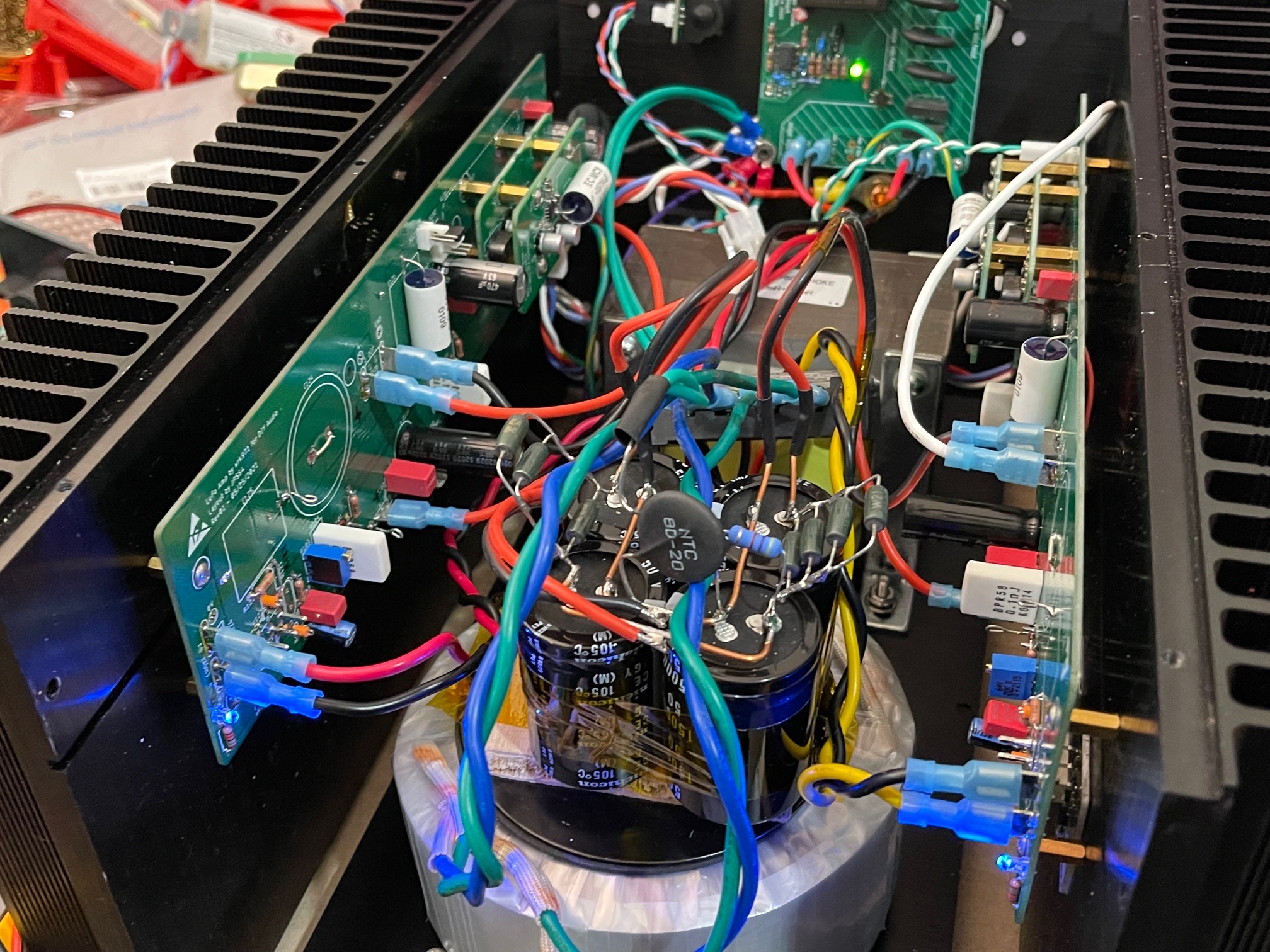

I have a custom 600VA toroidal trafo on the way. It’s much smaller than the 400VA Antek (better core material). The back panel is fully populated with jacks. Moving to the front is better as input boards are towards the rear. Standing the Antek on its side would only fit sideways (axis left to right) as space is tight with amps on the walls. I also have a SMPS coming soon. Will try all of them. The design should have inherently good PSRR, maybe a basic CRC of sufficient size is all that’s needed. I am surprised that the ground loop hum was worse with one PSU vs two PSUs.
The grounding is all controlled to star hub on back panel as can be seen in the photo. The only thing different with amp in box shape is vertical heatsinks place amp PCB closer to trafo. The longish amp board may have a larger than optimal loop area and it’s perhaps picking up EMI. The long PCB was to spread out the MOSFETs. All design space considerations. And we don’t know the problems until we assemble the amp and go through what I am doing now.
Hi Wtnh,
Thanks for the info on the steel cover. That might be very useful. I think the 300VA one might actually fit the new custom toroidal that is on its way. I’ll have to check the final dimensions once it arrives. I just got a tracking number saying it has been shipped. That cover looks substantially thick and may block a significant amount of magnetic interference.
The 300VA one is 5.3in dia x 3.75in high.

So I think the noise is simply radiated magnetic fields picked up by the amp board layout or wiring.

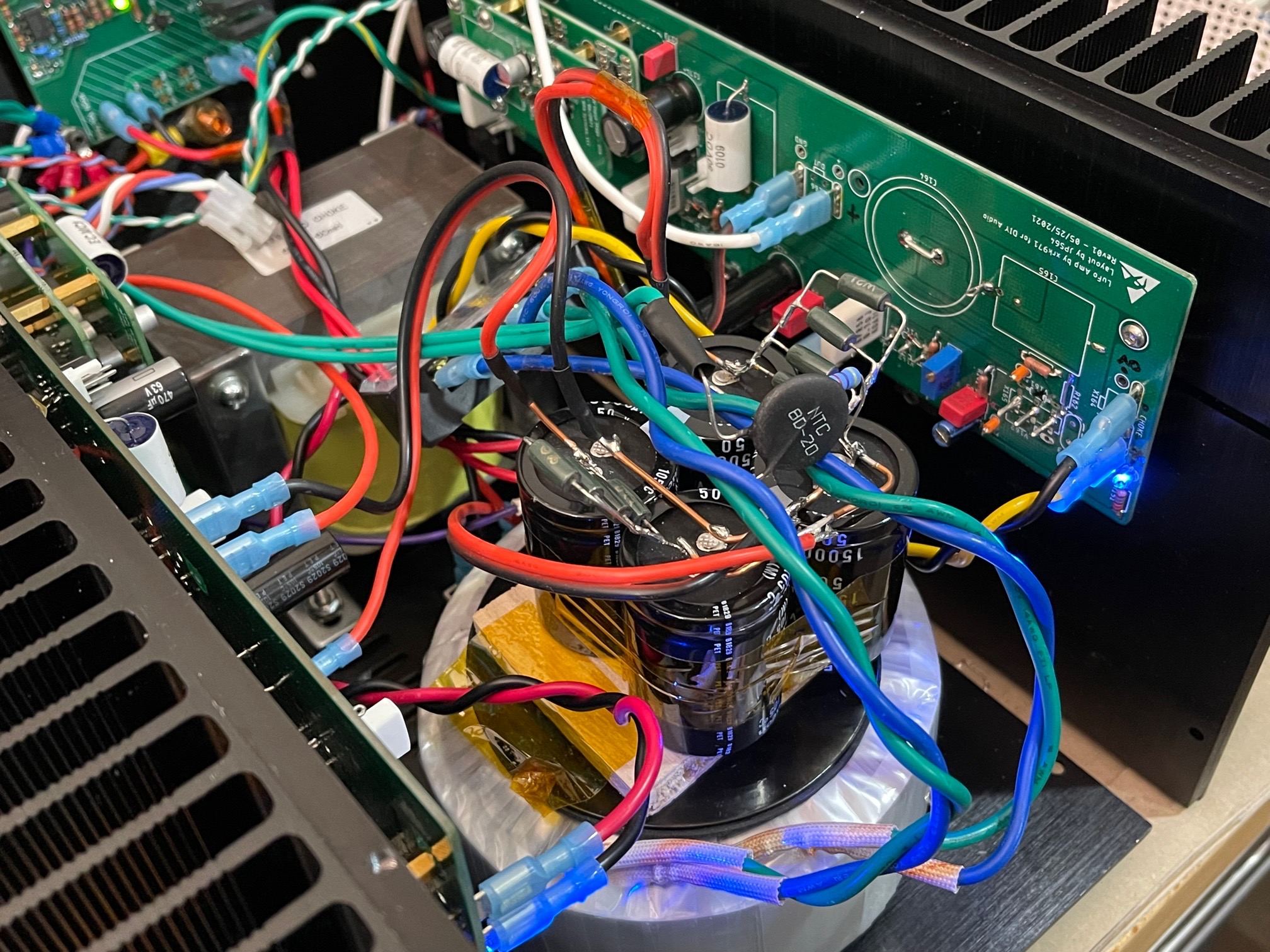

Checking out amp with basic CRC (15,000uF // 2x 0.33R parallel // 15,000uF) per leg. Amp is quiet without audio input from TRS balanced input. But ground loop appears when connected. Photo shows 4 resistors but I eventually removed 2.

With CRC and no audio input connected I was getting 0.2mV rms noise with Fluke 101. Hum was not audible from speaker with ear 2in away from cone.

Yes, chassis/mains earth (dirty) ground is isolated from 0v PSU (clean) ground via 8D-20 (8ohm) NTC. Standard practice in all my amps.
I don’t have a hum breaker resistor in the input. It’s a daughter board on the main board but the ground is tied to main PCB ground plane. This ground is connected to the PSU clean ground at the clean ground star hub on the CRC. We are looking carefully at the grounding of the input amp board and suspect the issue is somewhere here. I think the issue may be the fact that the input stage boards need to be on a separate common board so that they have low impedance ground in between them. Their low impedance outputs are then sent or the output stage PCBs. This can be tested by removing the on board HV amp daughterboards and placing them on a separate single board with common ground. Then connecting the output of that to the modules mounted on the heatsinks.
The balanced input has +ve and -ve and common shield. The common shield is shared to the two grounds of the input boards. Connecting the common grounds did no cause hum. When more than 1 signal +ve or -ve is connected, there is hum.
I also tried connecting the balanced input ground from the TRS jack to the CRC clean ground star hub and that made things worse.
