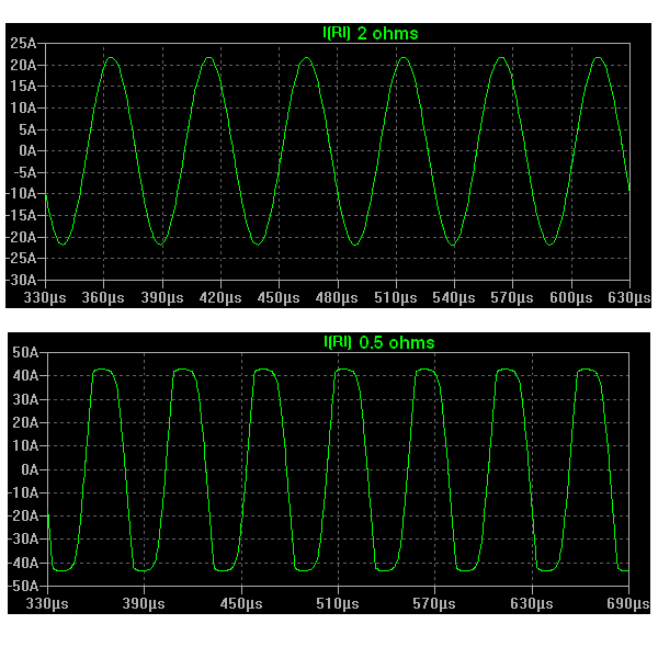

Rafael.luc said:In my version, short circuit protection begins work under 1 ohm load ouput, not affect the bass.
Good to see a schematic with some degree of protection featured. Most never try to include it, which is why I always layout my own pcb’s with it added.
However, I don’t understand how this arrangement will work. It seems to me that, with the values given, the protection transistor will trigger only when an output device tries to pass around 30A at any Vce; in other words, a horizontal locus parallel to the Vce axis at Ic = 30A.
Or have I completely misunderstood what it is intended for?
Brian.
Brian.
The operation is simple, resistors of the transistors output and most the resistor from the base of the transistor short-circuit, form a divider, from certain value the transistor begins to conduct, short-circuit input base of predriver, the values of resitores adjusted in simulator the value is 40 A, not to interfere in bass, attached simulation.
