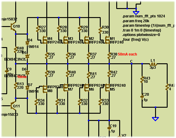

Now we're talking. This is going to be the Mosfet thing?... and have a 350/500w version
By hbarske - This is going to be the Mosfet thing?
Yes , I know it might offend the "purists" , but I am no fan of 6 pair OPS's. For my purposes 3 pair of IRF's will do , as I use mine for the full range speakers.
This will be a different "beast" with a separate OP board /.. - plugin input /VAS "daughtercard". No way to build myself into a corner anymore with a interchangable low current module. It will be easy to power it with a separate supply and all the extra room on the High current board will allow for 20kuf X 2 and fuses!!!
My daughtercard will allow me to bring this design "all the way" with
cascode/fet , maybe even SMD's.
OS
PS - 4-5 pair will do 400-500 / 700-800 !! ha ha
better have a 1500VA trafo @ 55-0-55vac
Sounds good. So this will be scalable in terms of power just by doing an output board with the desired number of Mosfets?
I don't have no probs with IRFPs in the output, the more "beast", the better. I am looking for something with the power of an Alto D3 and the sound of a SymAsym.

What about an board that can take for example 10 pairs maximum, and if you want less, you can cut it to the desired size?And everyone can decide for themselves how many transistors they want
PCB MOSFET OS....
PCB ....MOSFET variant , more power ....
