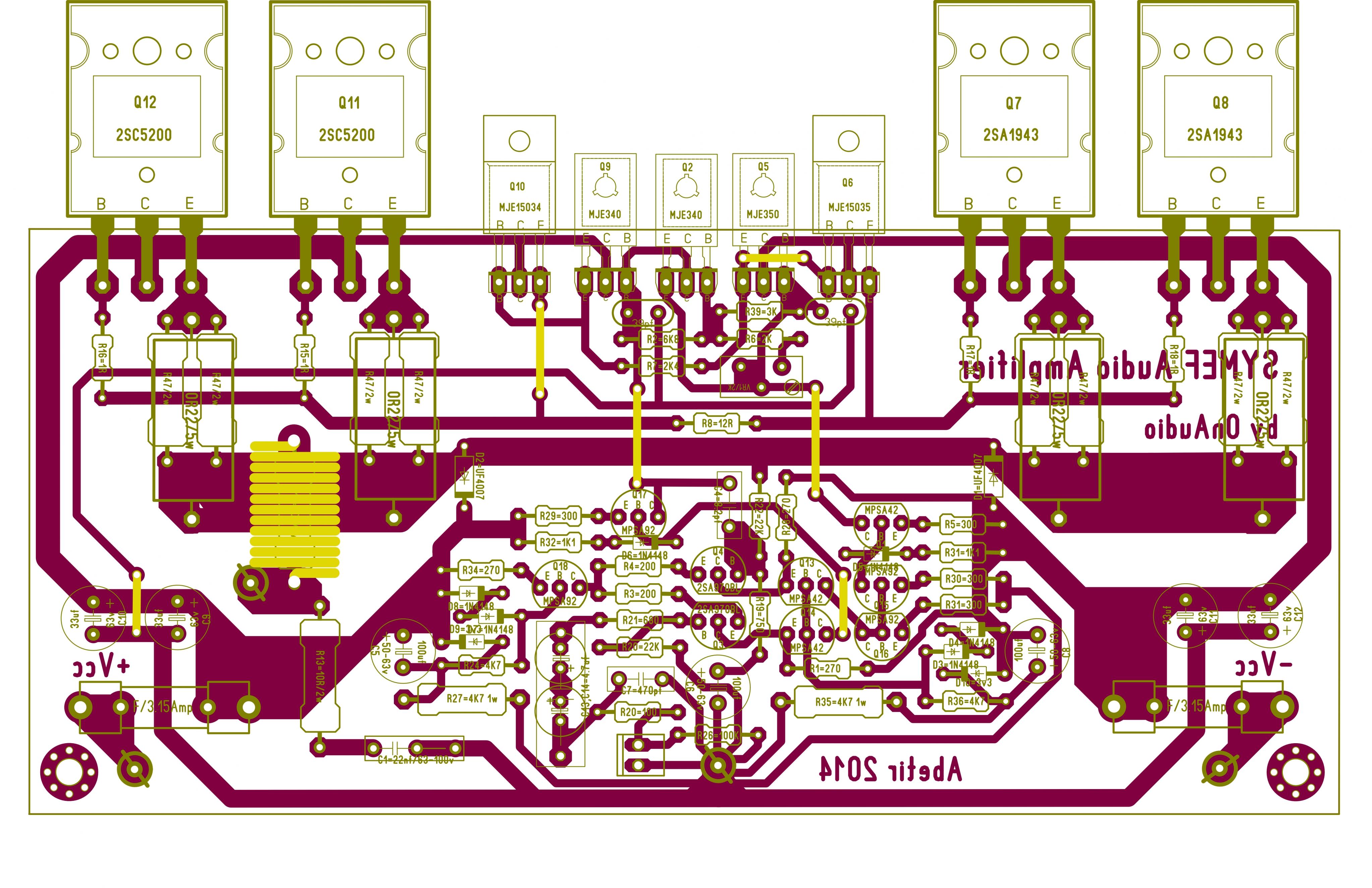

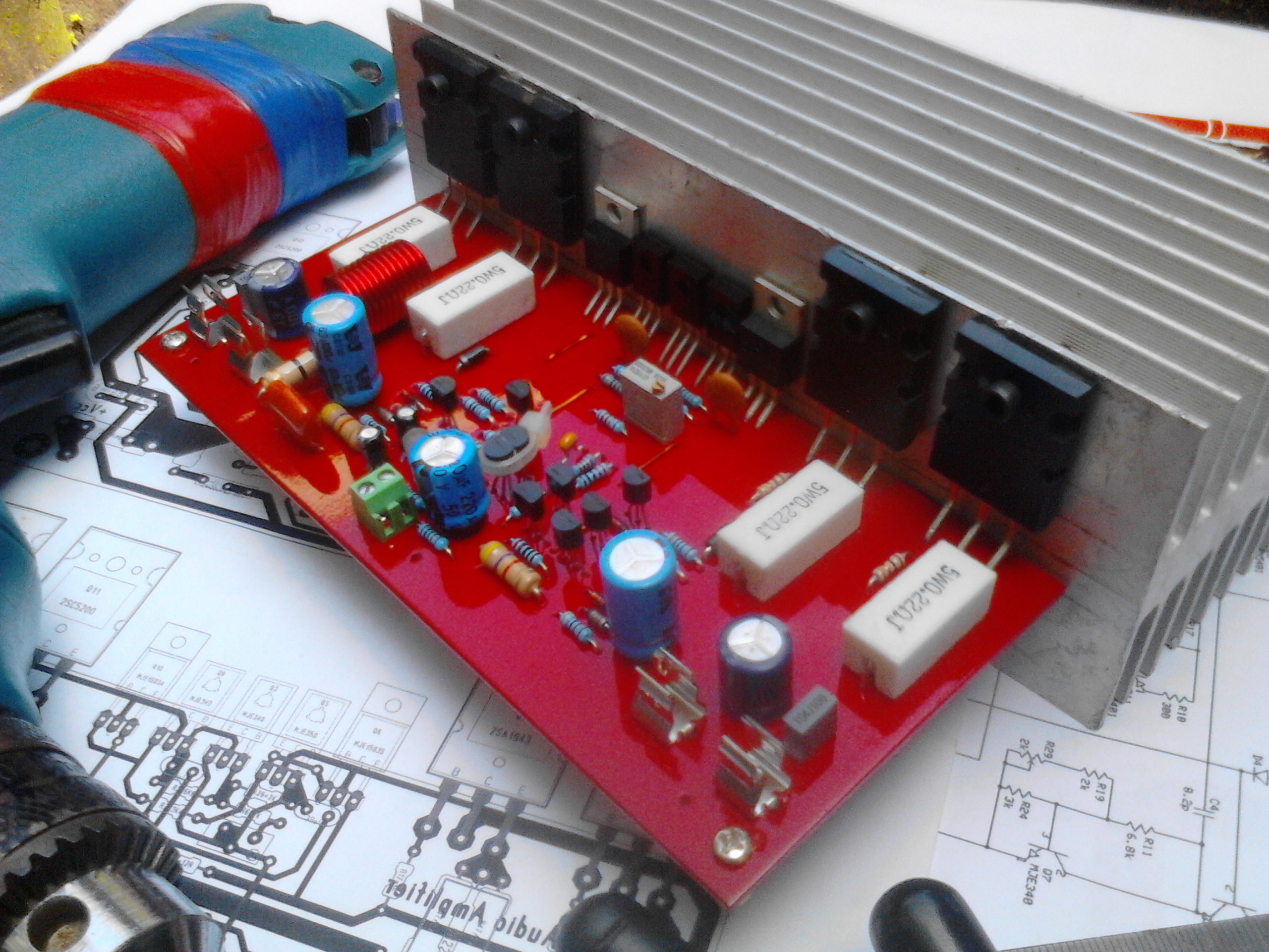

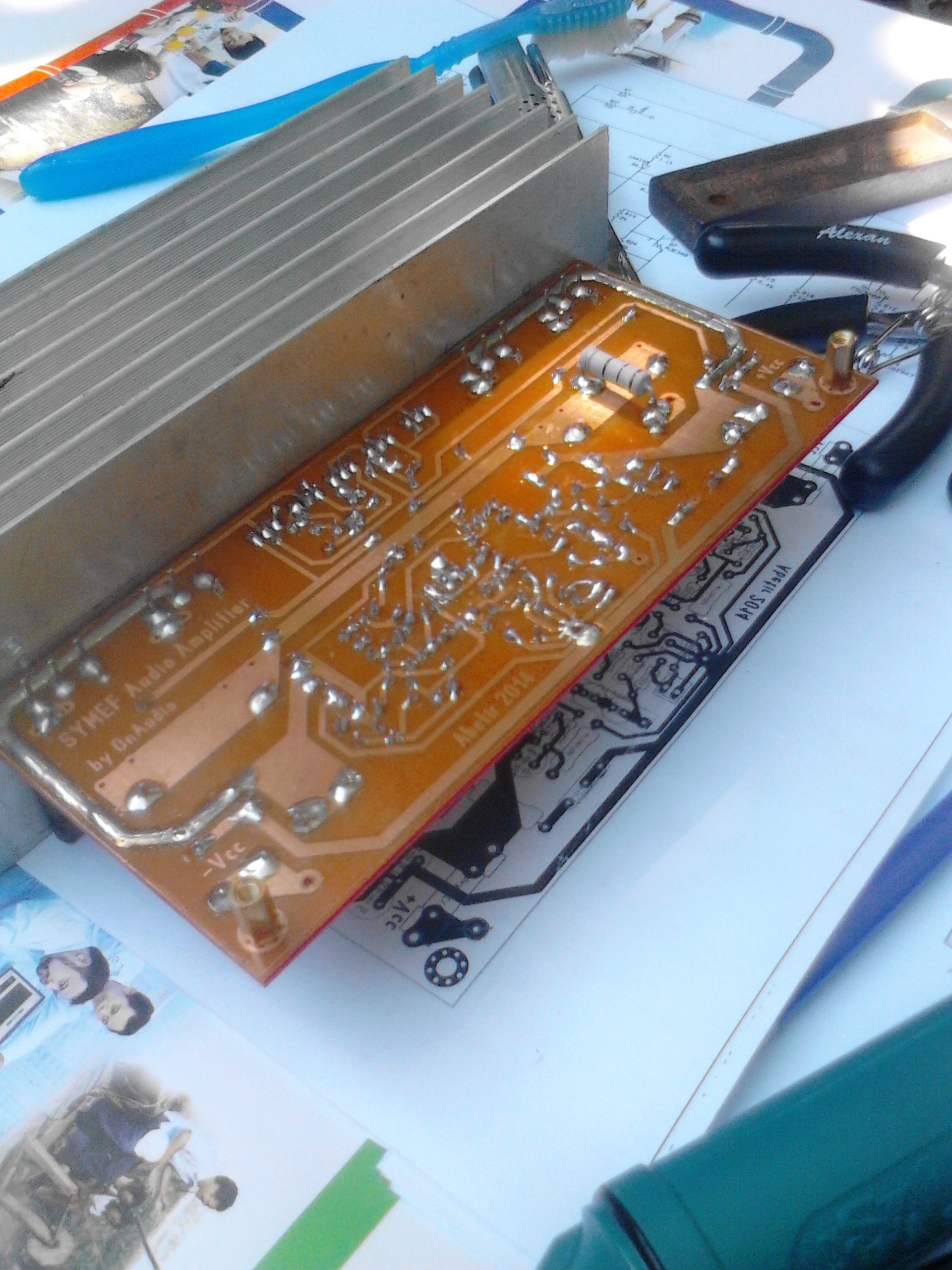

This amp was a long delayed project of mine, the reason was I have wanted a pcb design using my parts preference, notably using 2SA970 / 2SA992 at the input. This design was inspired from the early works of drowranger...
I just hope it will work fluidly when properly assembled. Schematic was drowrangers version.

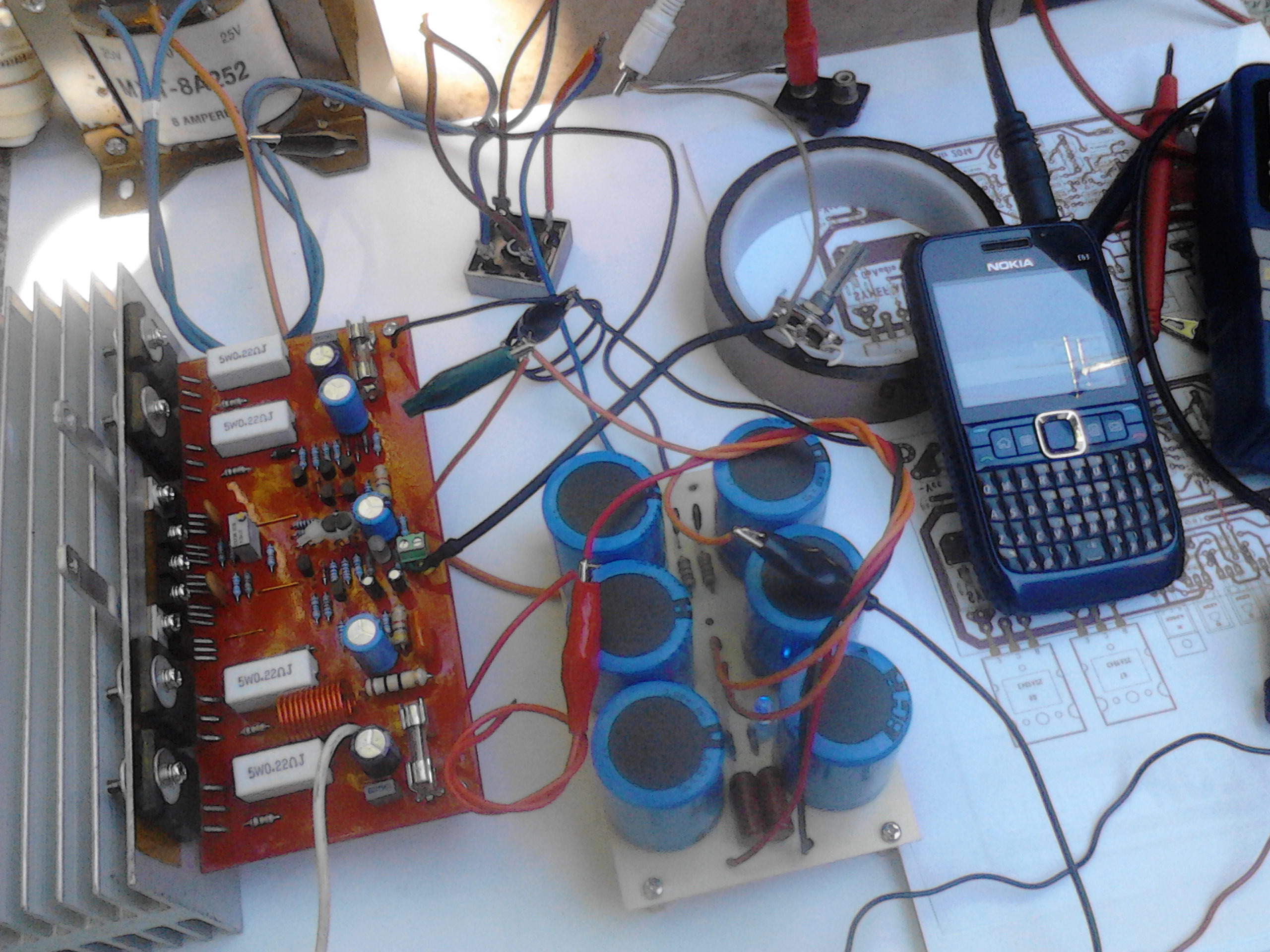

Very nice! Everything went up smoothly at power-on, excellent soundstage very similar to my Leach build but with a heavier bass punch. Pretty silent too no turn on and off thump and with all that messy wiring during test, hum problem did not occur

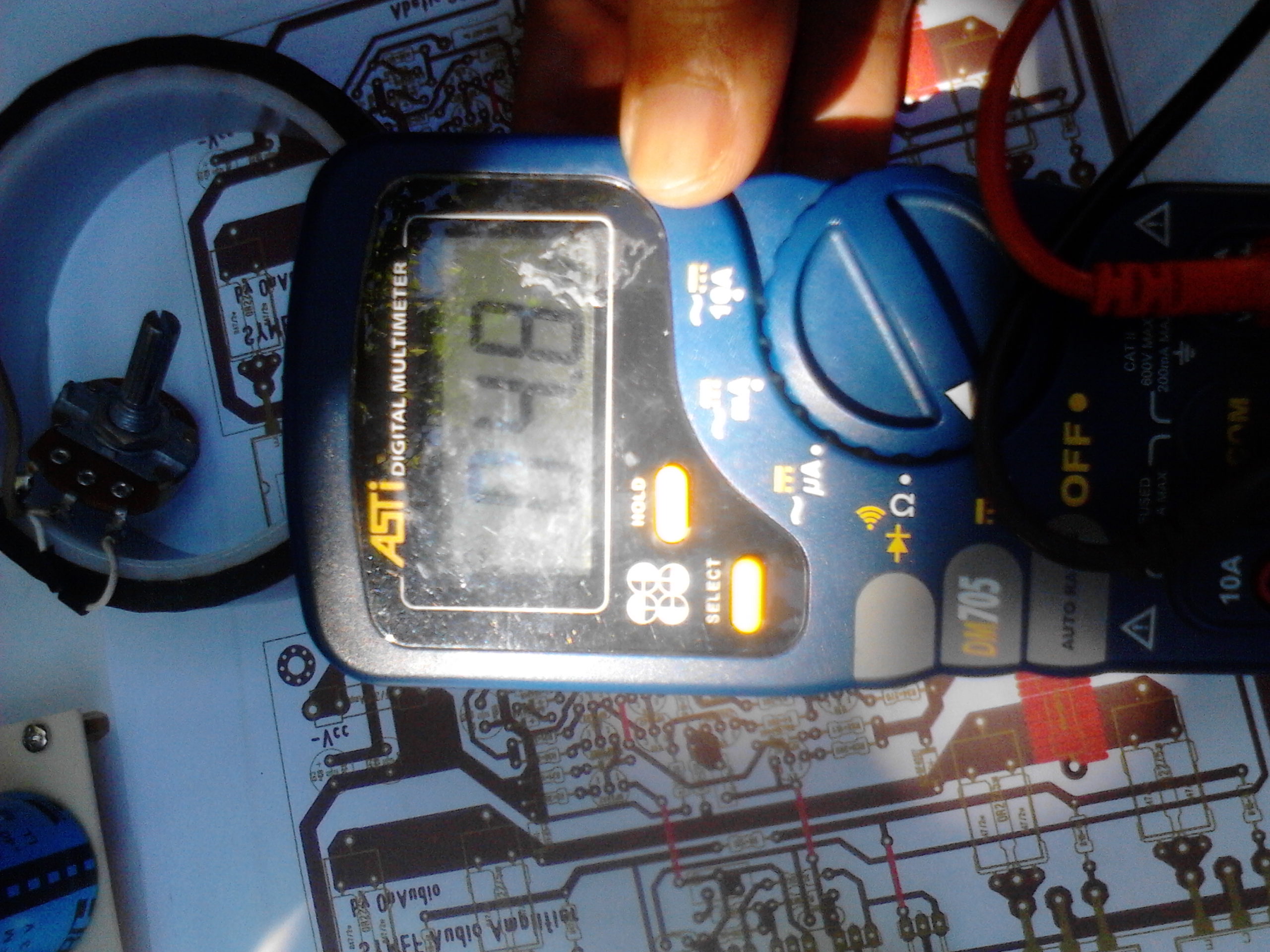

Hope you were able to set bias. That would have been 23mV across each emitter resistor.
