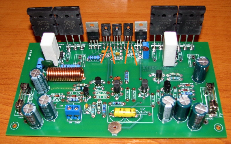

After I found and rectified an error I brought upon myself (outlined in this thread) they seemed to work just fine. Again, the v2 boards. Another member (IIRC Tekko), who I believe is no longer active here (banned), had oscillations and made the compensation changes. To the best of my knowledge he got his to work.
The decoupling in the same location on the other side? Have they been built to OnAudio's BOM, or are there ant substitutions at all?

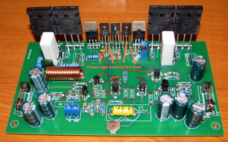

So, it behaves OK until you get up to the desired bias point by the sound of it. Still smacks of oscillation. I would try relocating the 39pF compensation caps that currently go from VAS collectors to ground to VAS collectors to their respective bases. In other words trade the shunt compensation for Miller compensation. Connect C5 across Q4's B-C junction and C12 across Q15's B-C junction.
Is this what you mean
No, what you show is putting them on the pre- drivers C-E. I'm talking about putting them on the VAS devices B-C. The Q4 and Q15 are off the schematic on Harrison's website, hopefully the designators on your boards match.
That said, a little B-C capacitor on the pre-drivers can also help tame a triple too. I would also be tempted to up the output base stopper value to more like 4.7Ω as well.

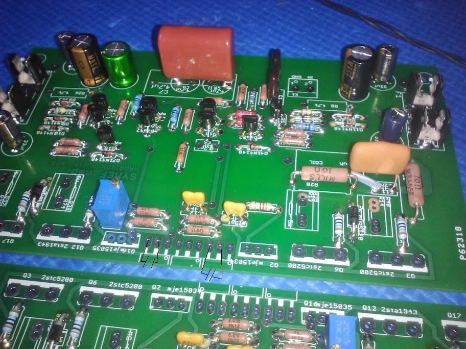

It is correct,you're looking at the back of the trannie;
1 is E 2 is C 3is B
