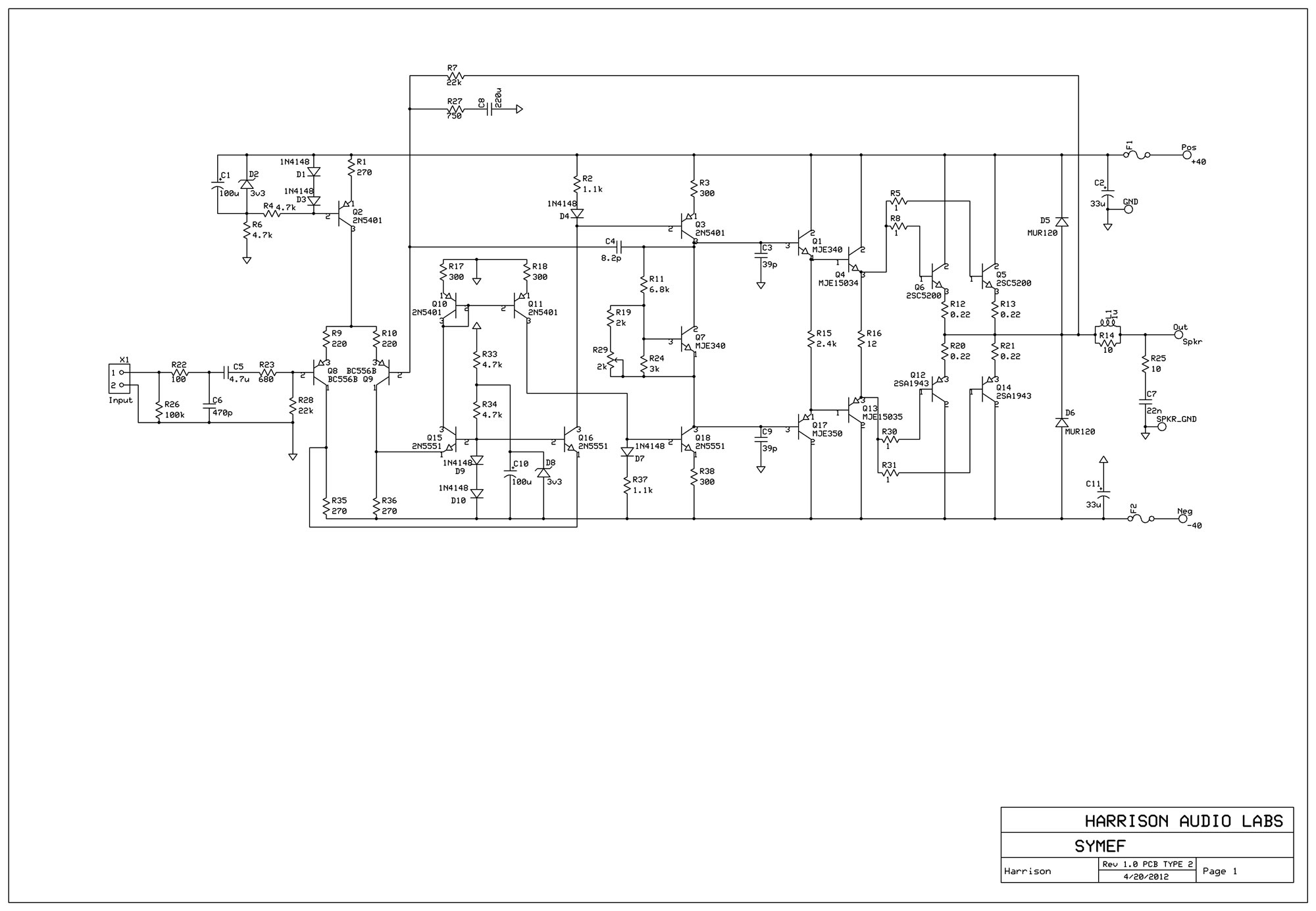

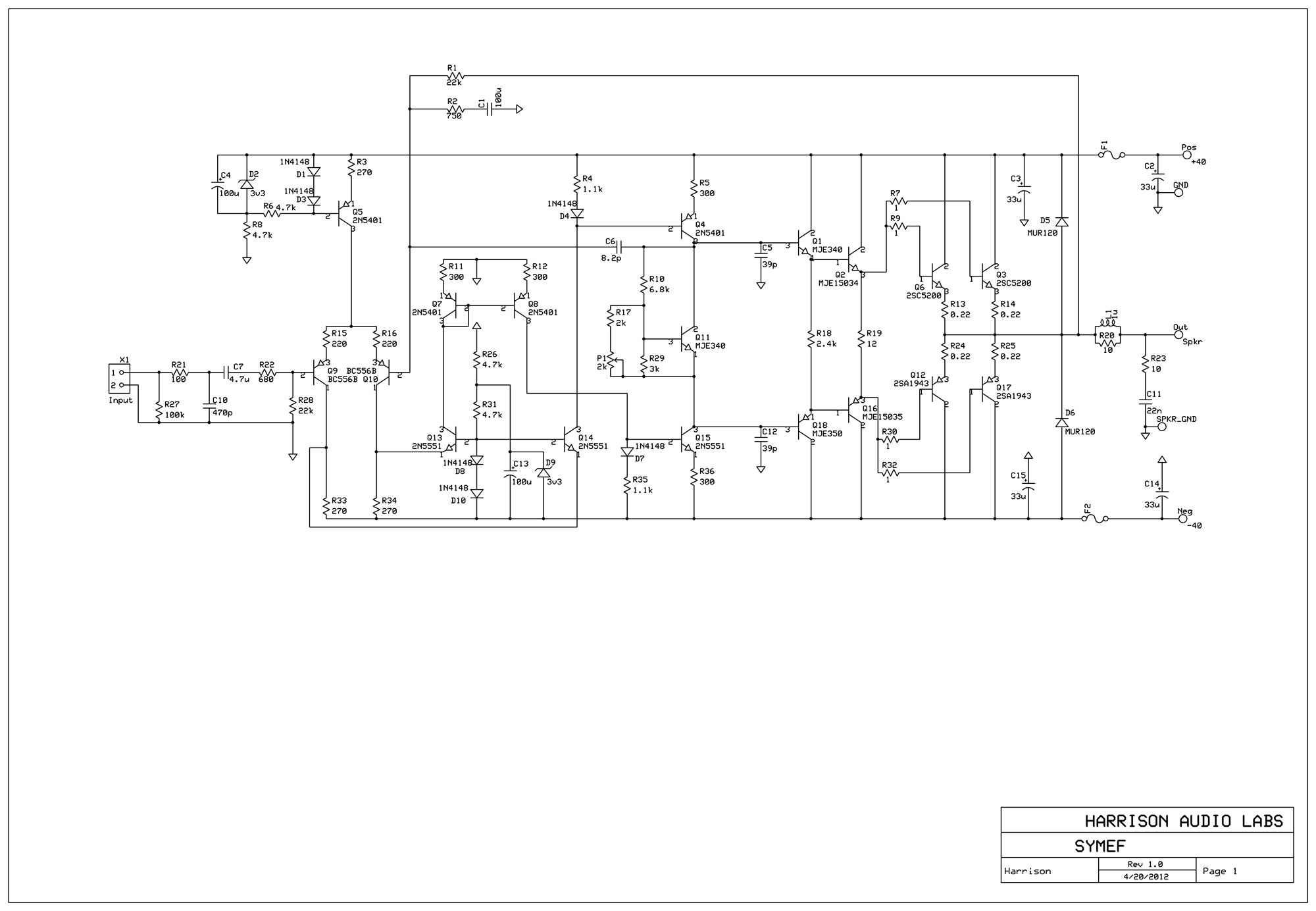

Hi Mr. Harrison,
What is the difference between these two schematics? I thought they were same with different PCB layouts.
After a seven plus year run these PCBs are due for an upgrade to improve serviceability, technology hasnt changed much so this amplifier might still be unbeatable, am not saying there isn’t a amplifier out there that could dance circles around SYMEF, its just that as a defacto standard and with existing technology, its just hard to beat. Banana plugs also have necessitated the need for a protection circuit to keep both speakers and amplifier safe, builders of this amplifier have showcased different protection circuits boards on their builds, kindly feel free to share these for review

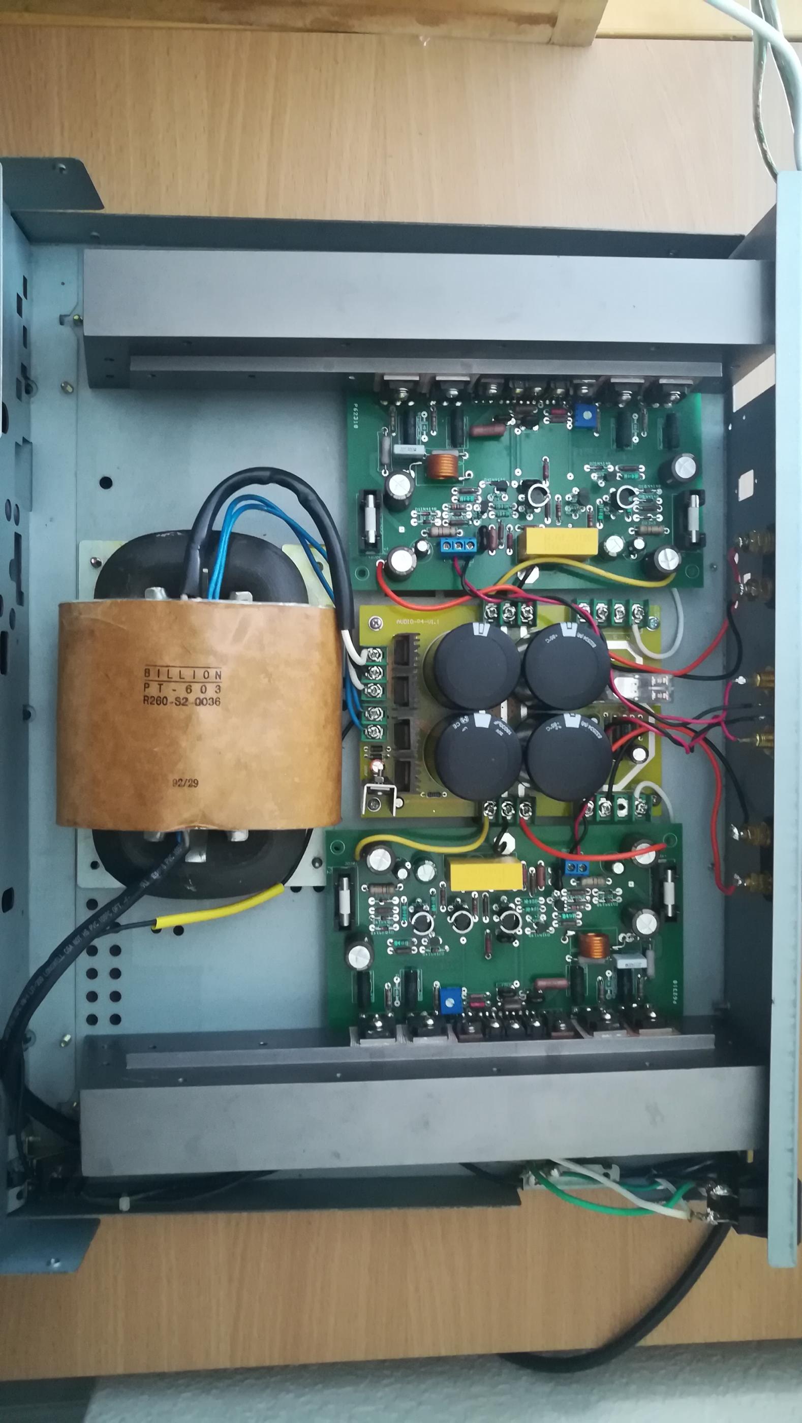

Here is my SYMEF in a case. It is such a beautiful sounding amplifier if you have this one your music comes to life. I'm not a good reviewer, but here are my observations.
This amplifier immerse you in music, and it puts an emphasis on the singer and brings him/her in front of you. One thing I have observe is this amplifier makes the speakers sound the way it wants to. I can tell this for sure, when I switch between different amps, this amp immediately brings its character to the sound. Other amps can't influence the sound that much, more or like dictated by the speakers, but this amp is special.
Thank you Mr. Harrison for the gift. It is kind of life time gift and stays with me forever.
One question Mr. Harrison, I would like to build version 2 PCB but want to operate at +/-50Vdc. Is it possible to run SYMEF at +/-50Vdc? If so what are the changes needed to the schematic? I will have adequate heatsinks for increased dissipation.

Thanks Routhan , good to know she still holds up and that your using at-least bare minimum protection for the most natural experience that being fuses.
She can easily do 50v but now designer starts getting worried about SOA, starts wanting to add beefier output to go with bigger sinks.
Truly humbled by your appreciation that met your need, thanks again for sampling
kind regards
Harrison.
