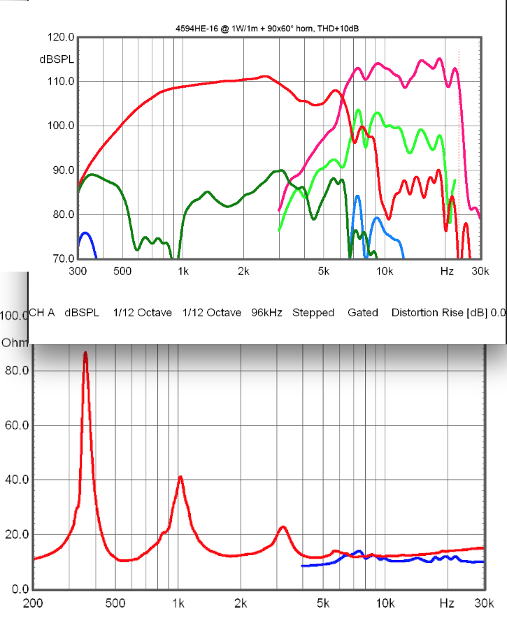

Mark,
The B&C 4NDF34 sensitivity used to be appropriately rated at 88 dB sensitivity, then it was inflated to 92dB :whazzat:.
I still prefer to see both the impedance and raw response of the device driven with a voltage appropriate to it’s nominal impedance that equals 1 watt, rather than an “averaged” post-processing single number using what amounts to an arbitrary voltage (2.83 volts = 1 watt into an 8-ohm load) for drivers of different nominal impedance. I've re-posted your sensitivity chart with the "1 watt" equivalent sensitivity, though the actual impedance is a question.
You have chosen appropriate bandwidths for your drivers, if that had not been done, an averaged post processing sensitivity could give an inflated idea of the usable potential.
How does the quad B&C 4NDF34-16 and BMS 4594HE impedance on the SYN9 compare to the 4594HE (on an unnamed 90 x60 horn) posted below?

Mark,
Art

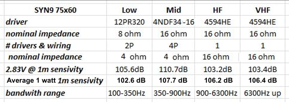

Hi Mark and Art
Maybe we are using sensitivity-ratings to figure out different things, maybe?
For me it´s not about, how loud can it get. I was asking for average sensitivity to figure out how the combination of four drivers in parallel works with a given amplifier, for instance in respect to hiss or other issues at low volume. I guess that there is a fixed ratio when the drivers are coupled directly to the amp, and post-processing will not lower an eventual hiss/noise-issue, rather do the opposite. I will likely not surpass 1 Watt very often in my living-room!
Actually I had just read on a germane forum about noise-issues with highly efficient CD´s and amplifiers, making me nervous!:scared: It´s really just speculation and uncertainty from not having build and tried things my self! When I have my first MEH done I will know a lot more and have my own experience to draw on. But thanks again for answering and sharing.

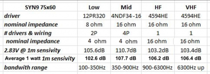

I will re-attach the data-shet I got from B&C for the 4NDF34-16, then we have it on the same page. It says 91 dB/W/m at 4 Volt.
Steffen

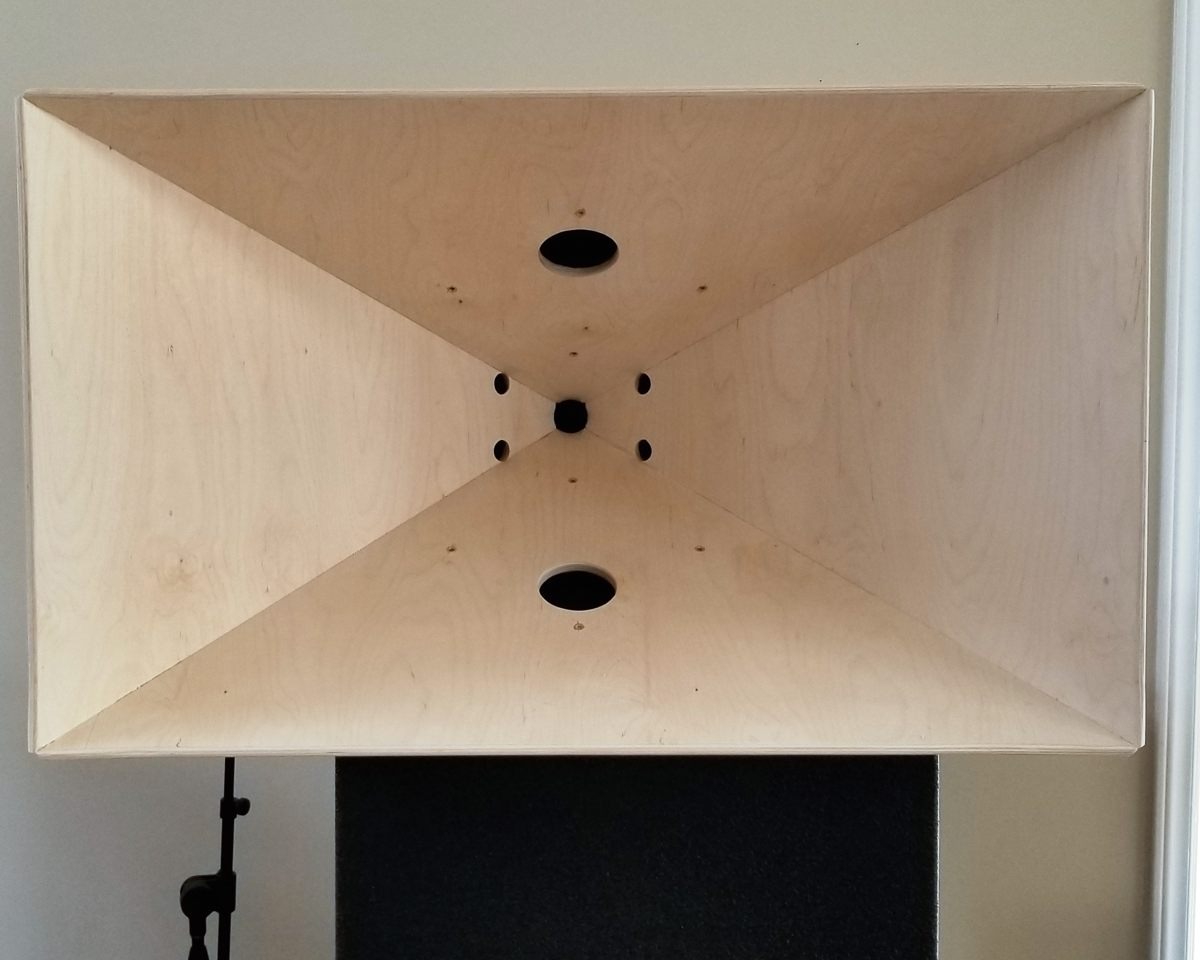

First task was to play with temporary secondary flares, felt around mouth edges, felt in horn various places, etc ....all in attempt to get polars as nice as possible. Well, all that stuff helps...helps the measurements at least, but i'll be damned if i ever really heard any improvement.
So to heck with secondary flares !!!!! Was time to simply compare the versions "as is".
The 60x60 version 2 was the easiest to eliminate. Sound simply seems to come from too deep in the horn. I think Ro808 has described it as a "cupped" sound. My guess is that it would work better in stereo than mono, putting more apparent sound between two speakers.
Harder choice was between 75x60 version 3, and the rag-tag thrown-together 90x60 thread-starting proto.
On paper, for SQ, this should have easily been won by version 3, which has 12pr320's and 4mdf34's, vs the proto's lowly 10fe200's and 4fe35's.
Not so easy.
Believe it or not, and despite nearly identical mag & phase, and very similar polars within +/-30 degrees, the proto out-punched the much stronger version 2 in the low 100Hz area.
Both boxes had their low ports close to the same distance from the throat, about 11 inches.
Version 2 used the traditional placement with 2 ports per driver in the horn corners.
The proto used my favored method of a single large port as close to cone center as possible
So I decided to go back to the single, centered port, strategy.
And keep the box 90x60 which allows a smaller overall size and weight than the 75x60 pattern.

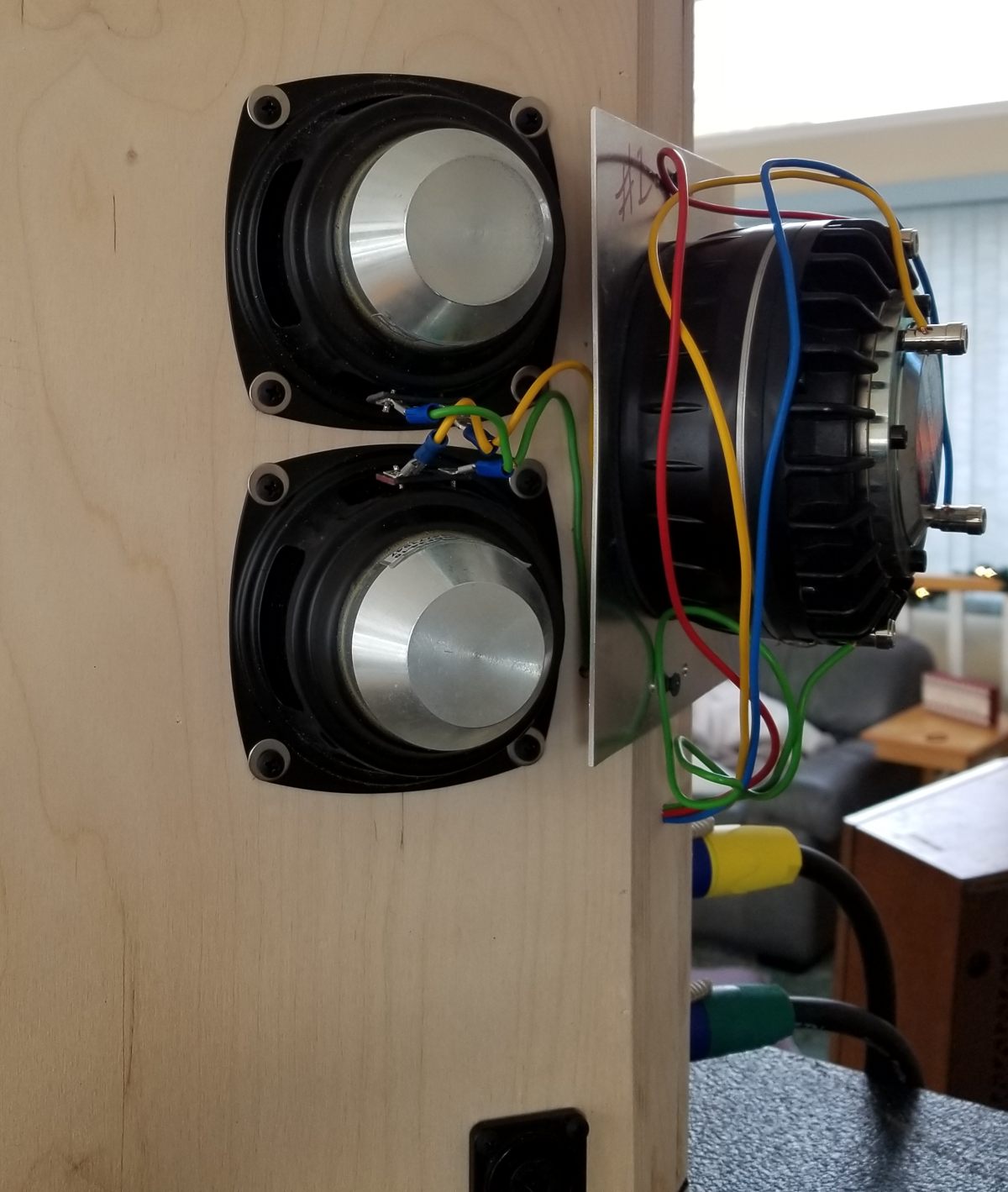

Anyway, finished pair are using a bms 4594he, four 4mdf34's, and two 10pr300's (from 12 inches to help reduce size and weight)
Also found the mids, the 4mdf34's sound better to me unenclosed, open baffle so to speak. Since they do not share a cavity with the 10" lows, it works fine other than leaving them exposed.

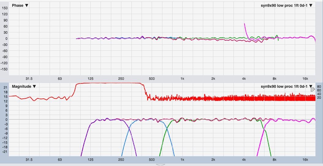

Here's couple of picts, and the sections' response curves. xovers are 96dB/oct LR, ...120Hz, 300Hz, 700Hz, 6300Hz. (sub not shown)
Using 4 sections, and only in the meat of their bandwidth, required the least EQ i've experienced...could almost simply use steep linear phase xovers without any EQs.
I'm super happy with the clarity, imaging, spl, and dynamics.....

We know that the low port distance from throat determines low end loading. https://www.danleysoundlabs.com/wp-content/uploads/2012/01/The-Tapped-Horn.pdf
I thought bottom end response would be the same, ports in corners vs ports in center, as long as the distance is the same.
Maybe it is, but it doesn't sound like it ! The single center-port plain sounds punchier, more dynamic, to me.
I think DSL might be getting some punch from the reflex ports they use.....ports i've been trying to avoid if possible.
Makes sense due to driver upper harmonics are centered around the VC Vs out at the edge where DSL puts them for max practical compression ratio, the ~ default choice for max performance same as the 1st thing done historically to 'hotrod' a motor's internals [thinner head gaskets and/or 'shaved' heads 😉].
Aah, I see what you're saying. Thx, that does make sense.
