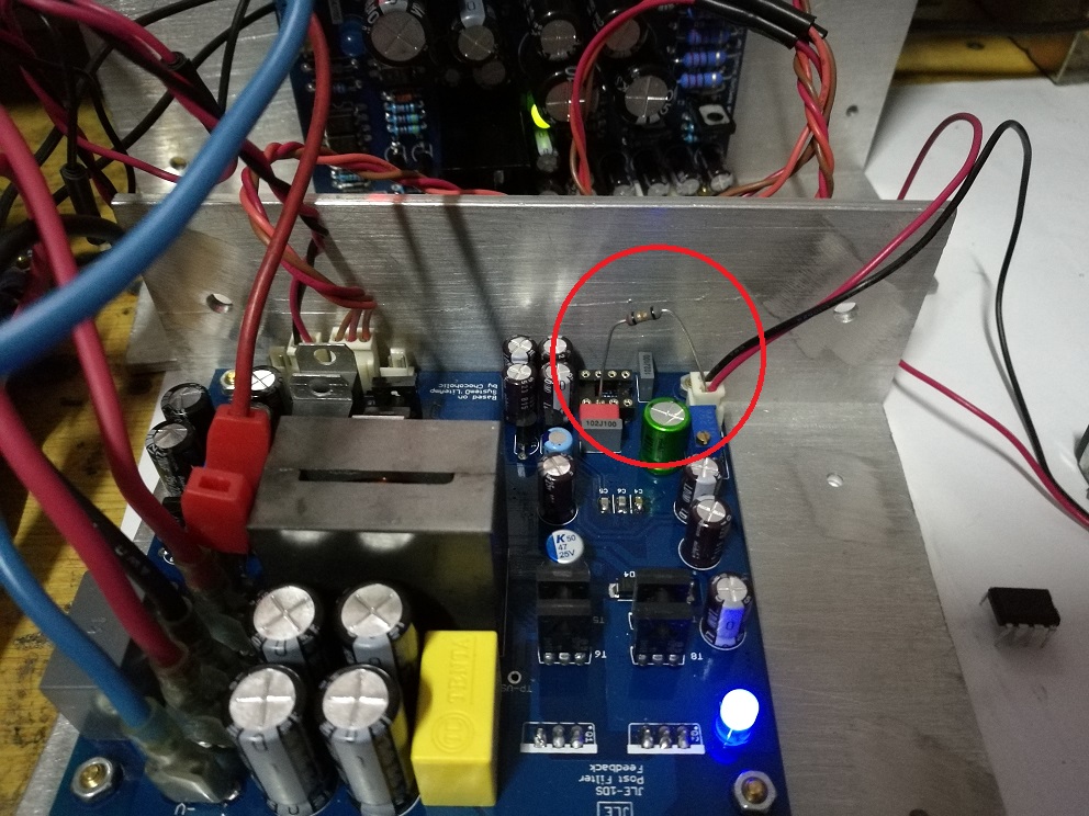

I'm affraid I've still some questions.
It's about the regulators used on the gainboard. What are the diodes d103-d104 for ? Protection ? But there isn't much capacitance at the output ?
And what about r112-113 ? They seem to raise the supply impedance quite a bit. Are they there to prevent oscillation of q1, q2 ?
Thanks for any pointers.
Things are slowly taking shape pcb wise.

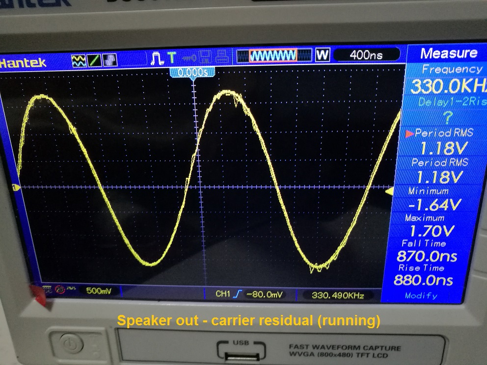

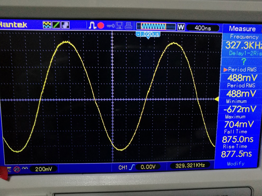

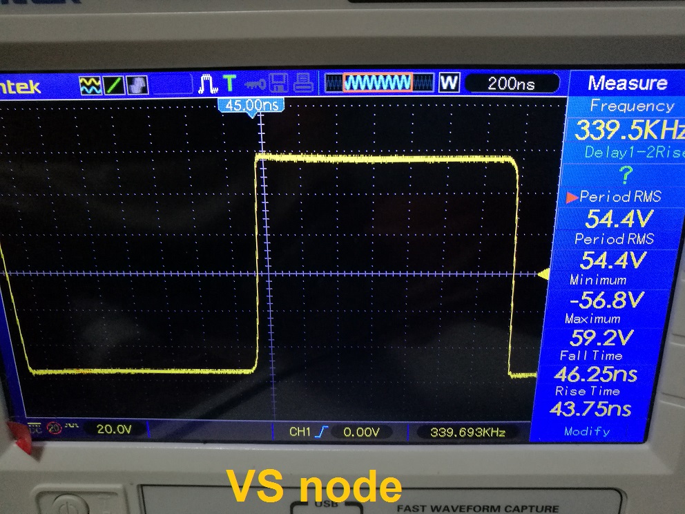

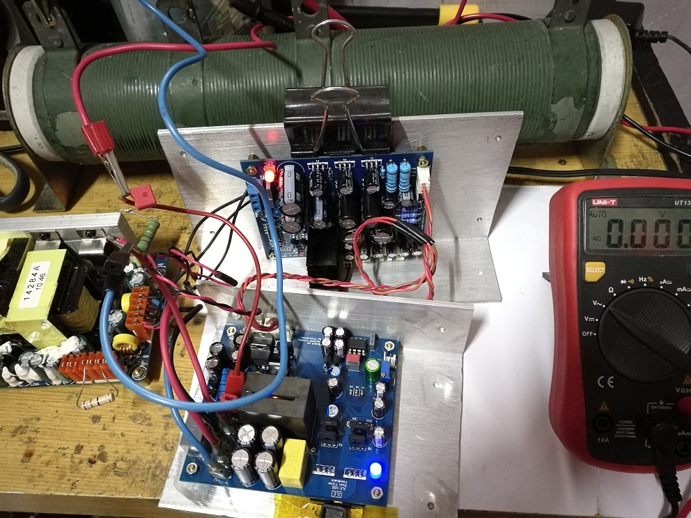

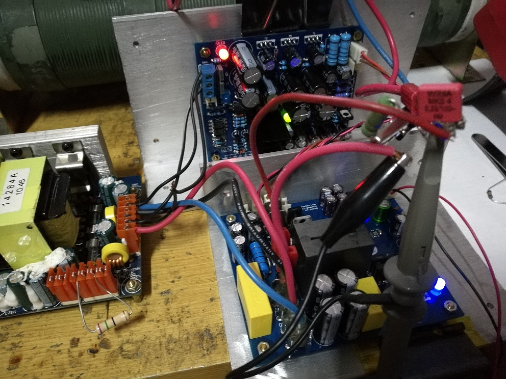

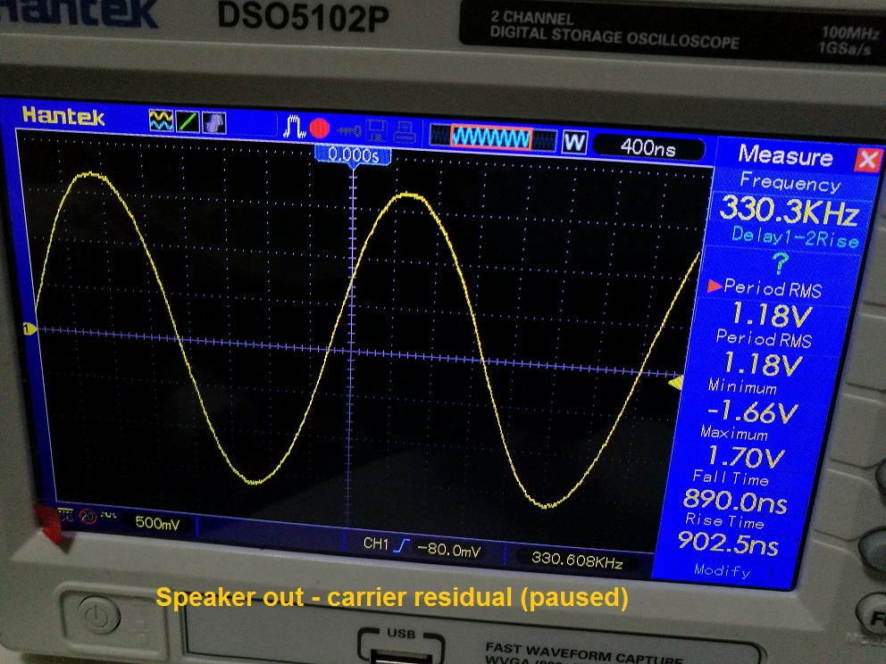

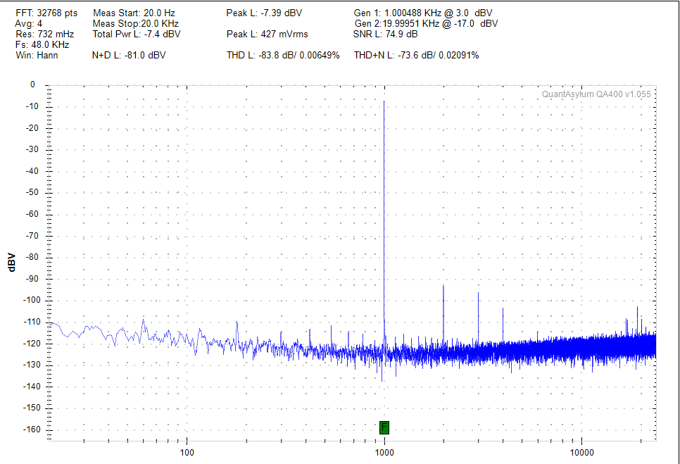

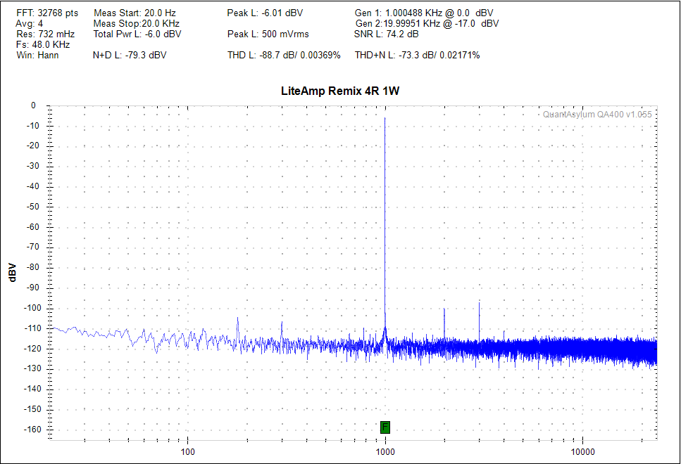

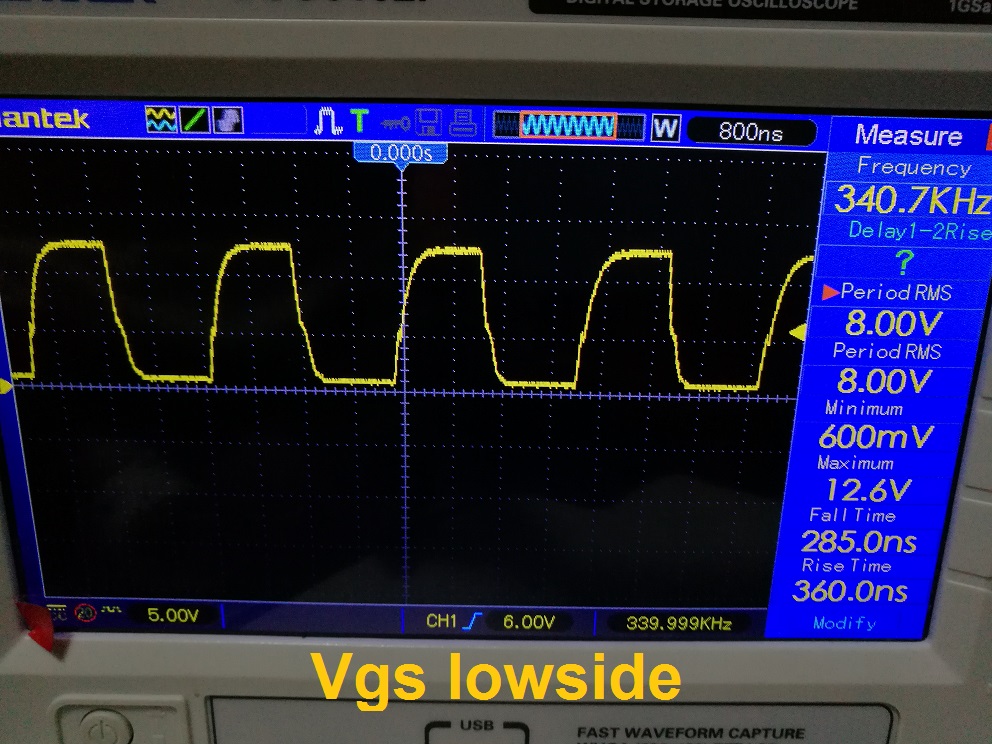

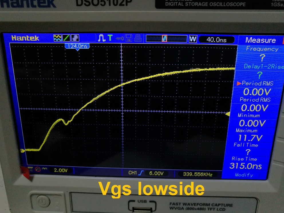

Here are some scope shots with IRFB4227. The mosfets are not getting hot even after some short burst 100W THD tests on my QA400.
What I noticed is that in carrier residual (see 3rd pic), there are some random noise that is riding the carrier, but there are no blips!. Also the residual is kinda high 1.18Vrms
I used Abletec SMPS +/-53V on all measurements. Aux supplies are powered by linear regulator.

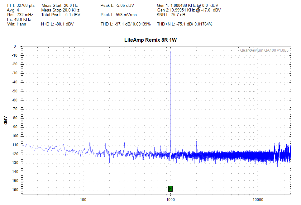

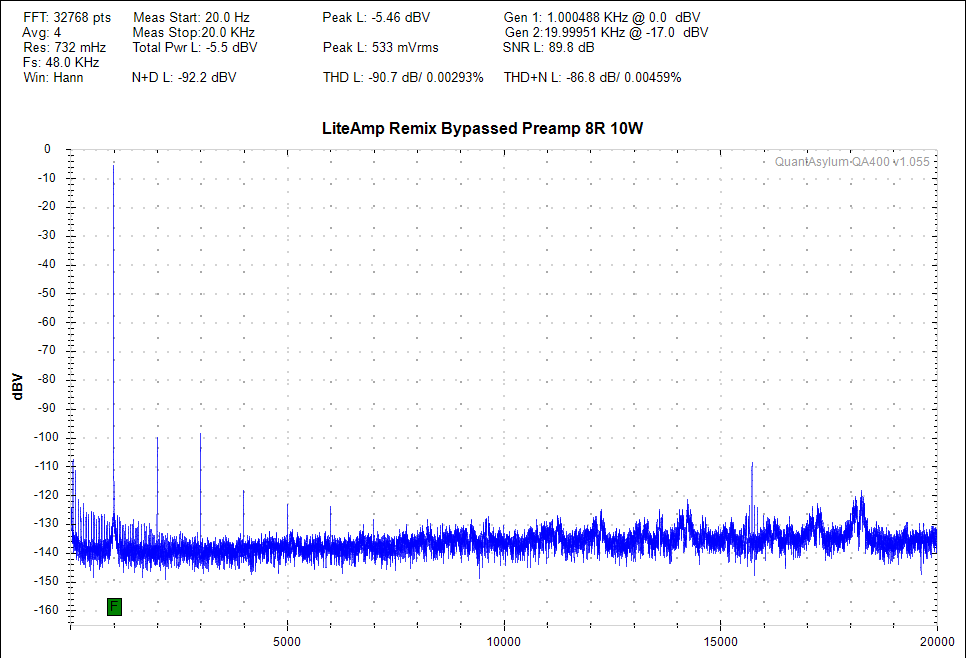

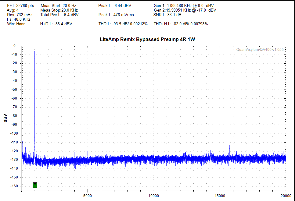

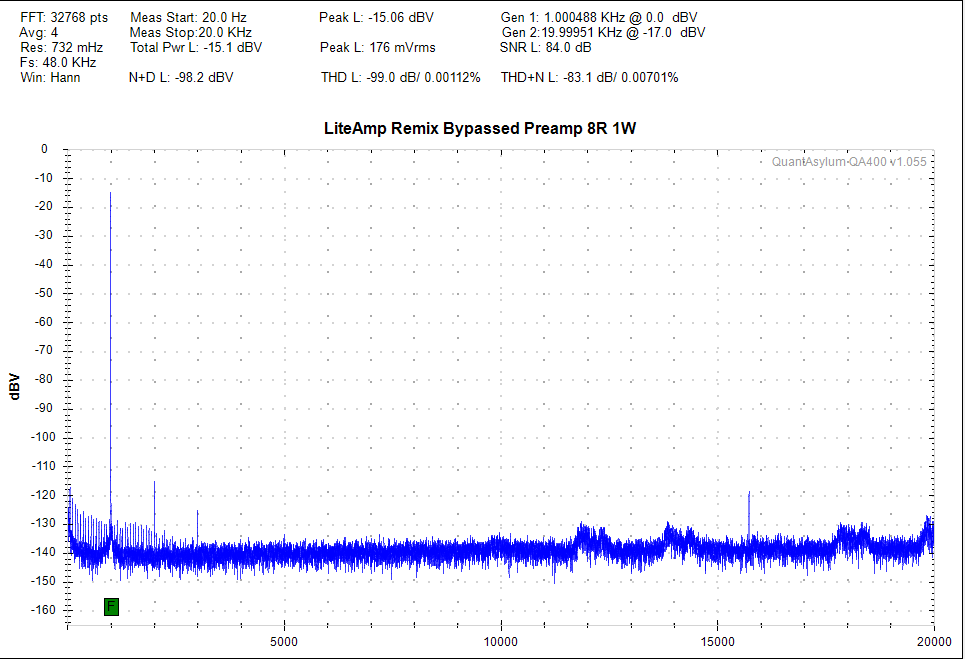

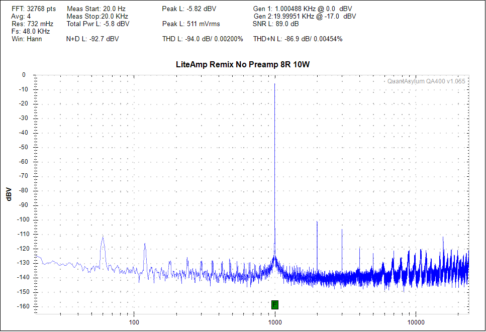

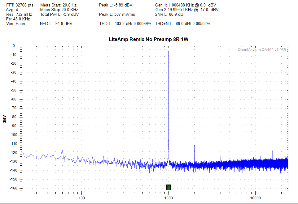

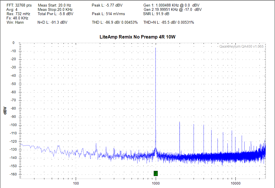

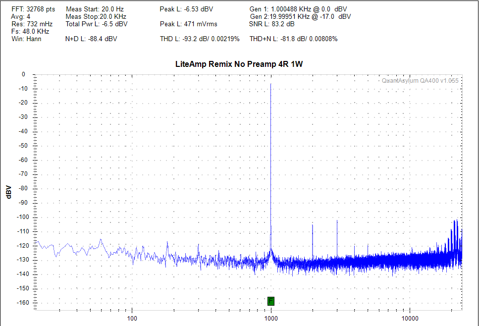

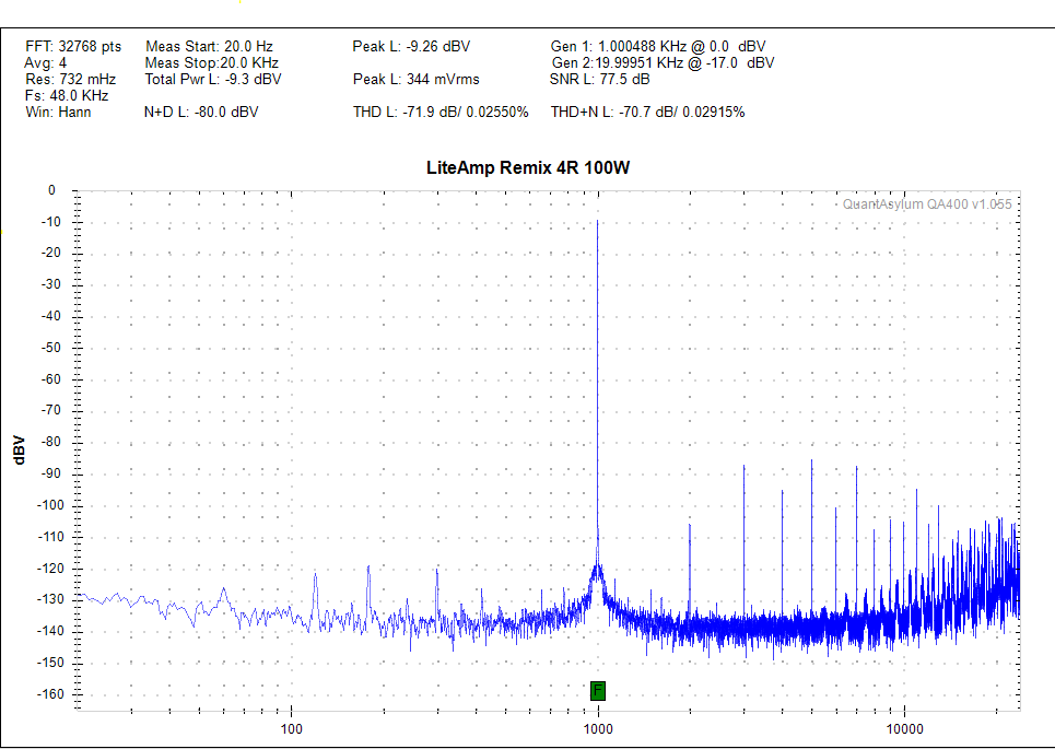

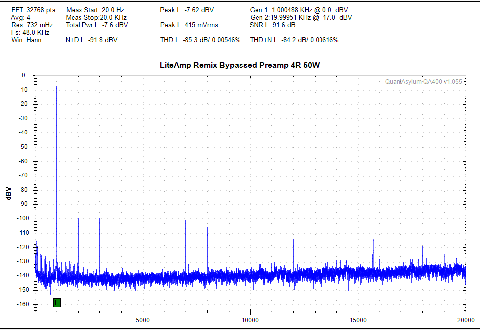

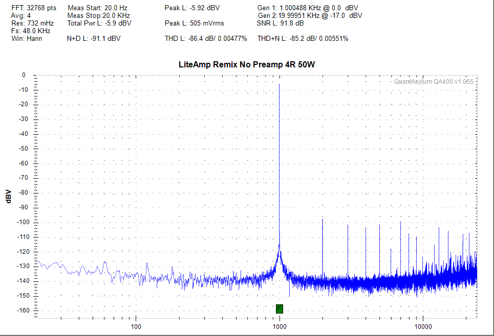

Here are some quick THD measurements when Preamp is bypassed. If there is no preamp, my QA400 generator + THAT1646 which is powered by +/-10V DC (from boost converter) runs out of juice to drive the liteamp so the measurements are up to 50W and 10W only.
I believe if my QA400 interface is powered by batteries, the measurements, will slightly improve.

Ok so my interface for QA400 has a differential input, so I grounded it and got better THD results. Attached pic for my liteamp with bypassed preamp.

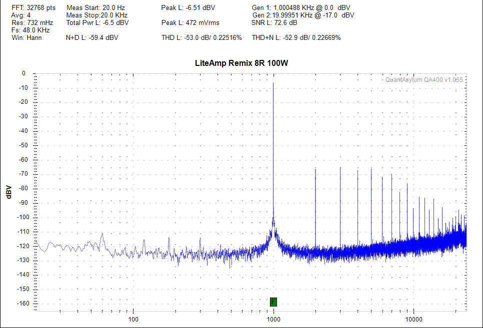

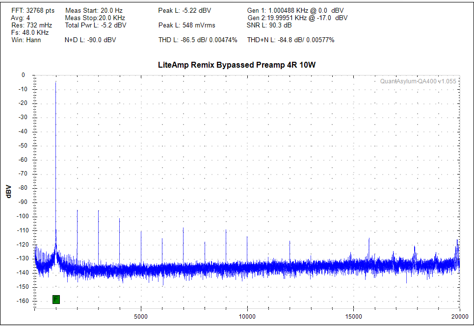

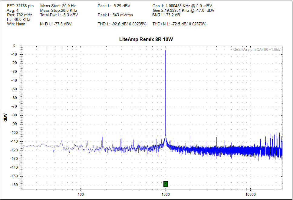

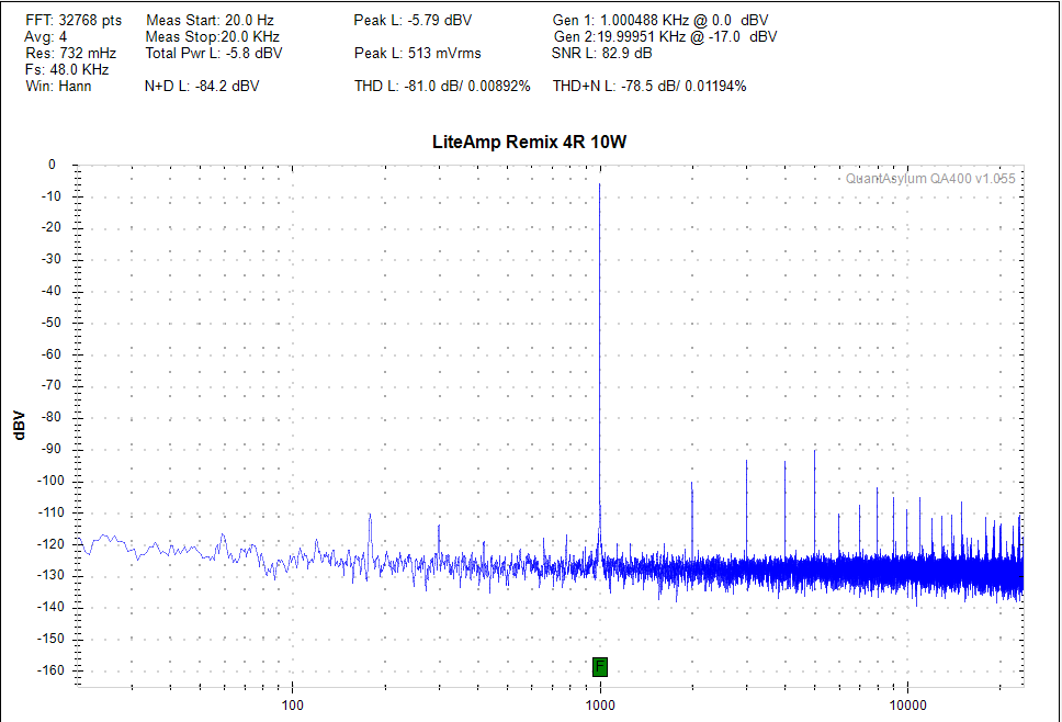

Attached THD measurements using built in preamp, opamp used is LME49720.
I don't know if the high frequency noise floor fluctuations are just random interference from test setup or is inherent and due to my PCB layout.
Hi Lester,
thanks for posting the diagrams.
IMHO that‘s already better than many PA amps, however I agree that the strong increase
of distortion already at medium power levels is not nice.
Here a version which should serve needs better.
In this design the carrier signal at COMP is smaller than in the earlier versions, ==> more
headroom until the clamping kicks in. Further increased headroom by setting R4 to 200R like
you already did for the previous version.
22uH vs 15uH also reduces the amount of output ripple (if adjusted to same frequency).

Random noise on the output carrier:
This is looking like a wiring topic and visibility likely will depend on where you put the probes.
If you put the probes right at the output terminal of your PCB, I would guess that it turns
small or even unvisible.
In any case if this a fluctuating phenomenon it could be the reason for your fluctuating noise floor.

About the noise of your preamp:
Typically the noise is resulting from four effects. Voltage gain of the circuit, voltage noise of the OP amp, current noise of the OP multiplied with the concerned network impedance, voltage noise of the resistors. In order to give more detailed hints you would need to disclose the full circuitry.

Hi Choco, thank you for providing new values, I replaced output filter to 22uH + 1uF, R6 to paralleled 1.8K. C2, C5 = paralleled 10nF
Set osc freq to 300kHz (when measuring THD).
THD has increased, when preamp is bypassed, THD is also the same (but lower noise floor), also I forgot to mention earlier that the gain is very low when there is no preamp. With 4.1Vrms input, the output is only around 11.8Vrms.
Anyways, I prefer a more stable amp than having a low distortion while hanging on the edge of stability.
Attached picture which shows the location of probe used for THD and oscilloscope measurements, carrier residual when being set to 330khz and attached to 8 ohms load, and THD at 1W and 100W.
The voltage gain without preamp should be slightly more than factor 9.... I forgot to mention earlier that the gain is very low when there is no preamp. With 4.1Vrms input, the output is only around 11.8Vrms.
If you get less than factor three, then there must be a hidden error – either in the measurement or in the proto.
First point to double check would be R10 and R12, massive value errors here would lead to your described lower
gain and still would allow overall reasonable performance as visible in your measurements.
Regarding distortion at 100W/8R from +/-53V:
With respect to the 53V rails this is already a high power level, because the modulator already has to
modulate the duty cycle in a range between 25 to 75%.
Nevertheless – for this condition I am seeing a sweet spot.
While for a setting of R9+Pot=200 Ohms also my simulation is showing similar values like your results,
a setting of R9+Pot=150 Ohms should bring roughly 10db improvement ==> Resulting in a THD around 0.1%.
I cannot tell if this 150 Ohms is a general sweet spot for this amp version, but most likely R9+Pot=150 Ohms
will also perform well in mid and low power operating points.
Unfortunately trying to predict distortion values below 0.1% with my simulation is just a sort of gambling.
==> Have a look to R9+Pot=150 Ohms at 100W/8R +/-53V and if this brings an improvement similar to simulation, then stick to 150 Ohms
Furtheron then all further improvements are possible only by real life fine tuning. This is especially valid for the low power operating
points with THD far below anything my simulation could properly predict.
