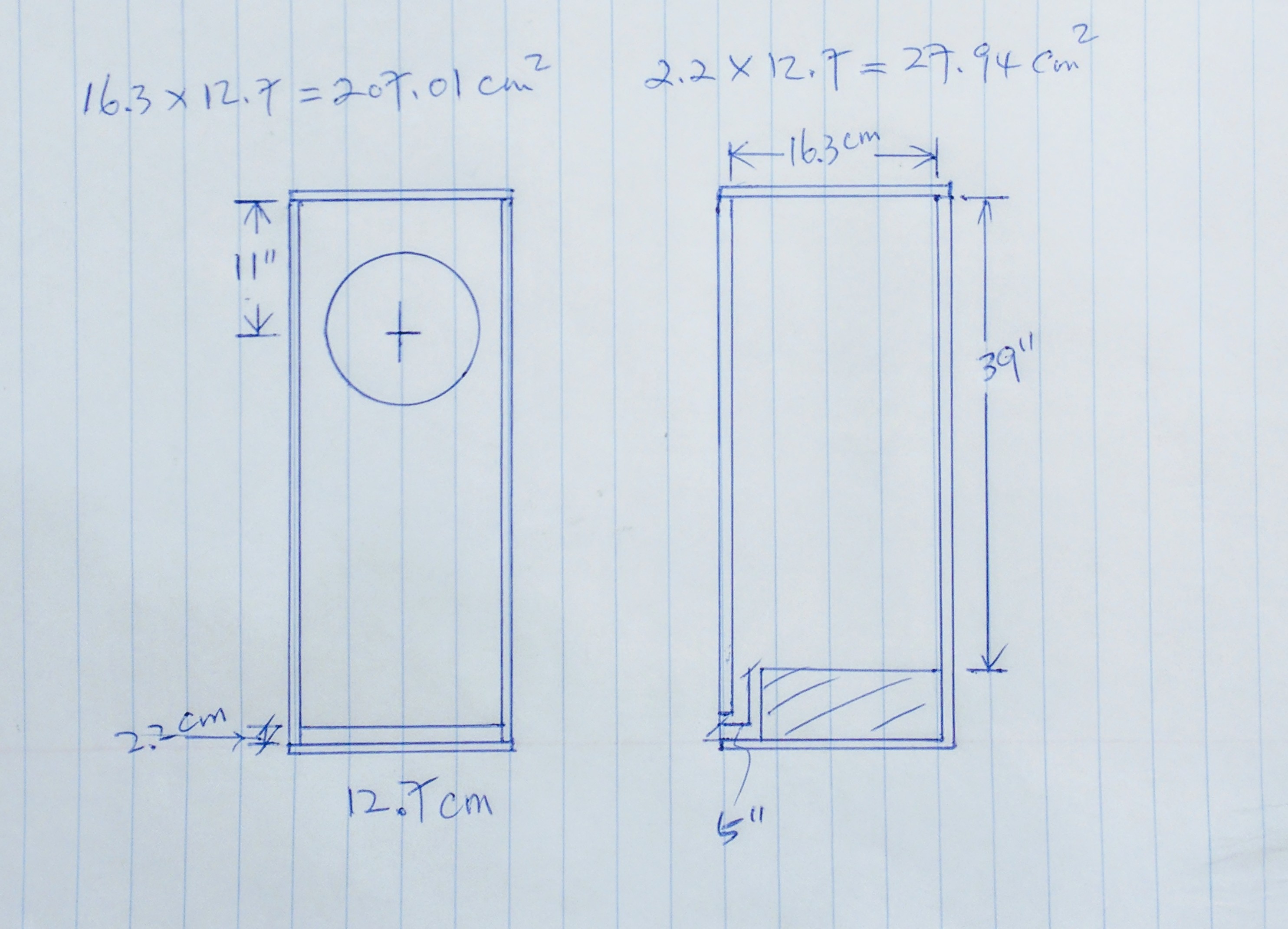

Are you planning to use tha space at the bottom to fill it with sand?
Yes, that will be sand filled. This also makes the driver higher.
My question is, do my numbers on drawing match with all numbers that Bjorn provided. My math is really bad. Please kindly confirm before I cut the board.
Are you intentionally making it very skinny? Your baffle is 12.7 cm/5” wide. The cutout for the driver needs to be 4.84”
I only have 207cm2. Please let me know if I have other option. Thanks

You could try trapezoid but that's rather more involved than building a "square" box. The port would have to be a tube too. Advantages would be a wider baffle and a deeper cabinet.

Does it involve some design work. I don't know nothing about it and as I said I'm bad on numbers. Or if you could help on design and or point me to somewhere. My woodworking skill is very good. ��
Albertli, your math is fine.
As for the driver bezel, just glue the sides and front baffle first, making the back removable, then, you can use a router to cut the hole and recess needed for the driver. The bezel might go over to the side panels a little, it will be ok, the driver is still smaller than the combined width of the baffle and side panels.

Maybe I'm just not seeing the problem. Albertli posted a drawing of his intended inside dimensions with a width on the front inside of 12.7cm or 5 inches. If the side walls are 5/8ths or 3/4th thick the total for the front bezel comes out at around 6 1/2 inches. I think a 4.8 inch driver cutout and 6.1 inch flange will fit fine as Perceval noted.
That said I'd be inclined to make the whole thing 1/2 inch (~1cm) wider just to make things easier. Of course you would shorten the depth from 16.3 down to 15.4cm or so. I suppose the slot would get wider so you might make it 2.1cm tall.
I'm only suggesting making it wider because I just got through -barely- fitting some TB-W4-1320SIR into a TABAQ that was built narrow for some TB 1053's. Had to fit a suprabaffle. Sure 1mm inside clearance is enough but there's something to be said for letting the driver breathe a bit...

207cm2 needed. Maybe call it 216cm2. That's 12x18.... Add 3cm to the baffle and lose 3cm from the rear arriving at 15 baffle, 18 depth of enclosure and 9cm rear panel. (Ha, just realized.... 207cm2 is a 14cm baffle, 18 deep with a 9cm back).
That gives you a wider baffle for clearing the driver. Some extra work to box in the port to keep its dimensions the same. Main issue is how to build. I'm building formers (hollow) to enable the build and add braciness. It's taken a while to realise I need a good jig to make identical formers. I'm still puzzling over caulking it once the initial glue has set.
