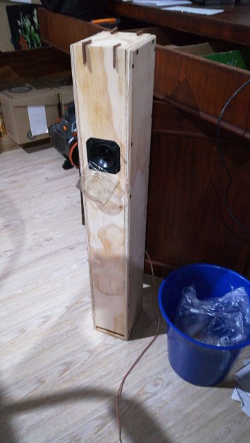

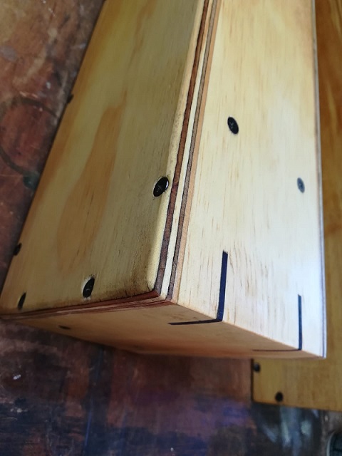

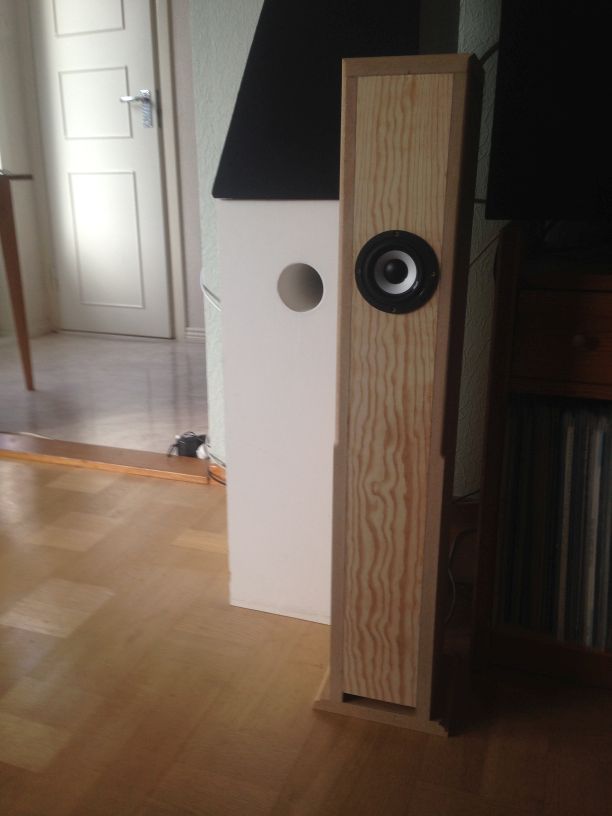

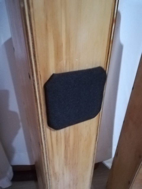

A friend of mine finished a set of TABAQs this weekend (with my advice, help and inspiration of course). He used 12mm Pine plywood and Peerless P830987 drivers. The TABAQs are driven with a Pyle TPA3116D2 2 x 40W BT amp. Fortunately we managed to source the drivers and amp just before the corona crises started (and our currency tumbled to junk).
“Incredible! I can listen to this all night long” was his first reaction. Needless to say, he is extremely satisfied with the outcome and the quality of sound. He loves woodworking but this was his first speaker build. He used hardboard outside splines and more screws than needed for a more rugged industrial look. The boxes were finished off with a clear matt polywax sealer.
Hi there,
very nice build, I like the wood very rustic and I am happy your friend join the club of Tabaq's lovers..
![cheers :cheers: :cheers:](https://files.diyaudio.com/forums/images/smilies/cheers.gif)

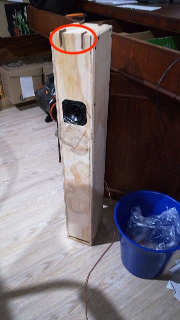

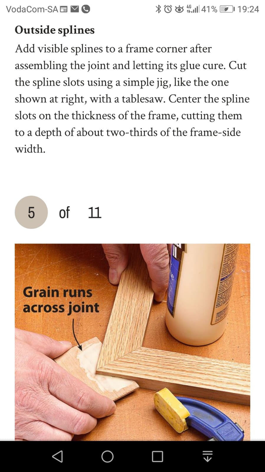

It is called an outside spline apparently – used for picture frames mostly. I doubt that it is adding anything necessary (strength) here, except the looks....just one question what is what I circle on the top of the enclosure? ....all the best

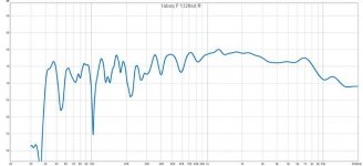

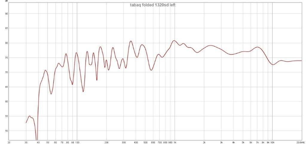

Measurements from my listening positionFirst layer with matte black paint done.. starting to look good.. only tested without filter.. I have a dsp available but what freq would I want to lower? View attachment 831628

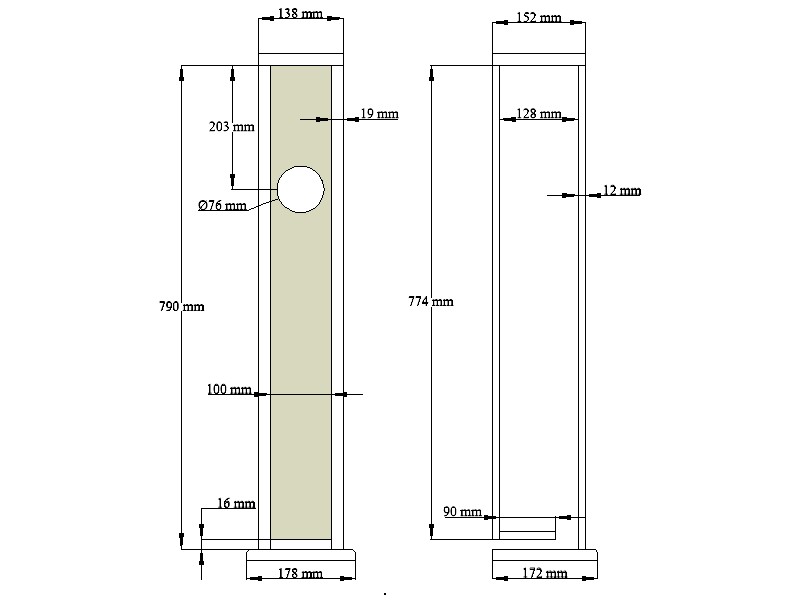

Where do I find proper folded TABAQ drawings?
Should be this, post 281
TABAQ TL for Tang Band
I don't know if there are updated versions.
all depends on what driver you going to use, if you look in this thread you will find it.....all the best

There is only one version of the folded version. However you can place the driver in the middle of the front baffle if you want.
You can place the cabinet with the driver facing down, like a table top, if you make some space with feets. Just a few cm works fine.

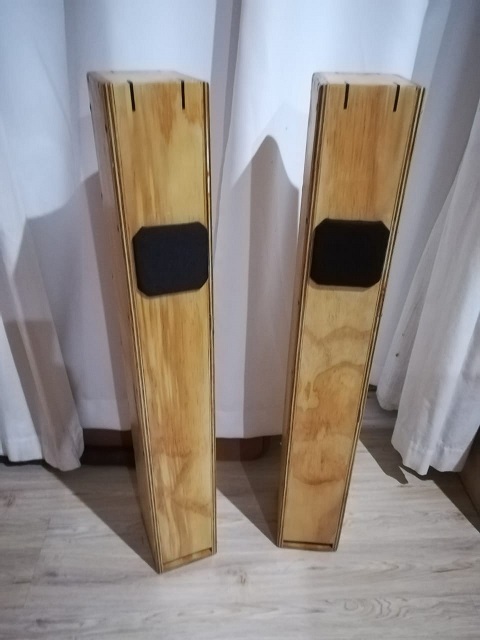

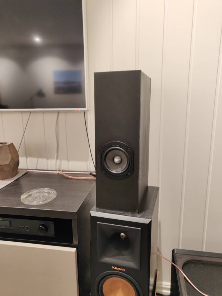

just want to say thanks to Bjorn for sharing the Tabaq and show my build of it.
I had some 12mm ply and 19mm MDF, so why not make a pair of Tabaqs.
The front and back is 12mm ply and the rest 19mm MDF. Upper half of the front
I used a router with a roundover bit. The speaker is a Tangband W3-315E and
stuffing 80g of polyester.
