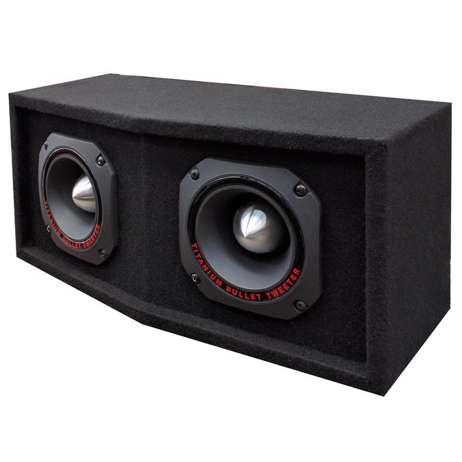

maybe I can still place it below the W5. Do you have any advice regarding a good inexpensive tweeter that would match well?
You need to buy a tweeter with a sealed back chamber.
If not, you will have to make a small chamber to seal it away from the line.
Sealed back chamber tweeters look like this:

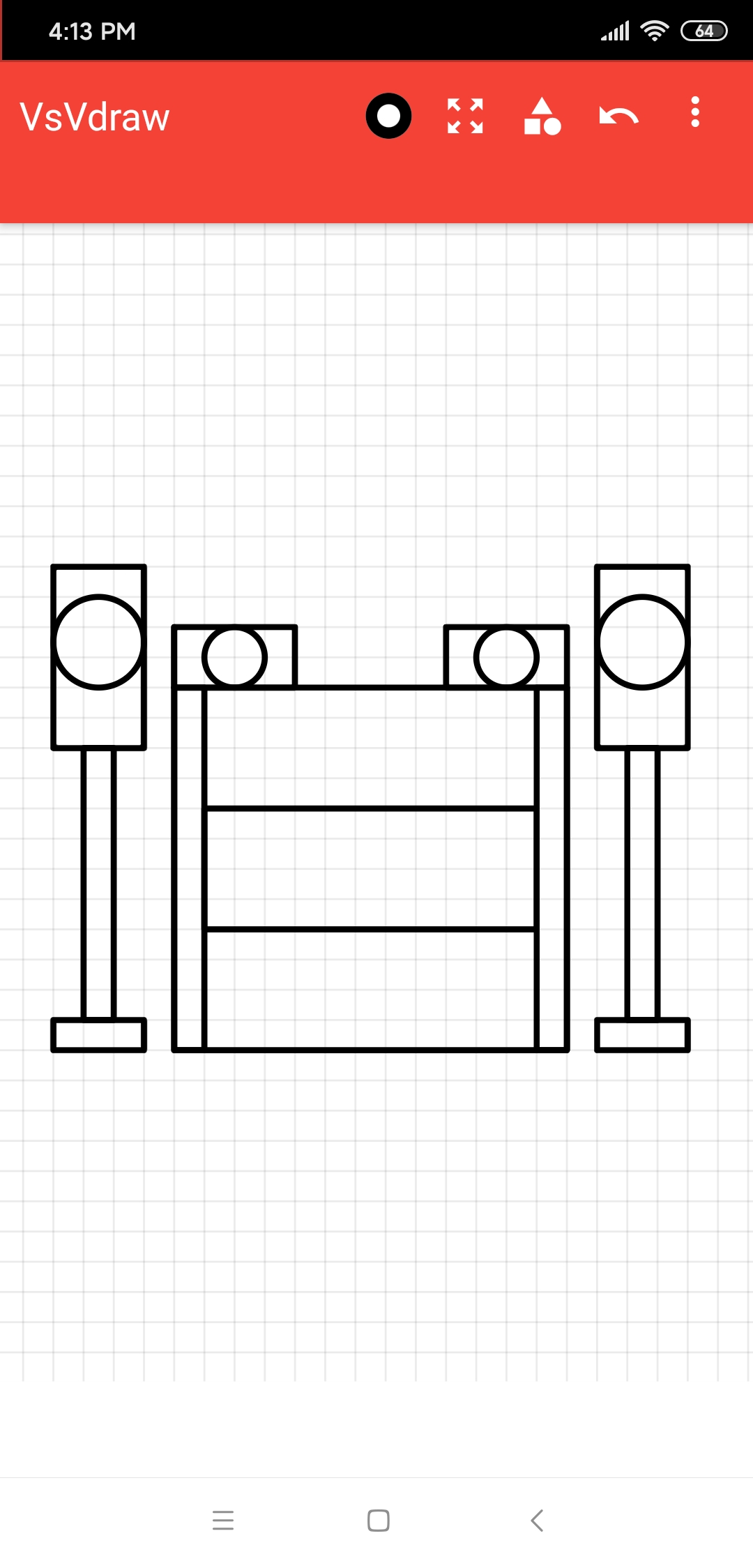

Due to my space constraints I can't install the tweeters on top of the speakers so I was thinking to create a long bar for both tweeters and the notches for the main speakers. Do you think it's a good idea or it's better to go with 2 separate enclosures?

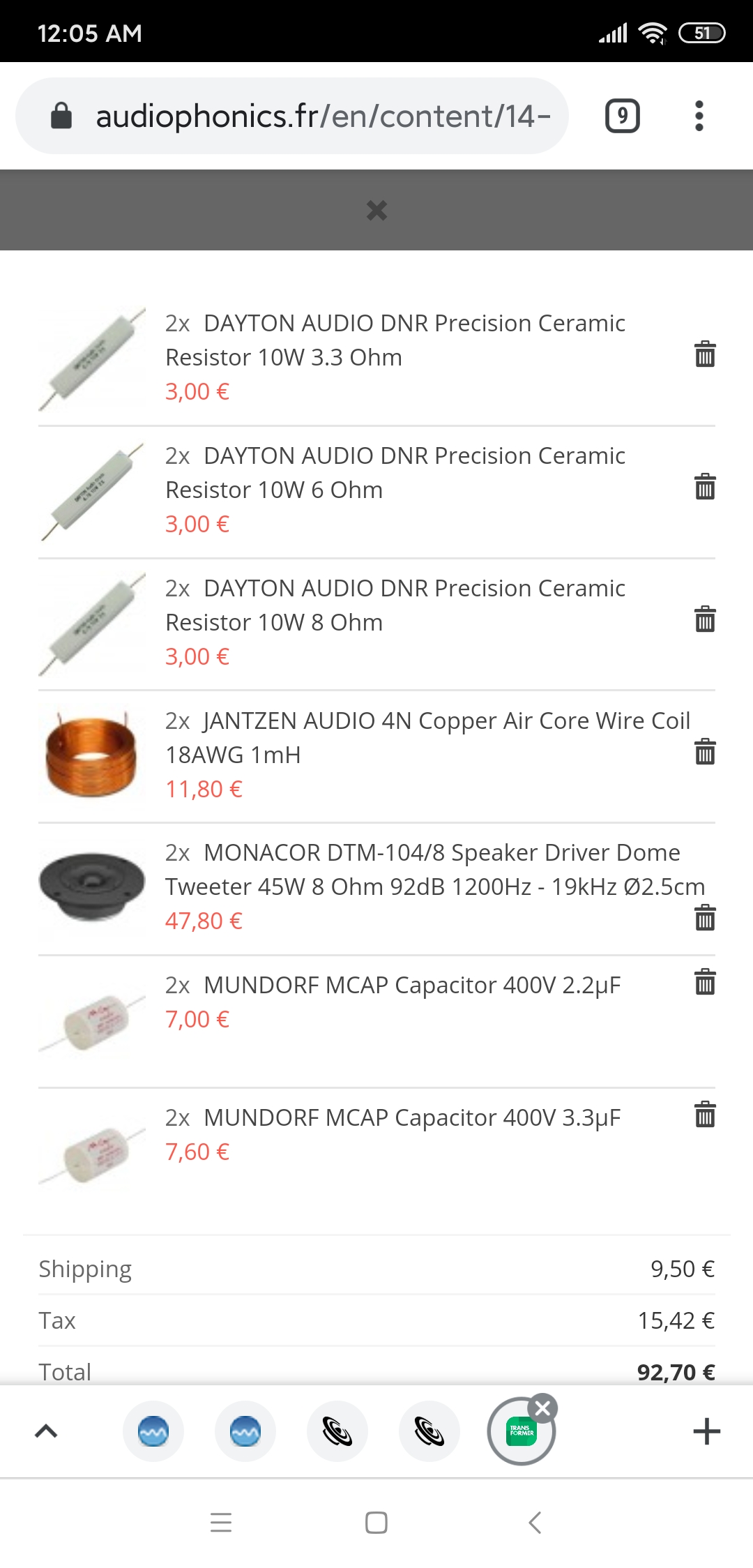

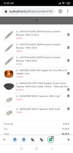

Care to comment about the item list attached before I buy?
Cheers
![cheers :cheers: :cheers:](https://files.diyaudio.com/forums/images/smilies/cheers.gif)
I'm not sure to understand how you want to use a bar for the tweeters.
Those tweeters have open back, so you will need to seal them by using a small enclosure for each.

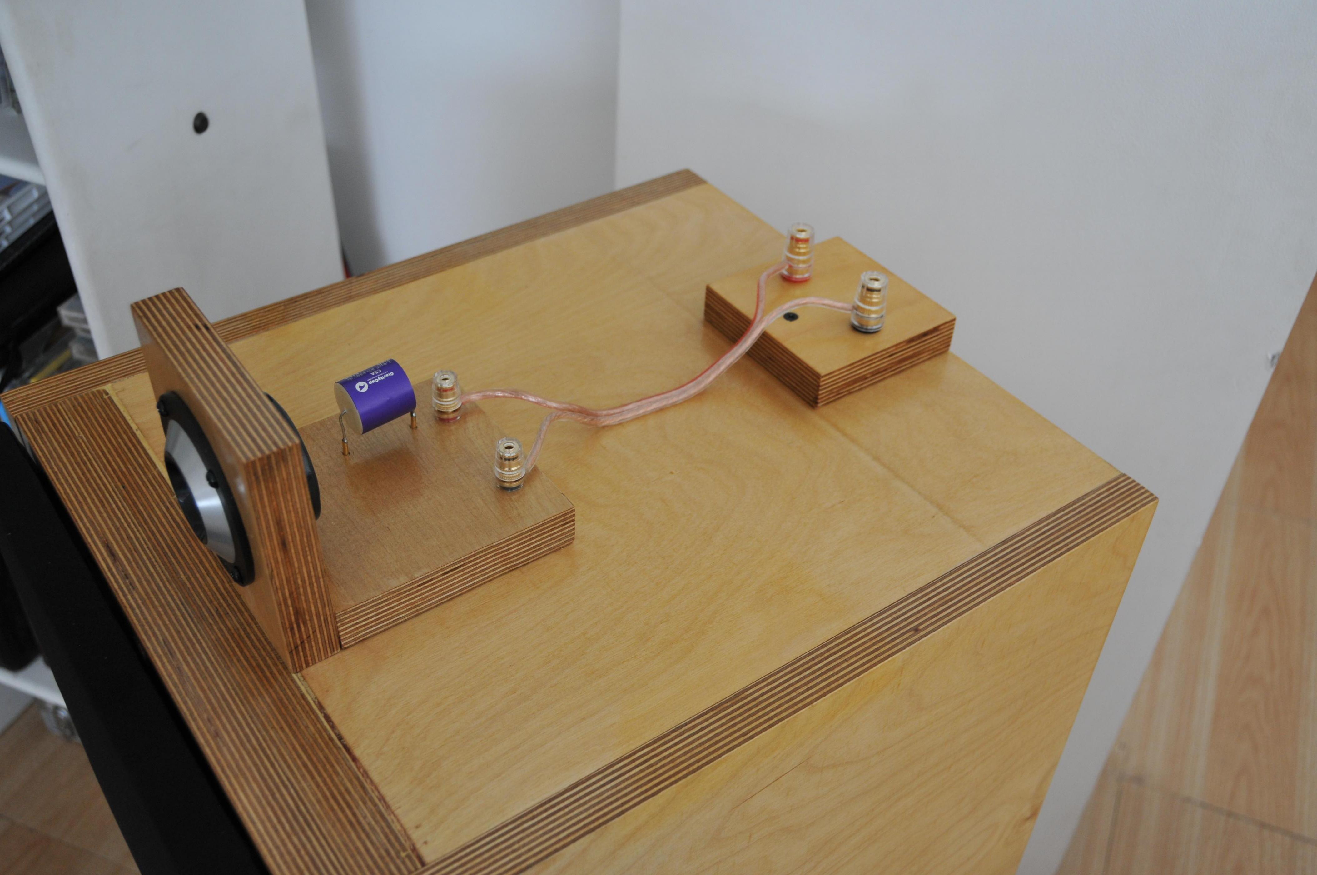

I mean something like the tweeter box attached, but smaller.
Do I have any size constraints if I build 2 separate enclosures?
Cheers![]()

My problem is that there are only a couple of cm on top of the speakers before the TV starts, so I can't put anything on them. The two speakers are separated by the hifi cabinet, so I was thinking to put a bar on top of it (or eventually 2 separated enclosures).

oh I see so really you do not have space, well in this case you do not have option still better do 2 separated enclosures....ciao

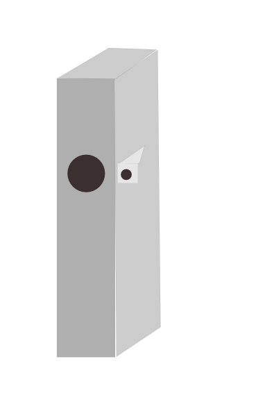

You could try to make a small triangle enclosure on the side to put the tweeter.

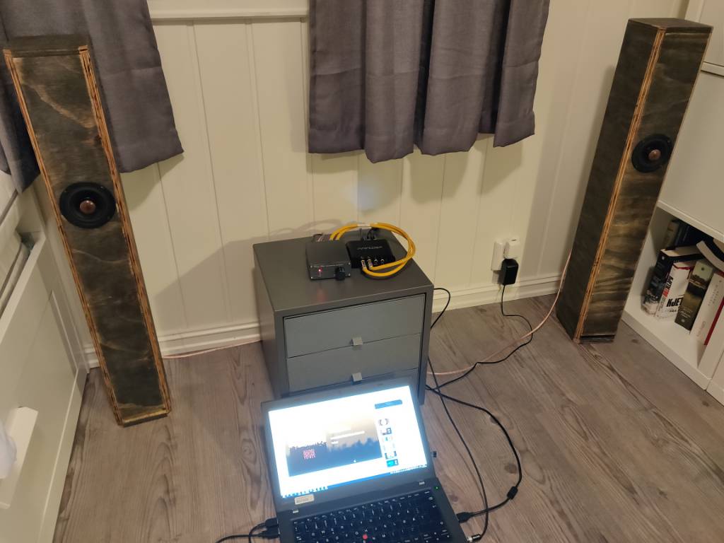

I'll keep the two boxes on the hifi cabinet, very near to each speaker (see picture). I'll use the same boxes for the BSC.

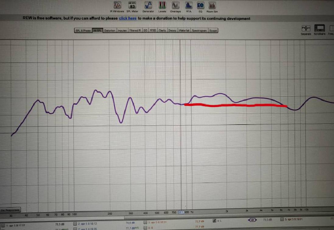

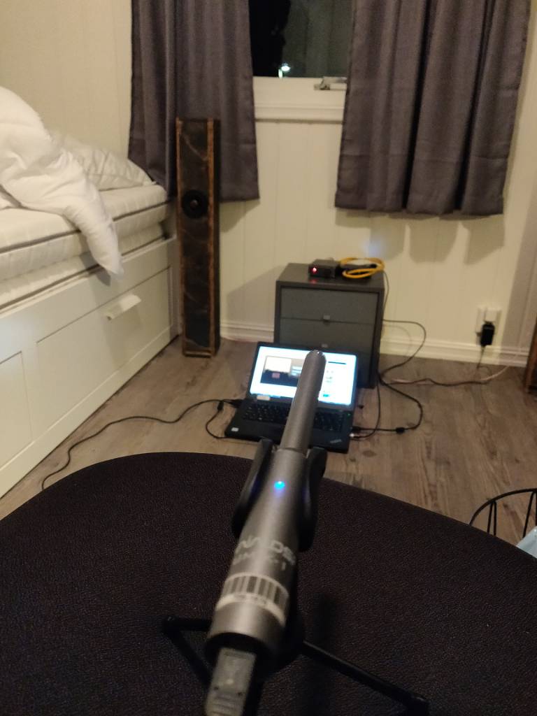

Since we don't have the left scale, it is hard to comment. Hopefully it is at 5dB increments.
Try to do a screen grab from your PC next time.
Is that REW graph before or after EQ?
I would lower that hump around 1 to 2kHz. Voices would be more natural that way.

I just install them on a thin plywood board, and hot blue it to the side of the enclosure, near the drivers.

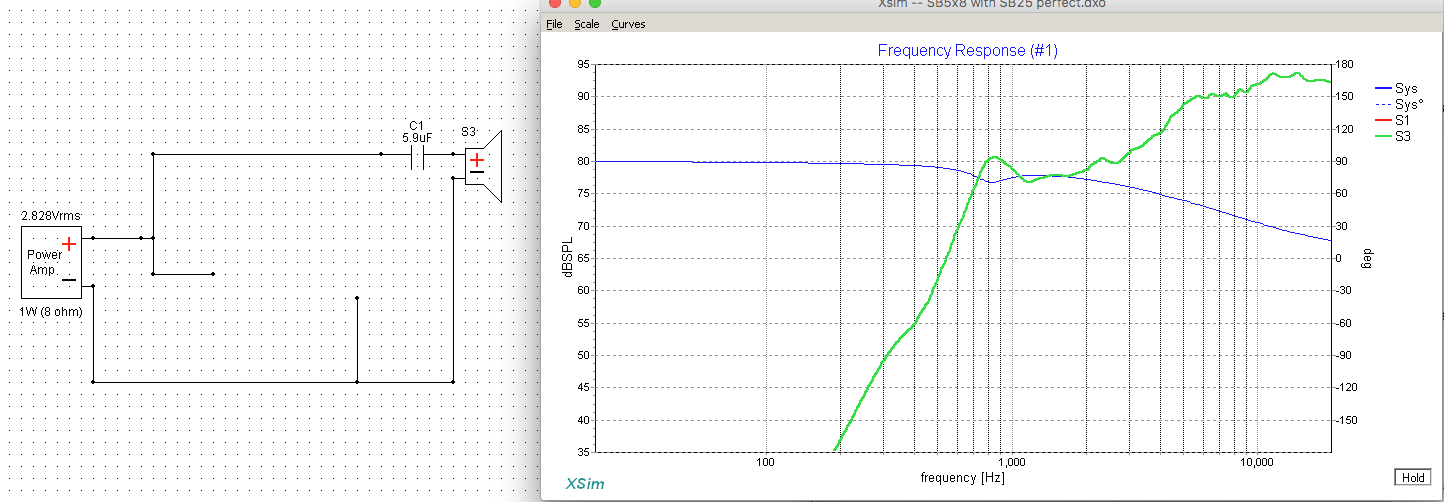

Adding a single cap is a 1st order pass filter, and will usually flip the phase around, as uneven numbered filters do.

can you please explain "Adding a single cap is a 1st order pass filter, and will usually flip the phase around" ? As far as I know 1st order filter hight pass or low pass doesn't change the phase, but of course I can be wrong....all the best
Well, it's not a complete and sudden switch.
It's a 90 degrees slow descent. 3rd order have a 180 switch.
In my case, to get a better meshing from my W5 FR and tweeter, I had to switch the polarity on the tweeter. If I kept them in phase, they had some trouble getting along.
I said "you may have to switch the polarity on the tweeter"... The changes would be subtle and hard to pick without a mic.
But with a simulation app like XSim, and a mic, you can predict and see in the real world the effect of switching the polarity on the tweeter.
