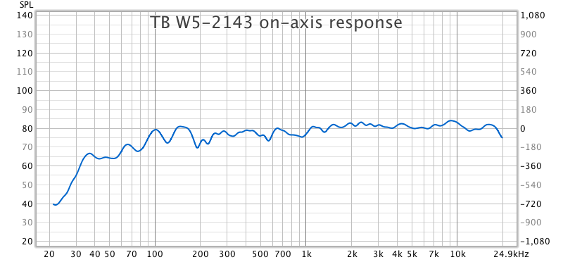

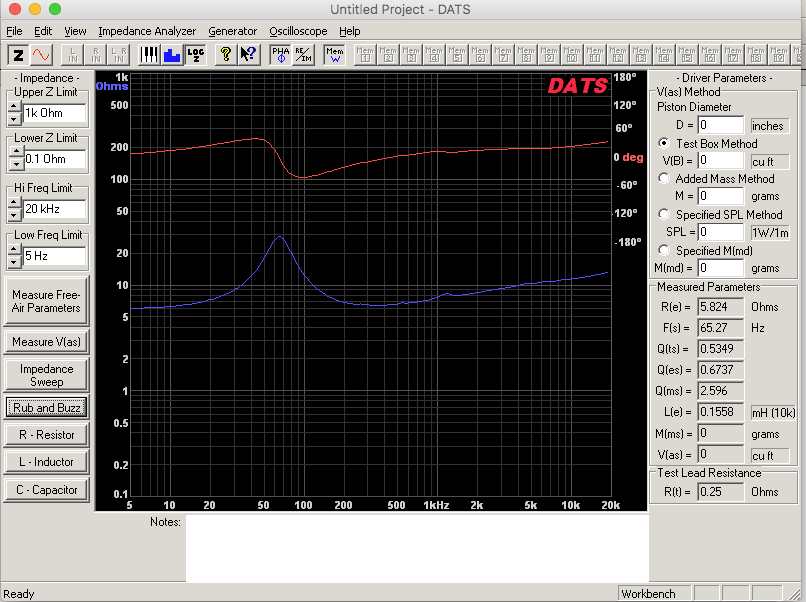

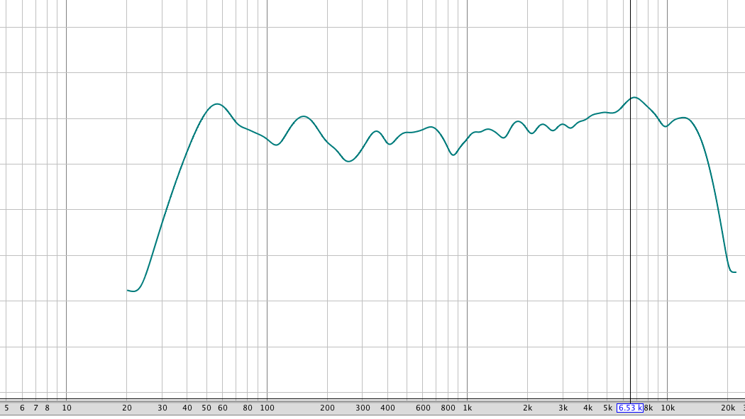

Here's the translation for the link above, and.I'm going to share the DATS readout and REW sweep as well (I opted for a narrow notch at 6.5kHz later on, instead of the usual BSC, so I could keep the reach up high as much as I could):

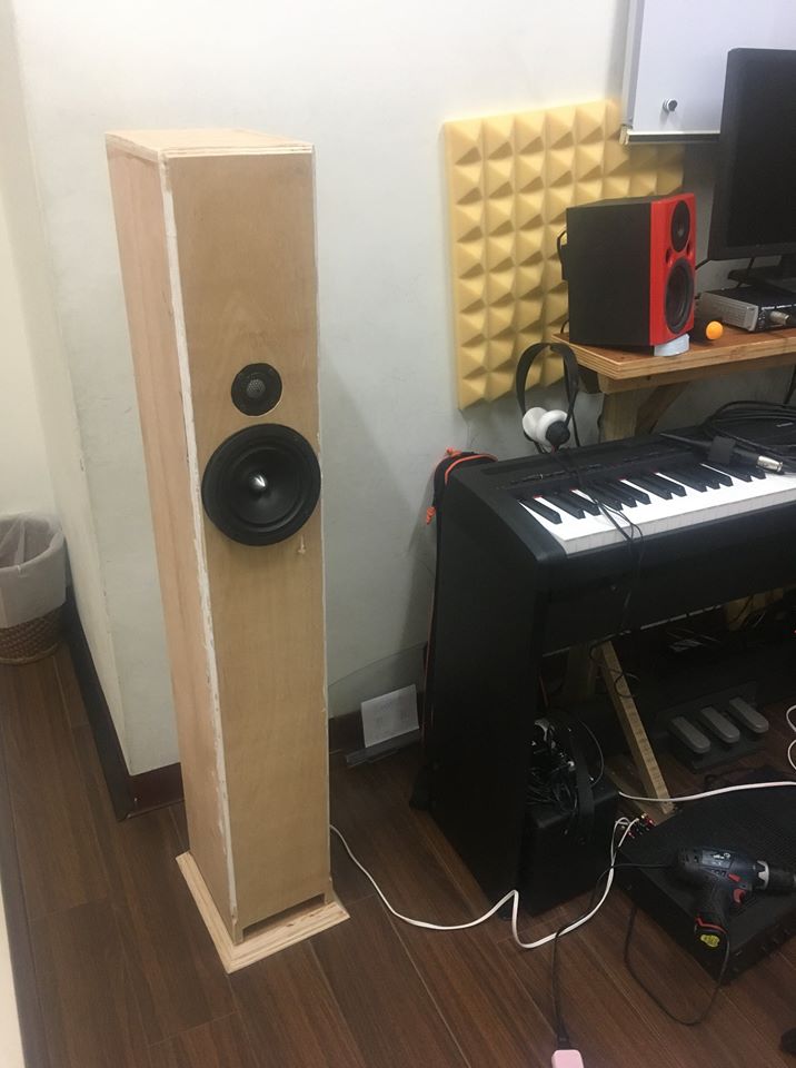

I had to fix the beaming with the w5-1611saf, which was just too much for my taste.
Added a closed chamber tweeter on top. Not really any volume lost inside the line, and now it sings.
Next will be to clean them up and paint them.
I have a Tron-like idea for them.

Woww that's a nice idea to use a small tweeter just on top of the main driver, but I really really really waiting to see the Tron paint design...

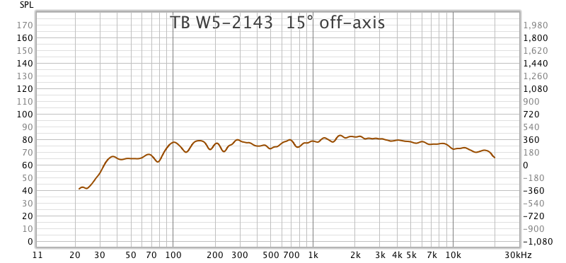

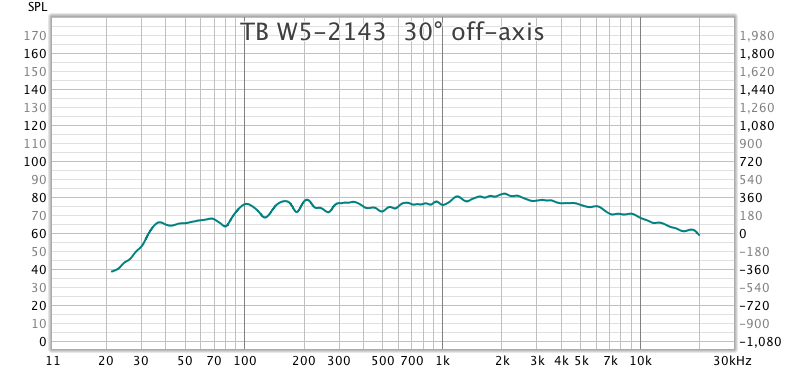

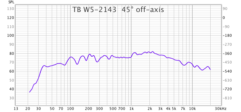

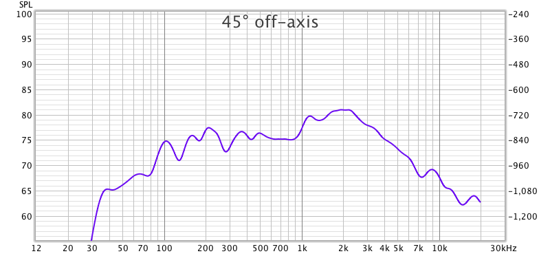

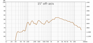

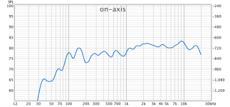

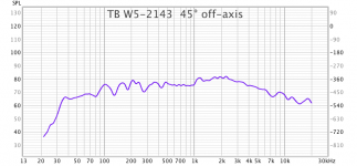

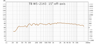

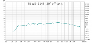

I have plenty off time due the Covid-19 lockdown so I set up for give a measurement to the W5-2143 beaming response.
I used REW with a Minidsp umik-1 calibrated mic and here the results.
All the best.....
All the best.....

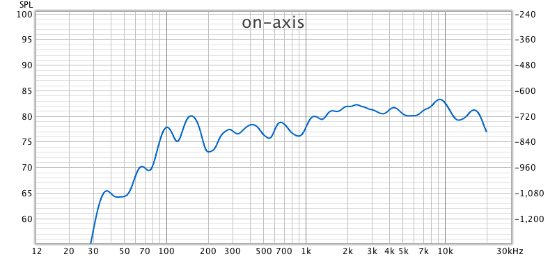

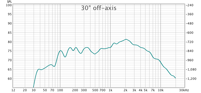

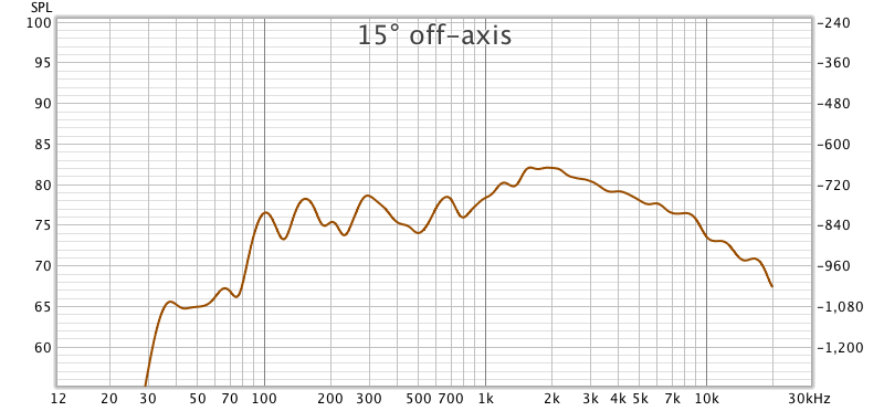

Your scale is huge for the dBs.
Narrow it down to 40 to 100 dBs to really see what's happening.
Because of the huge scale, everything is compressed and looks fairly flat.
That will change when looking at things a bit more closely.
I can tell you that I would put a notch from 1kHz to 5kHz.
You'll see it when you zoom in.

Thanks you are right, here with zoom.....all the best
