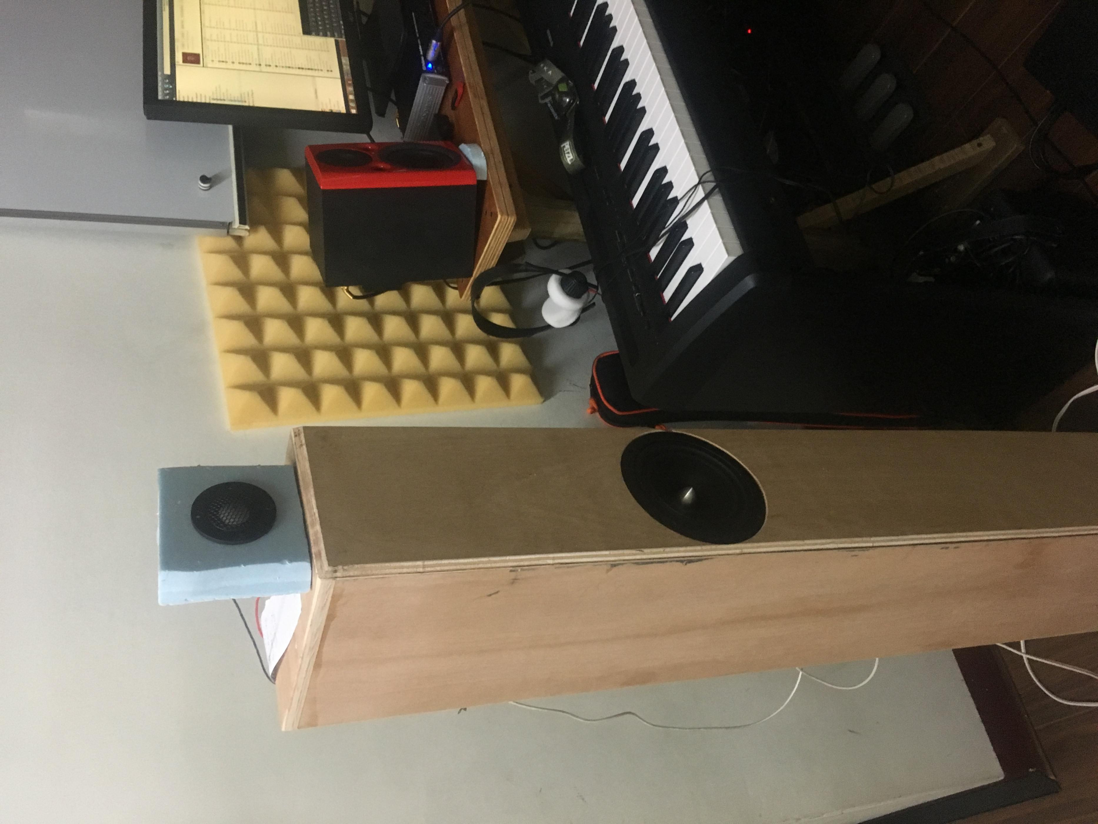

I build Tabaq with W5-2143, very nice driver but on-axis only, beaming problem is very noticeable so as you can see I solved the problem adding a tweeter on the top, now beaming problem is solved.....all the best
What type of crossover/filter are you using with the tweeter?

Just a 3.3 uF cap on the + line ......regards
That's the most used way to add a tweeter to a full ranger.

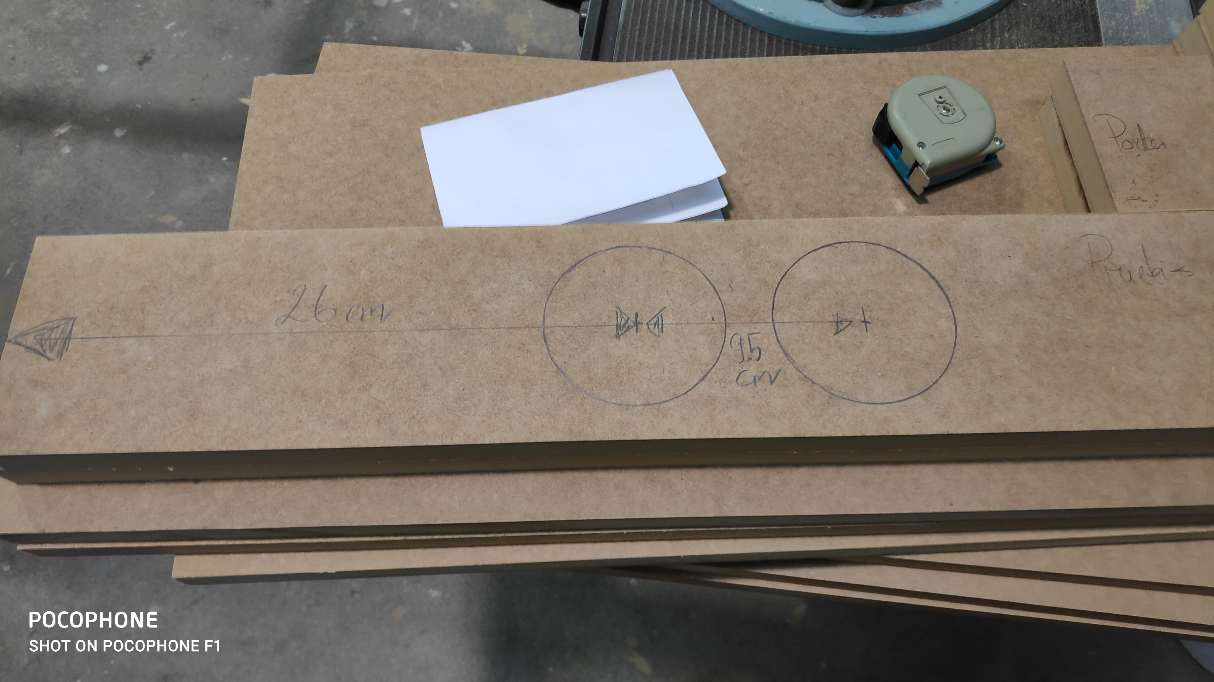

I'm making TABAQ with x2 Visaton FRS8M speakers, however I don't know how should I mount my speakers. In the original TABAQ speaker center is at 26 cm from the edge. Should I mount my x1 speaker at the 26 cm and another 35-36 cm from the edge or should I mount x1 front at 26 cm and another at the back at 26 cm? Which approach is the correct one?
Hi Entas,
the original Tabaq is for one driver only not two, where did you got that information? ....all the best
I know its for one driver. I wanna try two of them.
Well of course you can try anything but I guess your experiment will get a bad result, Tabaq is a TL for few candidate driver alone...good luck
